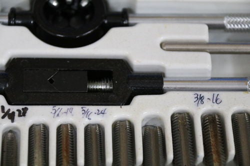

In the past I have occasionally used metal bolts in timber by cutting the timber thread using an appropriate tap from a low end tap and die set.
I labelled the oft used taps so I didn't have to think each time,
Then one day when I was trying to find that elusive imperial bit of hardware in our local dedicated fasteners retailer, I saw a set of taps and associated drill bits designed to handle our standard metric hardware and advertised as specifically suitable for woodworkers. Being a sceptic, I was mesmerised by the ad and even though I thoroughly quizzed the sales person, soon after I was heading back to my workshop to test my new thread making kit.
I used to use this as a demo of wooden threads to woodworking guests in my workshop,
I'm not going to say that after that I always used metal bolts in timber threads, but when I have used them, I was never disappointed. I am continually amazed at the amount of pressure that could be applied before the humble timber turned into fire wood.

.....120 YO? Bloody hell man you will not have any friends….
I don't have any friends now, so at least that wont worry me in the future!
..... Can you take a look at it and do a comparasion with your TWW ones please?
- robscastle
Interesting design. Looks like it pre-drills its own hole. That immediately raises alarms with me. If for no other reason, you need to drill a larger hole for hardwood than for softwood. To me it seems that the hole size will be restricted to the same size no matter what wood is used. Another shortcoming I can see is that both the drill and tap operation is done in the one step. I have in the past drilled the hole first and then flooded it with tung/burnishing oil before tapping. Lately if I want that added strength I apply some superglue after the drilling and before the tapping. I then re-soak it with CA and then give it another tap after it dries. In all fairness I haven't used that tap of yours so I'm only postulating and not in a comfortable position to comment further.
These are the two "type" of taps I used,
I use "type" as my tests were done using 10mm taps while pictured above are 8mm (same dimensions as yours).
With the TWW or any "standard" tap, you can decide on the size of the hole (within the acceptable tolerances) according to material type.
The good thing about standard (metal) taps is the diversity of materials it can handle, consequently it has to cater for the worst case scenario which is metal (to which it is configured)... and I'd rather have my head pummelled by a wooden baseball bat then a metal one… and people wonder why I'm dopey.
Now back to the TWW tap. It's thread specs are tighter than a metal tap, consequently it is a tighter fit. It has been designed specifically with wood in mind and the drill bit used is changed according to the timber's characteristics. For an 8mm tap, 5.5mm dia. hole for softwood and 7mm for extra hard wood are recommended. As you can appreciate, you have 4 drill bit options (5.5, 6 6.5 and 7) to play with according to your choice of timber (hell I should have been a salesman). There was a video on the net demonstrating the differences in resistance to lateral movement from a bolt using a standard tap and the TWW tap but I couldn't find it to post the link. However I can unashamedly confirm TWW's claim that the difference between the two is significant rather than just minor.
Another obvious bonus is that the TWW tap is 100mm long while the standard tap is 76mm (for the 8mm taps… other taps have varying sizes but the TWW is longer for all). This 33% extra depth capacity make blind hole tapping more versatile.
I think the bottom line is that standard taps are still usable, however, if you are convinced that metal bolts with widen threads is viable and you need to purchase a/some taps or prefer that added snuggness, the TWW would be a better choice (but at a few shekels more).

After a few button presses, the drill was configured to do some tapping (if only it could do the same with beer).
While the speed is displayed as 900rpm, for tapping it was automatically reduced to 100rpm (what a bonus).
Now let's digress from the digression and waddle back to the story. I loaded each of the two 10mm taps and drilled the recommended holes.
Scurrying for a couple of 10mm bolts I was fortunate to find some as I would have had to tackle a couple of 12mm bolts with my die (and I didn't want to die today… never thought about tapping 12mm holes… DOH!).
After threading the two bolts, I tried the wobble test… I passed it with flying colours as I hadn't had a drink all afternoon, however, the original tap exhibited a slight wobble while the new tap was virtually immovable. Now I will reflect that I have not had any issues with the old threads as once the bolt was cranked up, all play was taken out. The TWW taps were designed with greater tolerances and to give you an indication, the old tap's specs recommended an 8.5mm hole while the new one's was suggested at 7.5mm. Overall the TWW threads were much tighter providing a more secure fit. As screwing progressed (hmm.. do you screw a bolt as you don't bolt a screw… preferably, unless your old… I digress if you hadn't noticed), I had to resort to using a spanner much earlier than the "original" tap.
Now not everyone taken in by my silken salesmanship will purchase the taps and then go out and spend $2,400 on a tap assisting NOVA drill press. Well for all you skinflints the TWW taps are just as much at home with the use of a drill (cordless, or for you senior seniors, a corded one) though variable speed is recommended.
When using the hand held drill, the lead in may not be exactly 90° but as you progress even just slightly in, it aligns with the pre drilled hole and creates as tight a fit as with the NOVA. The taps can be used in a drill with either a variable or hex chuck.
The new set is now ready to be bolted to the wall,
You may all wonder what was that lonely first picture doing… Well he's part of the following conspiracy in presenting my acid test to all you skeptics out there… you know who you are!
Drilled a hole in a piece of pine and tapped it with a 10mm bit,
Remember the first picture? OK, here it is again in case the grey matter is having a sabbatical,
Decided to attack it with an 8mm allen key from the safety of my mini vice,
After a significant amount of torque and fear of risking another hernia, I eased up on the bolt,
You may have noticed that the head "countersunk" a good 5mm+ into the pine without affecting the integrity of the thread.
You may say it's only pine… "It's only pine!" That is why I managed to countersink, hardwood would (pardon the stutter) provide greater grip and countersinking resistance.
What does all this mean? Anyone wants a set of metric taps with complimentary drill bits. I paid $90 for the set and am prepared to relinquish it to a friendly home for maybe a donation of a cask of vino (locally).
For all those not interested in this topic, please go back and re-read the 1st paragraph and don't bother to read the rest.
PS. If you all stay good Boys and Girls and eat all your greens, I may post a review about wooden threads. Some may scream NO MORE and by pure mathematics, the remainder didn't, but you'll all have nightmares wondering if and when.
Thanks LBD I will bumble on and see if I can produce a better result, as you say there is not too much difference in the taps more the process, so I will see if I have a tap without the drill snozzle.
