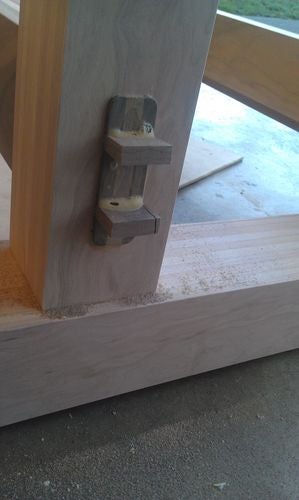

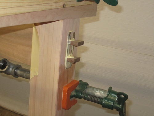

Time to glue up. Since I painstakingly fit each tenon to it's matching mortise, I was fairly confident that glue-up would go ok. To solve the short clamp issue, I went down to the hardware store & got some couplers to hook pipes together to get more length out of my pipe clamps. Also, I borrowed some longer parallel clamps from a friend - and I'm glad he had them!
I did a dry assembly & everything worked great.
It was a little tricky to do by myself, but I got it together without too much trouble.
Although a couple of videos I watched had suggested gluing up the base in stages, I decided to just go for it. I have some Titebond extended open time glue which gave me a little more time. Some coaxing with a mallet, squaring up with the clamps & it was done. It was a complicated glue-up (for me), so I dry assembled it a couple of times, and had clamps & wedges in place before I put a drop of glue on it.
Close-up of wedges:
I let it dry for a couple of days & went after the through tenons to get them cleaned up.
Please do not look too closely at the joints between the top member & the leg…..I still need to work on getting shoulder cuts perfect. But, I was pretty happy with the fit of the wedged through tenons after it was all said & done.
Time to sand it up (a LOT of sanding). After sanding the whole thing, I put 5 coats of wiping varnish (1/3 each BLO, Spar Varnish, and Mineral Spirits), and 2 coats of Armor Seal. It was the first time I used General Finishes Armor Seal, and I really like it. Easy to wipe on, and ended up with a nice smooth finish. Very happy with it.
It turned out flat, square, and unbelievably stout. This thing is a tank - very heavy. I had my benchtop temporarily on a flimsy rolling cart thing that I built years ago, and now it is temporarily on my trestle base. I am now very anxious to get the top done. Time to figure out what to use for the skirts & vise jaws. They need to be 1 1/2" thick, at least, and 6" wide, at least. Back to the pile of Black Walnut & to the store for another gallon of glue! Thanks for looking & I hope to have more soon.

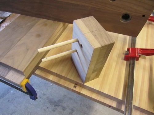

So, the top needed skirts, obviously, so time to laminate again. This time, I used 3 pieces of 1Ă—8 black walnut. This gave me a skirt that is 2 1/4" thick, and 6 3/4" wide - after cleaning up the edges. I glued up enough blanks for the front skirt, two end skirts, and chops for both vises.
I did not get very many pictures of this process, as I had plenty of lamination pics earlier….
I will say that these skirts were BEEFY! And heavy.
So, now I had to figure out the joinery on the end skirts to the front skirt. I am not proficient on dovetailing (and I was freaked out about the possibility of ruining the skirts), so I just planned on joining them with a tongue and groove. But first, I needed to think about the vises. I had a twin screw Veritas for the end, and a Lee Valley single screw for the face. I simply followed the instructions to the tee & drilled all of the necessary holes for the front vise.
I flipped the top over and installed the vise carriage per the instructions. I had to put a spacer under the carriage to achieve the depth I wanted. Worked out great.
Time for the end vise. I'll spare you the details, as the subject of installing this twin screw vise have been covered a million times here. However, I will confirm the importance of following the instructions to the tee. Read them carefully, pay attention, and don't get ahead of yourself.
I routed the back of the end skirt to accept the vise nuts, and routed a channel in the bottom of the benchtop, which I (for some reason) assumed I would need to make the screws clear the bottom of the benchtop. I was wrong, but it was too late.
Drilled the holes for the screws, the barrel bolts, and the guide pins. All in all, it went well.
Regarding attaching the end skirts to the top. The Veritas twin screw came with 4 barrel bolts. I decided to use two on each end skirt. I drilled the holes right through the "tongue" that mated with the slots in the skirts. I drilled the holes in the skirts on the drill press first, set them temporarily on the benchtop, and drilled the holes through the tongue, into the top & hoped everything was square. Now, how to drill the hole in the bottom of the bench for the barrel nut & have it land in the right spot. Per the instructions that came with the Twin Screw, I build a little jig. Worked VERY well.
Tested the fit of the face vise - worked perfectly first time (beginner's luck)
Played around (a lot) with the twin screws and got ready to glue the skirts to the top…
