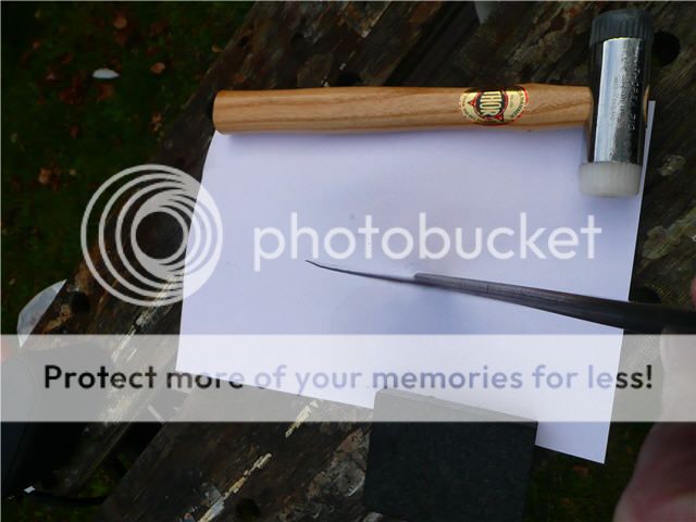

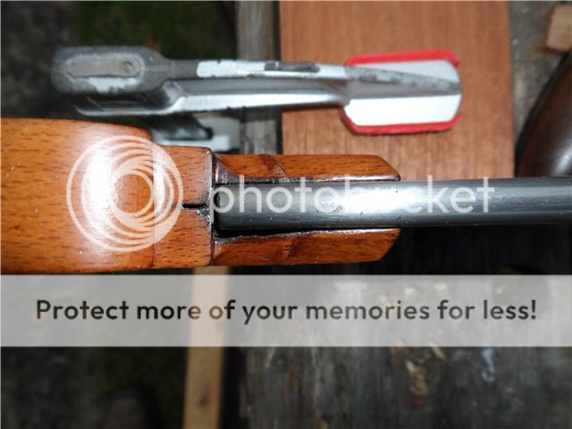

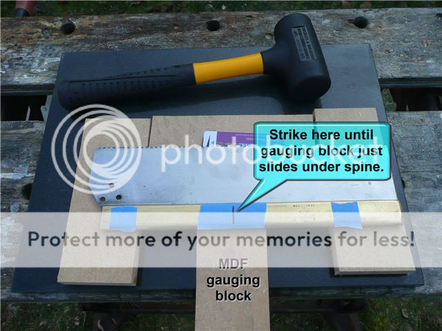

There was an issue with the saw plate on this particular saw that is worth mentioning. It was difficult to photograph, but when I sighted down the tooth line from one end, the teeth weren't in a straight line. Instead they bent round in a slight arc from end to end. I tried to show it in the following photo, but it isn't very clear I'm afraid.
This is not uncommon in old backsaws. When I researched it, I found that it occurs because the saw plate has somehow slipped slightly at one end of the saw's back or spine. It doesn't need to slip much to cause this effect and often you can't see any witness line to show that the saw plate has shifted. Luckily though, it's a really simple fix and here's how you do it. Clamp the end opposite the handle in a vise as shown below.
Tap the saw back with a mallet. It doesn't take much so don't overdo it.
Remove the saw from the vise after each tap and check your progress. If the tooth line still isn't straight, put it back in the vise and hit it slightly harder in the same place, then check it again. Mine straightened up after the third tap.
CAUTION: Please don't tap the handle end of the saw's back. If you do, you might have difficulty refitting the handle as the bolt holes in the saw plate will have shifted relative to the holes in the handle.
I have read that an alternative way of removing a wave from the tooth line is to hold the saw plate with the teeth uppermost and the handle end towards you, then tap the toe end of the saw back on your workbench. I haven't tried this method, but it sounds feasible.

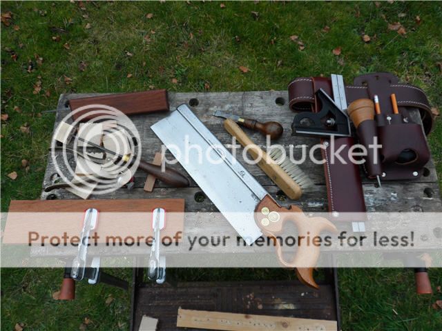

So here is the saw after restoration.
There was a fair bit of pitting on this saw, but it isn't bad enough to affect how the saw performs. I like a shiny saw plate on my backsaws, at least enough to see the reflection of the wood I'm cutting. However, it's worth pointing out something with regard to shining a saw plate on an old saw. Most of the old saws that I've seen have some pitting. It is impossible to sand out all of the pitting without significantly altering the thickness of the saw plate. If you aren't bothered about the saw plate being shiny, it is better to stop sanding at P400. That way the pitting will be less obvious than if you continue sanding up to P1200 or P1500 like I did here.
I'm really glad I bought these saws, because although I didn't know it at the time, both of these totes fit my hand perfectly. I know everyone's hands are different, but I consider myself really lucky to have stumbled upon a handle design that could have been modeled around my hands. When I grip them they fill my hand nicely, neither too big or too small and the horns seem to wrap around my fist enabling me to support the weight of the saws effortlessly. The bump on the back of the grip nestles in my palm and my fingers don't feel the least bit cramped. God bless the saw handle makers of old. They knew what they were doing back then.
So here are the two saws together. I think they make a nice pair if I do say so myself.

To find the ideal position for the bench rests, I mounted one of the jaws in the Workmate, grabbed the magnifying glass I'll be using and a saw file and moved the jaw up and down until it was at the most comfortable height for filing. Then I put the bench rest against the jaw and drew a line to mark the position. I only screwed them on in case I want to alter the height at a later date.
With the bolts in their holes to ensure the two halves were aligned correctly I put the two halves together to mark out for the hinge screws. I inserted four hotel card keys stacked together between the bottom spacers. Since this is 2-3 times the thickness of a saw plate, it will help ensure that the clamping pressure is focused at the top edges of the top spacers.
With the hinge taped in place, I pricked the position of the holes with my awl, drilled the pilot holes, waxed the little brass screws and gingerly hand-tightened them.
I cut the bolts to the correct length and de-burred them.
I didn't want to leave the threads exposed in between the jaws in case they scratched the shiny brass spines on my backsaws, so I cut some pieces of garden hose to fit over the thread. By the way, has anyone seen that fourth star knob? I know I bought four, but where it is now is anyone's guess. I bet it's those damn squirrels again!
When I cut out the jaws, I allowed quite a bit of height because I didn't know whether I'd prefer the vise up high, low down, or somewhere in between. Now I had my bench rests positioned where I wanted them, I was left with a surplus of MDF between the bottom of the bench rests and the hinge. Well I couldn't live with that, so I measured down 5" and cut the rest of the MDF off. Of course I should have measured for the bench rest height when I first cut the MDF out shouldn't I? "Yes Andy", they shouted in unison. Still, I've heard that it is OK to make mistakes as long as you learn from them. Well I learnt that without even trying, I can be a prize plonker. :)
Anyhow, I split off the MDF from the bottom spacers with a chisel, cleaned up the glued face and re-attached them. So, it now looks like this. Much better don't you think?
I had just enough daylight left to increase the bevels at the tops of the jaws, so I grabbed my electric scrub plane as I call it and went for it. I've never planed MDF before, but it worked out well.
A couple of passes with my Stanley 607 along the tops of the jaws and a few swipes with my block plane on the faces of the jaws brought them into perfect alignment. All of a sudden, or so it seemed, the saw vise itself was finished. I still had a bit of the 44mm Sapele left, so I added a little holder for my saw file.
I drew out the shape on the wood.
Drilled and countersunk the hole for the file.
Cut off the corners with my crosscut saw…
…and rounded the end with my rasp and file.
Cut out the rebate with my rip saw and shaped the other end.
I will be putting two or three coats of water-based acrylic varnish on it before I post it in my projects, but until then here's some shots of the saw vise set up for a variety of saws. Fine woodworking it ain't, but it works brilliantly and clamps very tightly.

12" W. Tyzack, Sons & Turner Carcase Saw - Fitting a folded back
Have you missed me? Sorry for leaving you hanging for so long, but work was a bit manic leading up to Christmas. Now where was I? Oh yeah, I was just about to sharpen the last of my crosscut backsaws, a 12" carcase saw made by W. Tyzack, Sons & Turner.
I restored this saw in part 1 of this blog series. It had a number of issues and honestly, it still has a few of them.
1) The plate was heavily pitted in places.
2) The plate had a wave in it.
3) The spine was bent.
4) It was missing a split-nut.
5) The screws were bent and very little of the thread remains.
6) The spine doesn't fit the handle very well.
The above problems mean that this will never be a pretty saw, but I didn't have the heart to just throw it in the bin. As part of restoring this saw, I straightened out the wave in the plate, or so I thought. However, when I came to sharpen it today, I noticed that the wave had returned. Bummer! On closer examination, I found that the spine was also slightly bent. As I've said before, there's no point in sharpening a saw with a wave or a bent back, you have to fix those problems first, starting with straightening the spine.
When I straightened the back of my S&J Carcase saw in part 4, I used the following method where I sighted along the underside of the back and placed my finger on the convex side where it was bent the most. I marked that point with a bit of masking tape so I knew where to direct my mallet blow.
This time I placed my combination square on the convex side of the plate and rocked the straight edge until the gap was equal at either end. I could then see that the fulcrum point was so many inches from one end and that's where I needed to hit it. If the spine is stamped with the maker's name, you can sometimes use the lettering to remember where the fulcrum point is. (E.g. Hit the 'T' of the word Tyzack.) Then I placed the back on the blocks and hit it with my deadblow mallet. You need to sneak up on the right amount of force and check it frequently with the straight edge until it no longer rocks. One point worth mentioning is that steel backs take a lot more force than brass backs.
Once the spine was straight, I sighted along the toothline. Although much improved, it still wasn't straight enough. Usually you can hold the saw as shown below and rap the toe end of the back on your bench to straighten out a wave.
I managed to improve it a bit, but I couldn't get it perfect using this method. This gave me the opportunity to try something new and that was to remove the spine and refit it. The act of refitting a plate in a spine has the effect of re-tensioning the plate. These days many makers use slotted backs on their saws where the slot is machined to the thickness of the plate. Some makers even glue or pin the plate in the spine. However a folded back is different. In order for the two sides of the spine to grip the plate the spine has to be sprung. This means that when you remove the plate from the spine, the sides close up.
I think there are pros and cons for both types of backs, but for me a folded back is preferable, as it allows you to adjust the tension and also to easily replace the plate should it get irreversibly damaged.
Anyhow, I gripped the plate in the vise and used a block of hardwood and a mallet to knock off the spine. It was a BITCH to get off let me tell you, but I got there in the end.
After cleaning the plate and spine, it was time for re-fitting. I used the method kindly documented in the following four videos by Tools For Working Wood. Notice how the saw maker positions the plate and spine to get it started and how he then turns the whole assembly over and bashes the teeth (yes the teeth) with a softwood bat shaped a bit like a little cricket bat. In the last video he adjusts the position of the plate relative to the spine so that the assembly will fit into the handle correctly and the holes in the plate will line up with the holes in the handle. Enjoy.
I watched these videos a few times before I plucked up the courage to try it for myself. I'm pleased to report that it was far easier than I thought it was going to be and the plate went straight back into the spine first time. Adjusting it was a bit more tricky than it appears in the videos because the Gramercy saw in the demonstration has a nice notch in the plate that comes to rest on the metal block in his vise. Old saw plates didn't have that feature (at least none of mine do), so I had to keep tapping and offering it up to the handle to know when the alignment was correct.
The good news was that the wave had now gone and the back was still straight. HOORAH! Now I could do what I set out to do when I got up this morning and that was to sharpen the damn thing. Don't you just love these little distractions?
After filing off all the old teeth, I retoothed it by hand to 12TPI and sharpened it with 15 degrees of rake and 25 degrees of fleam. This will be great for making crosscuts in softwood. So here she is folks. She isn't pretty, but she cuts beautifully.
You know when I had almost finished sharpening her I had to smile, because although I haven't sharpened a saw since I last posted here (145 days ago), I hadn't forgotten either the process, the technique or the feel. And that my friends, is exactly the place I hoped I'd get to when I started this journey last year.

I'll leave you with some photos of the saws that taught me about backsaws. When I bought them, they all had their own issues caused by years of neglect, improper storage and/or use, but today they all cut beautifully (except for the leftmost saw in the last photo which is a 10" dovetail saw made by C. Garlick & Sons. I only got that one a couple of days ago and haven't touched it yet).
So has restoring and learning to sharpen all these saws been worth it? Hell yeah! I wouldn't have missed it for anything and I'd recommend it to anyone. I will be using and building on these skills for as long as I'm able to work wood. Saws no longer intimidate me.
