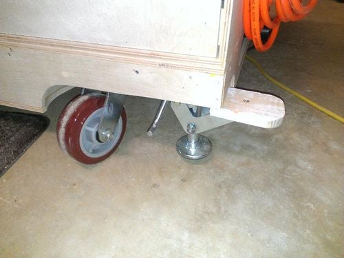

What about a solid mounted caster with something like one of these
#13 ·
Design
I've been thinking about this for a while. I'm a contract engineer so we have to move every few years. My shop is usually one side of a two car garage with makeshift shelves. I sometimes add some cheap cabinets but end up leaving them when we move. A good dust collection system is out of the questions so I usually do a lot of my work in the driveway. This means carry saw horses and plywood for makeshift benches and wheeling tools on rollers in and out. There are many trips back and forth for hand tools and supplies.
So here's my proposal. One big rolling workstation that combines the table saw, router, work surface, drawers, cabinets, and a place to set up other tools like the miter saw or maybe a planer. With everything on one platform, there is little time spent running back and forth - all tools normally needed are handy. The design is modular so it can be disassembled for moving or modifications. The bottom platform and the work surface are torsion boxes.
Of course there are drawbacks. It's heavy - 1200 to 1400 lbs. It needs a fairly level driveway - not that common.
What do you think? Is this a good idea or a hare-brained scheme? You can download the Sketchup model from the Sketchup Warehouse.
KevinJeffery,
Thanks for the Floor Lock idea. Four of those will work great. And I found a set of four for around $70 that should do the trick.

So last night I ordered the caster and floor locks. 6" 900 lb polyurethane casters from SES Caster Co. on Ebay (model # CR51R06SX0X.PPXMGRX) for about $13.00 each plus shipping:
And a "set of four 7-1/2 Albion LF Series floor locks from Amazon for $57.00 :
Next is updating the design for these items then actually starting on the bottom platform.

Then the casters and floor locks were added. Later I added a 1/2" pad under the casters to give the floor locks more clearance on the uneven driveway. I simply place a 1/2" pad on the concrete when I use the stops to support the workbench.
The completed rolling platform:
Next, the cabinets.

The foot pads on the floor locks were too small to comfortably lift the table so I clipped on some larger plywood footpads. Here they are in the up and down positions. Note that I place a piece of 1/2" plywood under them for the proper height. This compensates for the 1/2" shims I added under the casters to provide more clearance for the floor locks due to the uneven concrete in my driveway.

Mobility - On the big 6" swivel casters, the table moves with a solid push on the smooth garage floor. It has some heft (I estimate 800 - 1000 lbs) so most tasks don't require the floor locks. It sometimes takes a push crosswise to get the casters to swivel in the right direction. It works well in the driveway but takes a bit more effort due to the slight slope, dip and twist in the concrete. The torsion box frame is rigid enough that I have to shift it around to find the right location to keep the table from rocking.
Floor locks - The floor locks individually seem to have a little play in them but when they're all engaged the table is rock solid. To get enough clearance for the uneven driveway, I had to raise the table by putting 1/2" plywood under the casters. I keep four pieces of 1/2" to put under the floor locks when i actuate them. I also had to extend the foot pad on the floor locks to make it easier to actuate them (lifting the table in the process).
