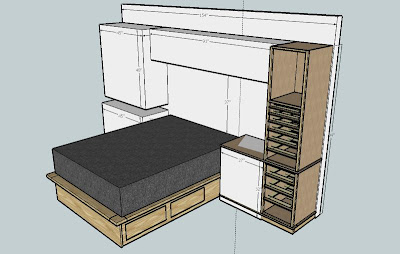

DrawerBase Design
Sketchup File
I would like some critique on my design so far. This is going to be the base unit of my cabinet design for an entire wall unit. My initial design goal with this is just to get the drawer height set and comfortable with that. I have tried to add the faceframe elements, but am having trouble deciding on a method to attack that. I am probably over thinking it.
This is the initial unit layout for the Wall. Like I said above I am working on the base units for now, which will house drawers. The top units will probably have shelves, but could have more drawers…The center square is the bed
Please let me know what you think, and those who are able please feel free to comment or give me some pointers of my Sketchup model.
#2 ·
model looks good- one thing - it seems you have a different component for each of the drawer dividers? why not use the same component and make copies of it? (you do have copies on the left and right -but the bottom and top dividers are different components).
another personal preference of mine is in regard to the height of the bed- my workbench is ~34" and I wouldn't want to sleep that hight ;)
actually my previous bed was ~30" high , and had storage pullout shelves underneath - I never really cared much for it and replaced it with a new bed which is ~13" off the floor (top of mattress) which is much more inviting.
#3 ·
yea, I guesstimated the height of the bed, ours right now is kind of high its got that whole 18 inch european mattress thing going on…Once I remember to take a tape measure to bed with me(did I really just say that?) ill get the right measurement for the bed height…
Actually the drawer dividers are copies, but the rails and stiles are also separated components, it works out ok for cutlist…
thanks purplev
#4 ·
It is not possible to provide a full design critique for a project that is in such an early stage of development. So instead I offer the following design questions for your consideration:
Is the back panel that projects above the various parts suppose to act as a datum for the rest of the unit and if so should it also project beyond the sides? Also, why does it have a thickness beyond a 3/4" material thickness?
With bed set at the same height as the lower parts of the wall unit, how will the bedding and the base of the bed work with the rest of the design?
As currently massed the whole unit reads as twin units flanking a bed with a 'bridge' sandwiched between the twins. Is this the reading you desire? There are other massings that could be used. For example one alternate could have the 'bridge' spanning the entire distance across the unit. Another could be a 'post and beam' where the 'bridge' is extended so that it is wider than the bed and rests on a ledge in each of twin units.
Is the height between the top of the bed and the bottom of the 'bridge' enough to allow someone to sit up in bed? Does the height and the projection of the 'bridge' pose any head clearance problems when getting in and out of bed?
Is lighting to be integrated into the design?
Where does things like the alarm clock go and will you be able to see it (and hit the snooze button) without having to actually move?
Good luck as you move forward with the project.
#5 ·
I am assuming you mean on the overall plan and not the individual cabinet plan. That is the bedroom wall.
I have to actually take a tape measure to the bed and ge the actual dimensions, I was going of the measurements for a queen mattress, and my man sense for what the height was….(you know things are bigger or longer than they really are)
Again I have to do some serious measurement there. My reason for posting so early is that I really need some help or ideas for the cabinet. I am looking for feedback on how to do the face frames, if I should use face frames…how they should be setup…etc….Right now my stretchers are plywood, I was planning on using a faceframe on the cabinet, but wasnt real confident in how to start it out…thus the reason for my posting.
The massing was just to give an idea of what I was going for…
Lighting is going to be integrated into the bridge. The alarm clock situation Ill address as the design evolves.
Thanks for the excellent critique…that is what I was really hoping for.
#6 ·
Here are my 2c:
1. The bed seems too high, no chance of sitting on the edge with your feet on the floor.
2. I think most night stands are a few inches below the bed surface; you would not want a glass of water tipping over onto the bed.
3. There should be an open space between the bottom unit and upper, if you opened a door with that glass of water it would be knocked over, as well as any reading material, not to mention the watch, glasses, change, and wallet.
4. If you put glass doors, like a barrister bookcase, in the upper bridge you could put the clock etc up there.
5. Seems like you have the bottoms as 2 side-by-side units, if you made the outer one full depth and full height, you would have more drawer space and possibly a pair of doors in the upper third. The winters here require sweaters, for that reason, I would mix the drawers making a few big(deep) ones for those sweaters and sweatshirts.
#7 ·
Dave, ooooooh, I know why you guys keep saying that…See I did make instances of a single web frame…but then for my sizing(I have adjusted the widths a few times) I used freescale which makes everything unique…I just realized that finally…
oh yea about the textures….I knew to do that too, but since I am only "really" using textures just to coordinate my parts for cutlist I dont really worry about the grain directions and such…
Thanks all for the advice and criticisms…ill get that tape measure to the bedroom yet….
#8 ·
Hehe…I cant do that now….Our bed is really high as it is right now…between the frame, the boxspring, the mattress and the pillowtop…
