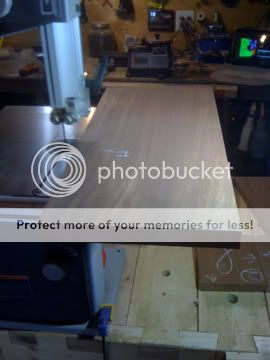

I bought 8 board feet of ribbon sapele to build a bench for my wife. While we were shopping that day we like to go to second hand shops. We stopped at an antique shop and i started digging around and found a 6 by 1 foot board in the back of the store. It was black walnut and very figured. I asked the old guy what he wanted for it. He scratched his head and said "20 bucks". I said "sold". So I got home and started to try to create something 'me' and my design.
Here is the start.
more to come…...

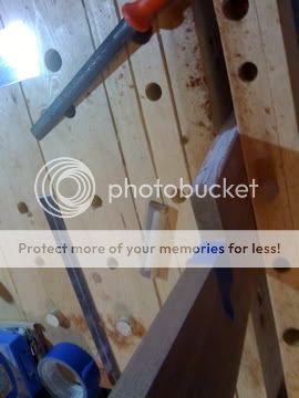

Today I needed to join the bench legs together. I do not own a biscuit joiner and needed a method of centering my bench legs. So I went to a big box store and bought the only dowel jig they had. It is a General dowel jig. I do no recommend this jig for it has to much play in it.
I had to elongate the holes to get the legs to match up. I was not a happy camper. It still managed to work out. I have the dowels so far apart because i intend to place a bowtie in the middle, so I did not want to have the dowels in the way.
The leg glue up went fairly well. All but the cold weather.
Now the dovetails for the rails begins.
Chopping on this sapele makes me nervous because it is very brittle.

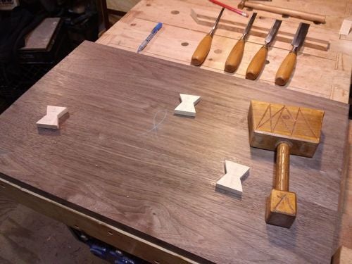

bow-ties
I had to stop working on the dovetails because my legs had cured. I wanted to place some bow ties on the joined leg assembly. And needed to do it before I cut the pins in the sides of the leg assembly.
As you have probably noticed the whole project is on a 6 in 1 theme.
All the leg angles.
The bow-ties.
I had taken some 4/4, drew out the bow-tie, cut it out on the bandsaw. Then re-sawed the one I made so they would be identical.
I didn't want to place the bow-tie all the way through the leg assembly because I did it by hand and didn't want any blowout.
Not bad for hand done. The holidays are up for me and I am returning to work in the morning. So the project will slow down in its progression.
Oh the mirror is on my bench because if shop lighting. It was my mothers and its one of those 10 power deals. It is great for my eyes are going bad and I can focus light on the back side of what I am chopping on. Its an old one so it weighs enough and doesn't bounce when I am hammering..

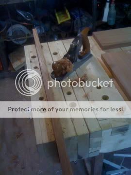

#28 ·

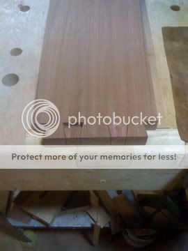

Double Beveled Dovetails
I have a fascination with dovetails as some of you might can tell. And have been in heavy research on how to layout and cut double beveled dovetails. I have had a lot of help from here and a few other sites. But I am a visual person. The big chopperoo had a neat stool- tool till on his site that was built on a compound miter. I wanted to do something like his box and put double beveled dovetails on it. He had pulled his video on the box for some time before Christmas and I emailed him to ask where it went. It seems that American Woodworker picked this up and he did an article on it with some video. So I have started this project finally. So here we go.
Planing up the popular 4/4
I have 2 of these 8 foot boards
But only had time to get one plained
I built the dovetail key that chopperoo suggested and without that I would have been confused. Dont take much.
Laying out the pins. I dont cut pins first but have no choice.
They came out fair.
This is one of the main reasons I don't cut pins first. You have to layout them on the backside of the tail board. So my accuracy is questionable. Not to mention the clamping contraption for the marking.
My first double beveled dovetail joint. Three hours later. I dont like 3d geometry.
After the first joint I have learned a few small things and hopefully each joint will improve. Then I should have a nice old tool till to carry my tools around with.

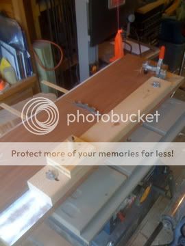

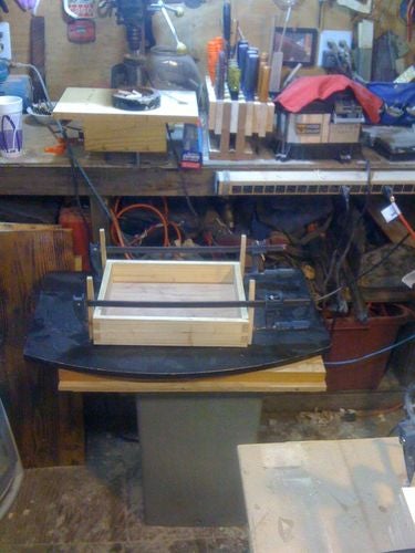

#42 ·
Tool till jigs and glueup
Well I have been able to steal some time in the shop and at least get a little done on my project. I thought I would show two of the jigs I have been using for the layout. Both of these jigs Chad Stanton had shown me how to make. The first one Is for the saw layout on the compound bevels.
The second jig is produced by the first. You make a mockup of the pin board and then layout your dovetail angle on the inside. This jig is the key and gives you your setup on your bevel guage.
Here is a shot of the dry fit.
I had also flattened some 4/4 for the bottom.
A little edge joining.
And the glueup.
While the glue was drying I whittled out the handle.
And after the glueup a little sanding and the handle in place.
The joints leave a little to be desired. And I learned one of the biggest lessons is because of the compound angle the marking gauge is not your true line.
Stand by more to come. Thanks for viewing;)

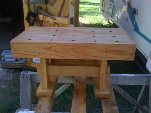

A small bench
She is a solid 3 inches thick. And gets my joinery up to where I can see it.

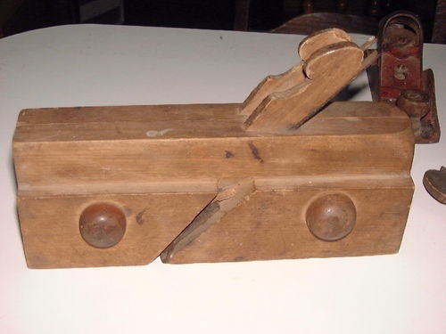

and last but not least. I found an Ohio skewed jack rabbit plane with knickers
Glad to see you came around. I've missed you (and a few others that are hiding lately). It makes me feel more at home when I have as many people as possible who are surely as crazy as I am.
I love all the photos. Nice work. However, the last one interests me the most. I have to admit WHY it interested me so much though, because I don't know what "knickers" means or what they do. The last time I heard a word that sounded like that was as a teenager when I was dating this british girl and she was yellinh something about what I was NOT messing with. Even then though i really don't know what she was talking about, since hormones was keeping me from hearing most of what she said.
Focus, William, FOCUS.
Anyway, I'm assuming that "knickers" has something to do with thise giant pliers looking thing-a-ma-jigs. What do they do and how does it realte to the plane?

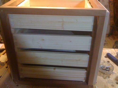

#81 ·
Antique shoping and a new toolbox build..
I have been wandering around again searching for old tools. I have come across a lot but most were in bad shape or the price was astronomical.
I found a nice little 1 foot ruler. For $3.00.
Now mabee you guys can answer this question. Who implemented the tenth scale on these old rulers? I own two of these. One side has 1/4 scale and the other side is in 1/10 th scale.
And I found two nice clamps for $12.00 apiece.

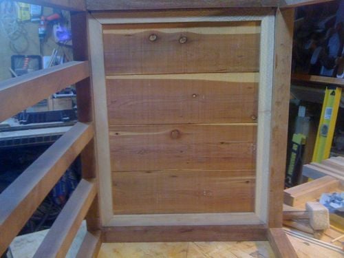

I have been wanting to build a small toolbox for knives, marking devices and so on. I have a bunch of small pieces of different species of wood. I have chosen to build the box out of an assortment of wood and joinery. It probably wont be pretty but it will be different.
First the frame. Sapele
The coners are lap joined with pegs. The drawer rails are dovetailed.
I chose to mill up some material for panel frames and use cedar tongue and grove for the panels. I have a bunch of the frame material but I am not sure what it is. It has a very heavy medullary grain to it when you quarter saw it. It works very easy under the chisel or plane. It is also very brittle. Would you have a guess what it is.
I had found a nice bunch of planes at one old shop. The gentleman wanted $65.00 to $180.00 for the planes. I didn't buy any. He had a nice Liberty that I was drooling over but he wanted to much.
My plane till is well stocked with a few good users. I may start collecting some transitional planes. Those seem a bit harder to find. I think because they weren't made as long as the wooden planes.
Thanks for reading;)

Christmas 2011 - tools, tool box, and gifts...
This is going to be a long one, it's raining and I have had a long day pushing planes so here we go.
I started about a month ago with the intention to build a small tool box to hold marking gauges and some stuff I don't want bouncing around the shop. I choose to use a hodge podge of wood I have laying around the shop. The frame is sapele.
I choose to dove tail the rails
I pinned the rest of the frame with oak dowels.
I picked sycamore for the panel frames
It has a very cool quarter sawn grain
I used cedar for the panels
I used pine for the secondary wood for the drawers
small pile of shavings
large pile of shavings
using my new Moxon vice to dovetail drawers
4 drawers finished
Now there are no pictures of the next event and I was so mad at myself I choose not to take any. For whatever reason I cut the dado's on the wrong side of the drawers. CRAP. I got new material and started again. I put 3 tails on the first set. The second set only got 2.
I also Had purchased a new set of chisels.
I did not have enough material for the drawer fronts so I went to the hardwood store and purchased some zebra, maple, gum, cherry and cypress.
note I am shopping on the bargain rack
Also a few tools started showing up from my wife for my Christmas
Japanese saws
A Stanley 71 that I refurbed
Now my wife was in need of Christmas presents for her bus drivers - remember the trashed drawers, hmmmmm
Now I have got time to get back to the tools box. Glue up on the second set of drawers.
I cant get over the grain on the sycamore
starting the frame for the drawers slides.
test fit
starting on drawer fronts
I know the box is a contrast of colors, textures and grains. Its a patch work (quilt) tool-box. So far It consists of sapele, oak, pine, popular, cedar, sycamore, zebra, maple and bamboo. I am not finished yet. I also got a dado plane, 2 sweat heart rulers and a knife or two. It has been a very enjoyable Christmas this year. Dave got to see his grandsons second Christmas. Much to be thankful for.

First off….Merry Christmas Dave…..
Second - wow…what a major post post - I had to take an intermission somewhere around the trip to the hardwood store….:)
Third - love the mix of woods and joinery…...perfect. That's the way I do it too…...any knots?
Forth - sorry to hear about the dado debacle….....sounds like everyday in the shop for me.
And finally - nothing like some cool new tools for the cave….......

Hand Inlay of a Bowtie-Dutchman
Here is a method I use for inlaying a bow tie.
You can cut any shape you want, I just grabbed my bevel gauge, set it and drew some lines on a scrap of cherry.
I cut the lines out and cleaned up with a chisel.
I placed the scrap on the work piece and layed out the lines.
I carefully cut just inside my pencil line.
I then routed out the waste material with a plane.
Then glued the piece up and bashed her home.
Here is a video of the process and pictures say and teach a lot more.
Any questions, comments or suggestion are welcome. Thanks for your time.

Old tools from LJ's and some small builds..
I have been really blessed with help from fellow LJ's on tool finds. I purchased a Tormek from KTMM, I love it. There is still a learning curve.
KTMM also has sold me a Stanley 95 TypeI
BoxcarMarty helped me get 2 old wonderful Ohio planes
I have been shopping at a few antique stores but couldn't find anything worthy of bringing home. But I couldn't come home empty handed.
found these
There were many piles of old tools but they were overpriced or in bad condition. I live to find piles of tools like this.
