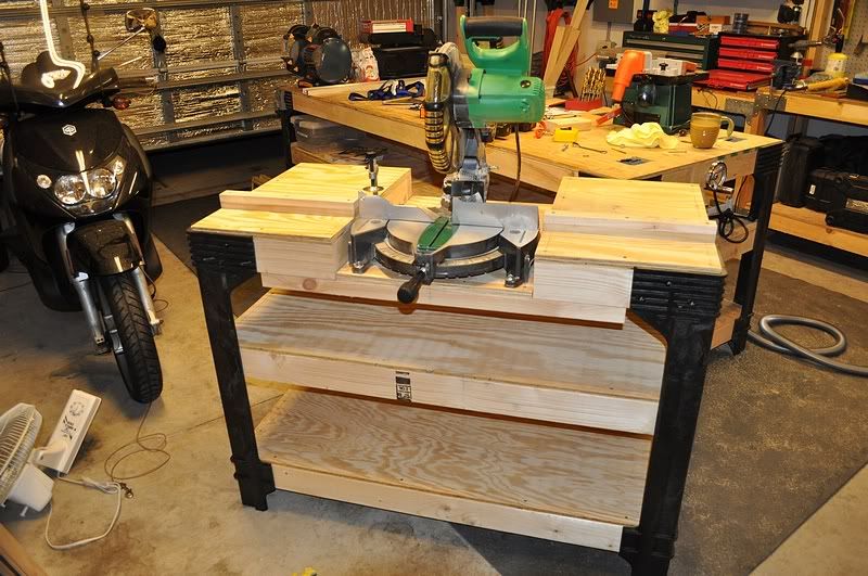

So the wife just hit Amazon and got me one of those 2Ă—4 Basics workbench kits. The ones where you just add 2Ă—4's, some water and poof.. you have a work bench.
I feel like I am cheating, however even though I am paying for essentially 4Ă—4's, being able to just cut some 2Ă—4 on my new 12" sliding mitre seems like a compromise to move ahead quickly.

#2 ·
Unless floor space is an issue, I think that I would just leave the little table saw on its current stand and make a separate router table. Look around at some of the various portable router table designs. You can easily make (or buy) one that attaches to or sits on your work bench for example. They don't have to be a stand alone design. I've used one for years that is not much more than a piece of 3/4" plywood with a hole drilled through it for the bit and a recess routed in the bottom for the mounting the router that I simply clamp to a corner of my bench. When it is not in use, just lean it against a wall or the the workbench. There are many other more ingenious designs out there.
