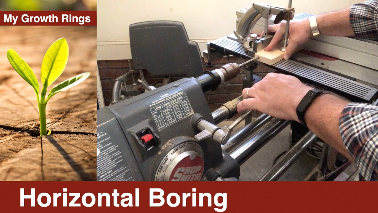

#34 ·
Horizontal Boring on a Shopsmith Mark V
A horizontal boring machine is one of those tools that few woodworker even consider, because with the exception of the Shopsmith Mark V, most other options are large and expensive dedicated tools. Any time I am drilling into the edge of a board for joinery I always go to this simple set-up.
Watch it here:
