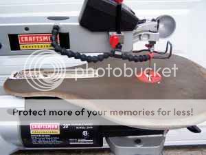

I ended up getting some other saw…....I think! It's been so long. I know it is an older Craftsman with variable speed dial on the front. I will post an image of it here as soon as possible.
