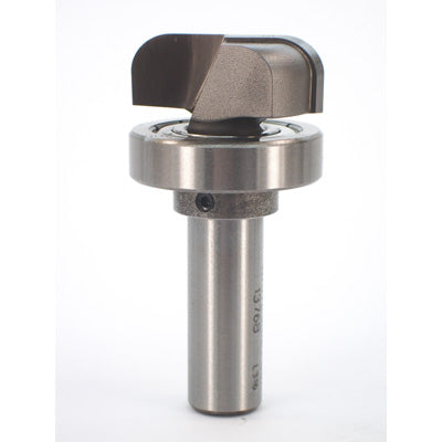

I’m trying to purchase a 3/4” radius cove bit with a 1/4” shank but they only seem to come with a bearing. I’m looking to route out the cove while leaving a 1.5” flat area from the edge.
I found a whiteside bit but it has a 1/2” shank.
I’ve been googling for a few days now with no luck. Does what I’m looking for exist?

You've got a tricky situation there. The flat presents a problem to me.
If you can find the profile you want that way, try looking at other bits like bowl and tray bits.
Finding that in a 1/4" shank will be an issue. Also a bearing seems to be a must.
Sometimes you get as close as you can.

I use core box router bits to do what @Booker909 wants to do. In the past, I used smaller ones mostly for juice grooves in cutting boards.
I just bought three ultra-cheap core box bits in 3/4, 1-1/14, and 1-5/8 for $12.99 from the big online retailer. Those had 1/2 inch shanks, but that is better for my needs anyway. Allow me to emphasize that they were very low cost. I am confident I got no better than I paid for, but they will do what I need for the current project.
I was originally planning to buy the Bosch 3/4 inch core box bit (1/4 inch shank) but the convenient Lowe's was out of stock, so I ordered the cheap online set described above instead. They arrived on Monday. I tested them out on Tuesday. I will use them to make grip handles (pulls with finger indents).

As much as I’d like to buy a larger more powerful router that accepts 1/2” bits I’ll work with what I have and accept the limitations.
I think a core box bit could work, especially if I have the wood lie on an angle on the router table.
Also stumbled across a 1/2” cove bit at HF today for 9.99 that I wouldn’t mind cutting the bearing off of just to test.
