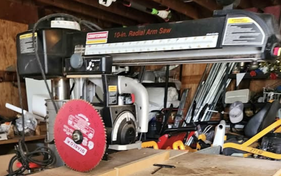

Hi all!
I'm excited to get my first radial arm saw, but there are so many to choose from on Facebook Marketplace! Currently, I'm looking at some Craftsman models and not finding much information anywhere on the relative quality and features between them.
Any Craftsman RAS aficionados who can explain the ins-and-outs of these various models? As I said, I can't find any information that details the differences. Even ChatGPT has a hard time finding anything.
EDIT: I found most of the model numbers of these. Added to the text.)
The Craftsman "Professional", with the motorized carriage looks pretty good, and there's one available in my area that looks to be in perfect condition. (And yes, they do have the blade guard :) ) (Model 315.220381)
And there's a 3.0 HP "Contractor Series" available that looks to be in good shape. (Can't find model # of this one)
And a different "Contractor Series" model (Model 113.196380)
Are those (the "Professional" and "Contractor") considered the "top of the line" models of Craftsman radial arm saws?
Then there are what look like to be different models that are both 2.75 HP. One has a large lever on top of the arm to release the swivel motion, the other has a sliding lever on the front of the arm for that purpose. (Model 113.196321)
(Model 113.197150)
Then there's what seems to be the more common, maybe more consumer-level, model that I see a lot of (Model 113.197751):
And, of course, there's the "Electronic" model (Model 113.198251, which seems to be identical to model 113.198110 but with the electronic bit added.)
And finally, there are a few of what I would characterize as more "antique" models. This one shows "Radial 100" on the label, and the seller says it's in "Very Good Shape". (Apparently, this is model 113.29411, aka: "Accra-Arm".)
Thanks!
—Dan

I've owned/used/bought/sold a number of Sears RAS models. I once had an antique/collectible store and had an area set aside for tools of all kinds, for the guys accompanying the wives on shopping trips. The absolute best at accurate setting and holding those settings is the older ones, I think first model 100. All cast iron column and arm, ways ground into the cast, not screwed on steel rods, and depth adjustment crank on the top of the column.
Not a lot of power or fancy features, just runs and cuts accurately.
In general, as they added marketing features they become less accurate, and more trouble-prone. Just like cars!
Some think the RAS has been replaced by power miter saws. And for some uses, like trim carpentry, they have been. But, for general shop use there are some things they excel in.
Dados for one. Ripping can be done, and safely. I've ripped literally thousands of feet with then with no injuries. There is a technique, but they work well.
That said, if I were in the market for another, I wouldn't buy a Craftsman but search for a Delta or Rockwell turret model. I've had 10, 12 and 14" models and they were all excellent. The 10" uses commonly available blades and other attachments such as dado heads while the larger ones have bigger arbors.
#12 ·
I have both Craftsman (2) and Ward's Powr-Kraft (3) saws, and appreciate them both for different reasons. I would say the Craftsman are easier to run, but the Powr-Kraft is more tune-able. Also the Powr-Kraft has two accessory spindles, a 3450 rpm as well as a 20,000 rpm. In addition, the Powr-Kraft gear induction assembly makes it very friendly to deal with when things go awry and bind up.
#13 ·
I have owned a craftsman, labeled the professional model and posted a question on table measurements on this site a couple years ago. RAS used to be the solution for crosscutting until the sliding crosscut saws came out. The biggest problem I had with the craftsman RAS was making a square cut. It cut fine for construction lumber purposes but not for woodworking. I could get it square, make a few cuts and it would be out of square enough that I went back to my sliding crosscut which holds square.
#14 ·
Just a comment, you seem to be overly focused on newness, "looks like it's never been used". That shouldn't be that important in your search, look for a reliable brand (back to Dewalt and Delta/Rockwell) and give the appearance thing a second of 3rd point in the search. My Dewalt looks terrible, but yet after tuning it's dead accurate, I swing the arm back and forth all the time and it returns to zero, but it's probably the ugliest thing in the shop (excluding me). A bad RAS (Craftsman and maybe a few of the others you've asked about) will make you cuss the day you heard the acronym RAS and abandon the forever....like so many others have done.
#18 ·
