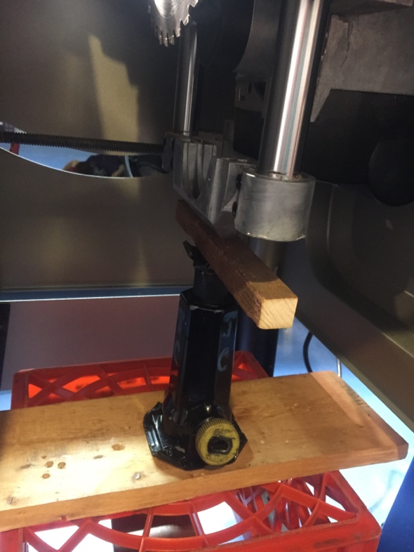

Couple fresh-off-the-pitch thoughts… Couple minor ones before then a more complicated one…
Final alignment tweaks
I found that when tightening the rear support bolts, the back-edge of the blade moved away from the motor (not using left/right since you are working from the back of the saw most of the time that might be confusing) as I tightened them, and therefore I needed to set the back-edge of the blade a hair extra 'towards the motor' before snugging them up to get it as good as I could. When I got it right the 'over compensation' just disappeared when they were tight and the blade was perfect.
General tightening of major fasteners
While I was under there I did hit all the significant bolts with a quick wrench. A number of them were not terribly tight. This includes most significantly the angle-saddles with the big torx bolts that affix to the underside of the table, but also the clamp bolts at the bottom of the riser tubes. I wish I had done this when the saw was new. Obviously take care as if you strip one of these it would be a hellish thing to deal with properly but it does seem that there isn't 100% QC in the Chinese factory where these are put together.
Blade lower guard
As part of the project below I pulled the lower blade guard, and discovered that the little internal light strip that sits inside was quite mangled. Clearly some little offcut bits that fell through the very-not-zero-clearance throat plate got thrown down there with some force and banged around a bit… What worries me is that that strip eventually gets bent up into the blade by a scrap and then somehow is thrown out itself and becomes a horrifyingly dangerous flying knife. I will attach a pic below… in that pic I had 'fixed' the bends a bit but hadn't done my final 'mod tweaks' to it…
I am still thinking about this myself and am considering removing it entirely. It is there for 2 purposes I think - one is vacuum shaping, and the other is to keep thrown off cuts from flying around further and to direct them down the chute if possible. I am leaving it for now because I think the 'direct shrapnel out the back not out the top' is a safety benefit I am leaving it for now but before re-fixing the part, I did bend those rear corner edges back away from the blade a bit more and hoping for the best.
Blade 'sliding' when lowered…
Now… regarding the issue that I reference above where the blade "slides" sideways as you raise/lower the motor but worse also seeing misalignment at the bottom of travel vs the top. I think there are two things operating here…
One is an overall design flaw in the unit caused by the lack rigidity in various parts, most likely those riser tubes. Either that or my risers are slightly bent due to shipping impacts but I doubt that is the case having now examined the assembly in detail. As you lower the motor it increases its moment on those tubes and at the bottom I think it's weight is able to deflect the tubes slightly to one side (towards the angle-trunnion-shaft side). This probably also then causes a slight angle defect which you then can of course tune-out with the angle-trunnion, but you need to think about when you are going to extreme low positions (also explains some cut-defects I have had that I could not formerly understand when the blade continued to measure square and true at the 'top position' where it is easiest and theoretically most accurate to set…. unless it indeed changes as it lowers… which it does…)
But in addition to any 'symmetrical deflection' tendency, you can imagine that both tubes would have the tendency when loosened for adjustment (or over time with vibration perhaps) with the motor in the lowest positions, to want to angle away from the motor due to the center of gravity being far to one side. You can easily imagine that when you have loosened the tubes the weight is going to want to push them off-square / off-true-vertical at the bottom. And of course for alignment to reach the bolts - you must have the motor at the bottom of the travel and are therefore maximizing the force in that direction as you have them loose or are about to tighten.
Here's the extra rub: to some degree the bottom of the front riser tube is located left/right by the angle-trunnion shaft, so it can't really wander very far… but the rear tube has no such locator. So it can wander in the anti-motor direction further, resulting in a not only a 'slide' but a 'twist' as the motor is lowered, and explaining how your top alignment might be perfect, but then the bottom alignment suddenly appears well out, which was what I witnessed.
My solution to this was fairly simple… support the entire motor / chassis assembly lightly while doing the alignments. This is a slightly tricky balance as you want to take up some of the weight of the motor and chassis - but - without putting undo upwards pressure on it, even actually without taking ALL the weight off so that enough weight is still 'settling' the parts in the locations that they will normally 'sag' to. Picture also below…
My process is now in a nutshell, this:
1. Disassemble per other documentation
2. Support bottom cross-member of frame very lightly from below (again - not trying to take all weight up)
3. Loosen both tubes and set alignment both at top and bottom, iterating back and forth until both are true
4. Retighten and remove support and re-check (typically will be slightly off now again as weight settles a bit)
5. Very lightly support again and fine-tune with rear tube only as needed. Iterate 4/5 until satisfied.
By doing this I was able to reduce the 'slide' notably although not entirely, and seem to have alignment at both top and bottom of the travel.

- Scout989
I had the same problem with mine. Check the tracks where the saw moves when adjusting for angled cuts. If you remove the blade plate on the table it should be in the front of the opening. Mine was not straight and had to carefully use a punch and hammer to push it back on track. After that I could easily adjust the blade to 90 from the t track on the table. I hope this all makes sense.
#25 ·
My new Delta 36-725 blade is visibly off by about 3/8 inch rom front to back of blade. Is this worth trying to align or just return as too far off?
Hard to say. The next one might be just like that. These are crappily assembled from the factory it seems.
How far have you gotten on the setup? If you've invested a lot in other setup already - rails an whatnot - then I'd say no, if you only just opened the box then maybe yes… You always could try to see if the store will let you open other boxes and see if any others look better, then return it if you find a good one.
However my experience was that the saw needs a ton of hard work to setup properly anyway.
If it wasn't such a bear to wrestle down into my basement and I hadn't gotten so far along in the setup, honestly I mighta returned mine too and gone another way… TO this day 2 of the side panels are not on the saw because the mount holes were so far off as to be unusable from the factory…
