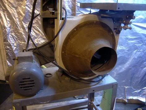

Going to the other extreme - here is the turbo version of dust collection that just makes me die a little bit inside every time I see it:

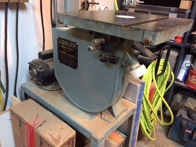

Here is my version for Dust Collection For An Old Bandsaw:
The area around my bandsaw is a lot less dusty now … if I remember to turn on the dust collector .. lol.
I didn't want to alter the original cover … OCD I guess …
However, I do like the TURBO Version above … that's awesome!
