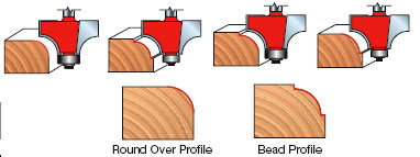

I'm a noob to routing. Looking to rout a table top edge, ogee style. The thickness is 3\4". I want no shoulders of fillets or whatever they are called, just soft curves. I hope I explained myself clearly. Thanks for ANY help!

Actually, with no fillets, that makes it a roundover bit…
To do soft curves top and bottom, run it once form the top, and once more from the bottom. With a 3/4 thickness to your material, you have to go smaller than 3/8, because you need a flat to ride the bit on. You could do 5/16, and leave 1/8" flat in the middle. Or, you could do 1/4 and leave 1/4 in the middle… Or do a soft 1/8 and leave 1/2" in the middle flat.
You can get a bit that does a full half circle, but you'd need a template, or some method to keep the bit at the proper depth…
Or, you could put a bead on the top and bottom, by using a half round bit smaller than 3/4 diameter.

#14 ·
I achieve that profile using a table edge bit. To get the rounded top line would be difficult for any bit as it would have to curve over. I don't think it would cut well doing that. So a little sanded edge is required. You can get them in various sizes so the curve can be long or more stubby. For me this is the only way to get this type of edge that I've seen in my limited work with routed edges.

In my post above I've never seen one exactly like you want but the one I use (picture) is very close. A little sandpaper on the top edge after will make the profile. And it is a table edge router bit.
