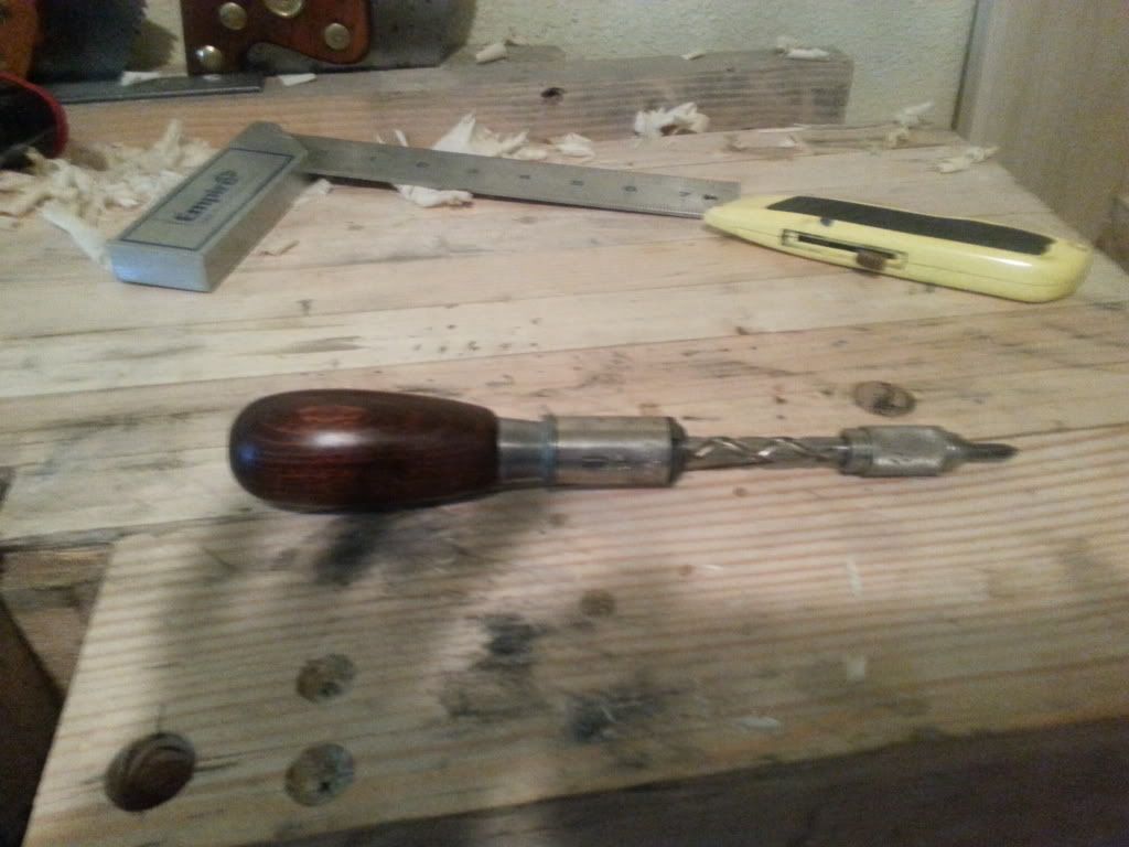

I had (might still be buried somewhere) a small bench vise that bolts onto the bench but only if your bench was about 1" thick or less. It has 1.5-2" jaws on it.
An eggbeater drill.
There was at least one style square.
They also sold tool sets in wooden or cardboard boxes. Those included a short saw (very hard to find) and the brace also came with up to six screwdriver bits - 3 regular and 3 phillips.
