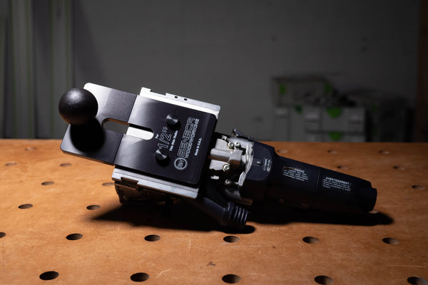

I believe @MFled is correct, at least that was my experience. Seneca came out with their Domiplates for a reason.
So no, I was never happy with the alignment. I tried everything and paid attention to everything I could like holding it different ways, being aware of the plate contacting bench, massive down pressure in the fence etc. but became frustrated - was it me or the tool? I ended up concluding it was the tool.
I did get good results, but I could never get consistent results. Slightly misaligned joints can be dealt with but my conclusion - the Domino is good for joinery, not as good for alignment - in my hands . I see all these other people using them and getting perfectly flush joints and got tired of wondering why I couldn’t. I thought the Domino would be a game changer and it was not for me.

#14 ·
Domino is a pretty easy tool.Understanding it’s features makes for the best experience.
Keeping the plate flat to the work results in zero problems.
Obviously not. Yes it's an easy tool, but it has nothing to do with understanding the features.
Seneca makes those Domiplates for a reason. I always felt using the fence was not as consistent.
I got the best results registering off the table as other's suggested, also pushing at the cord end. But you have to remember to put face down and you have to wrap the alignment mark.

I think the issue is alignment of the surfaces.
The Domiplate was created for plywood but it solves the alignment issues involved with registering off the fence. I've never used one but turning the Domino upside down probably takes some getting used to.
