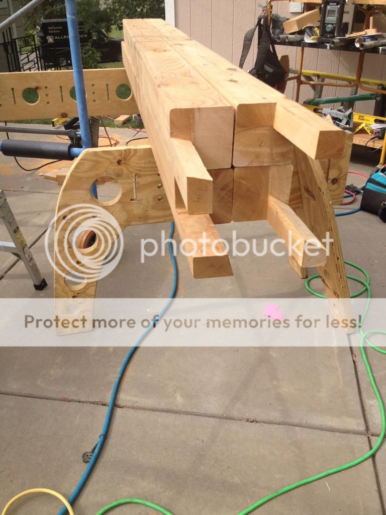

I would stick with 6Ă—6 posts, The beams are best narrower than the posts and deeper too. Narrower beams can let-in by notching the posts to receive them. This allow for a secure connection between post and beam with less invasive hardware or penetrations in the tops of the beams. Countersinking lags in the tops of beams exposed to the elements invites decay and failure.
Here is a photo of the posts I notched for beam connections a few months and a photo of this odd shaped pergola:

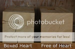

You probably don't want 4Ă—4's from Home Depot. The are almost all "boxed heart" stock, meaning the pith or center of the tree is in the center of the 4Ă—4. This stock usually warps, twists, checks and generally behaves badly.
You want "free of heart" posts. I would not build this with 4Ă—4's either.
