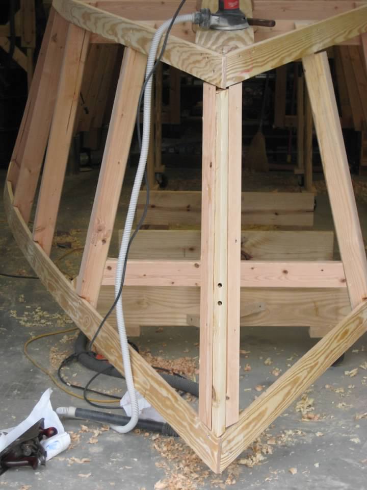

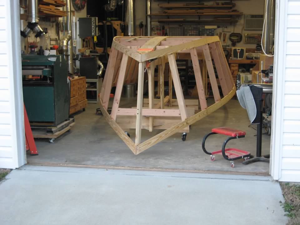

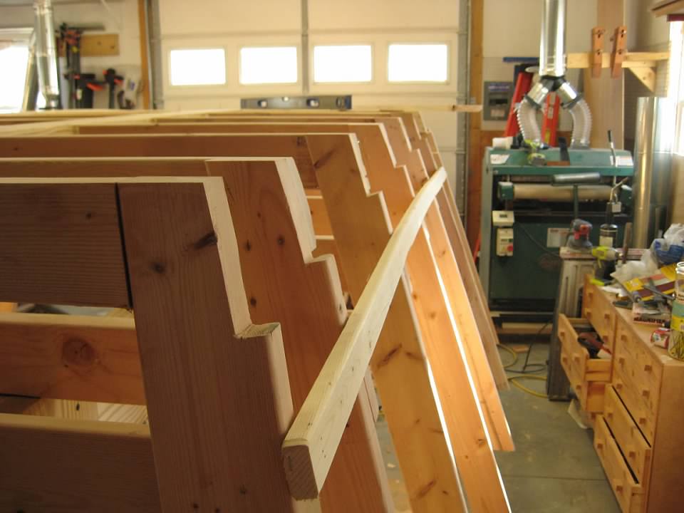

I have started a new project for the winter. I am building a 19 foot Offshore Power Dory Boat. I am 65 years old and have spent my life building things for everyone else. I have always wanted to build a boat, so with my wife's blessing that is just what I am doing this winter.
I have spent hundreds of hours studying boat plans, reading about building boats on boat building forums and researching about every thing I would need to know to build a boat. I picked a plan. A 19ft Offshore Power Dory from Spira International Inc.
The design is simple, 2Ă—4 lumber for the frame. Marine plywood for the skin, epoxy and fiberglass to keep it dry. Sounds simple right.
I chose to use Douglas Fir for the frames, and I plan to use Douglas Fir Marine Plywood for the hull and the cabin skin. I have got started and I will update the blog as I go. I have about 40 hours in the build so far.

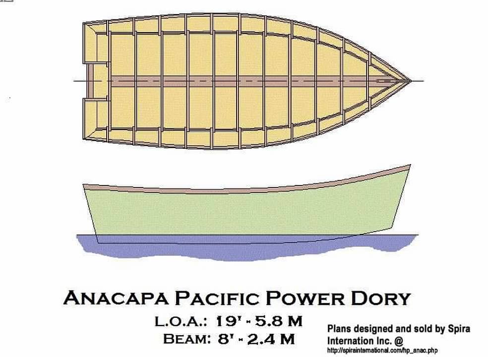

Here is what I plan to build, This is the hull plan.

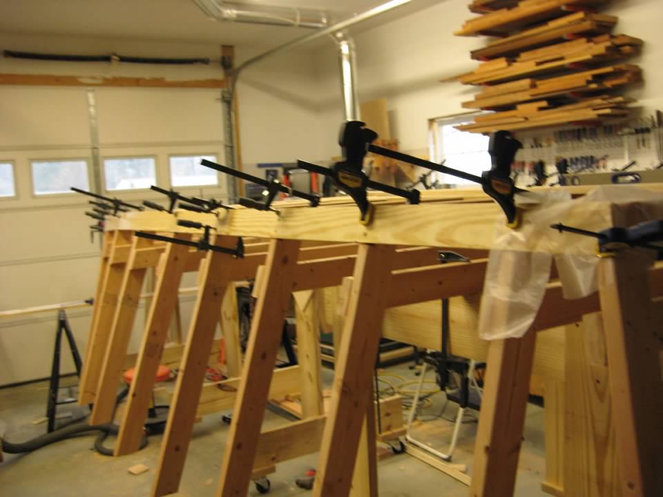

I hope this is the way it will look when I finish.

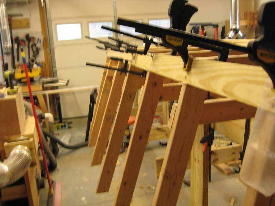

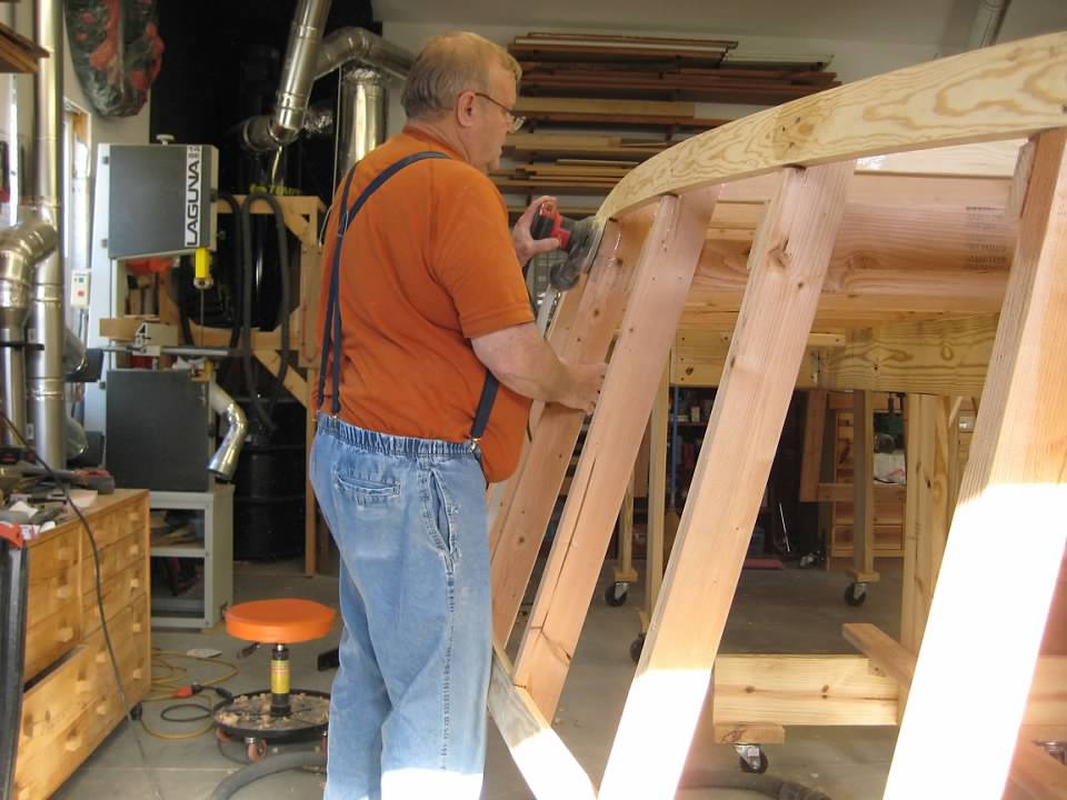

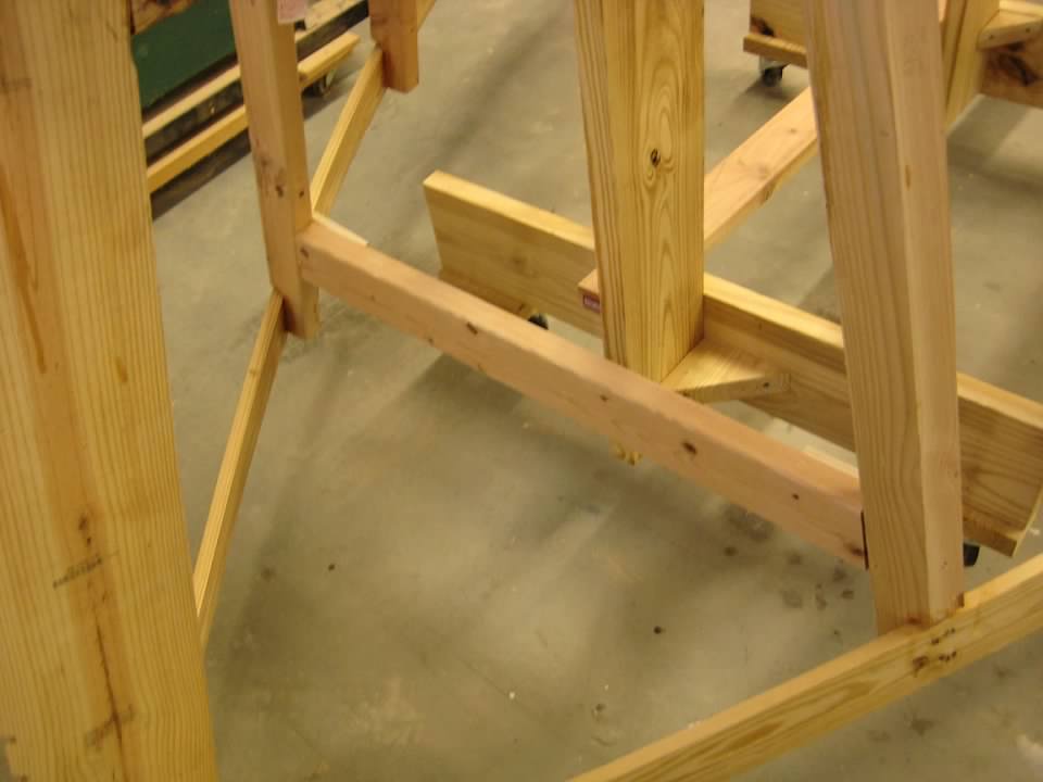

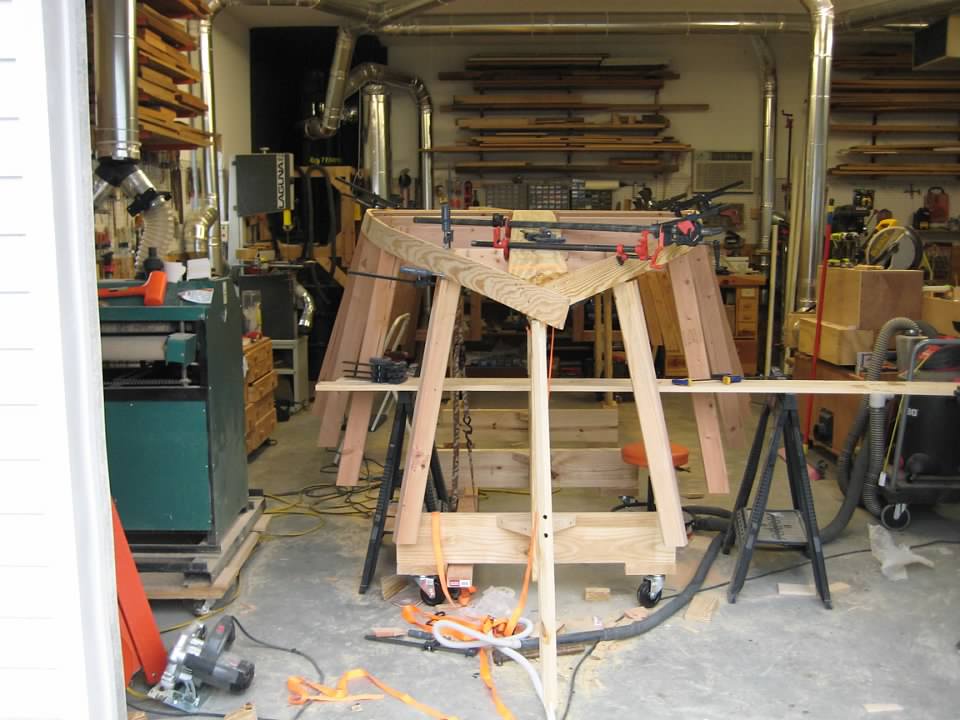

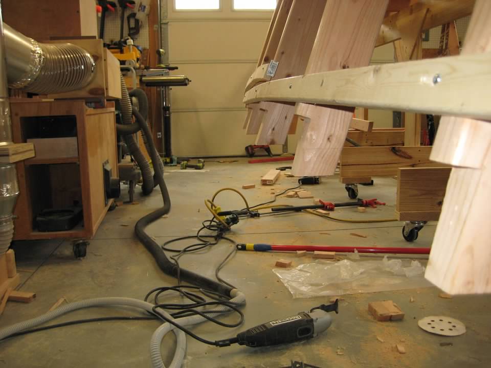

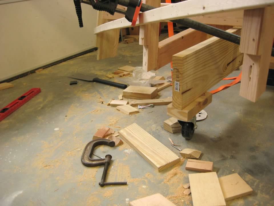

To build the boat you need something to build it on, something to keep everything straight. They call it a strong back, here is mine.
It is made from 2Ă—8 lumber, I added the casters so I could move it back and forth in my shop to make room to work on it. It's awful big for my space.

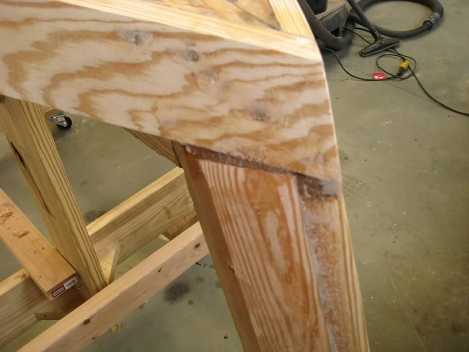

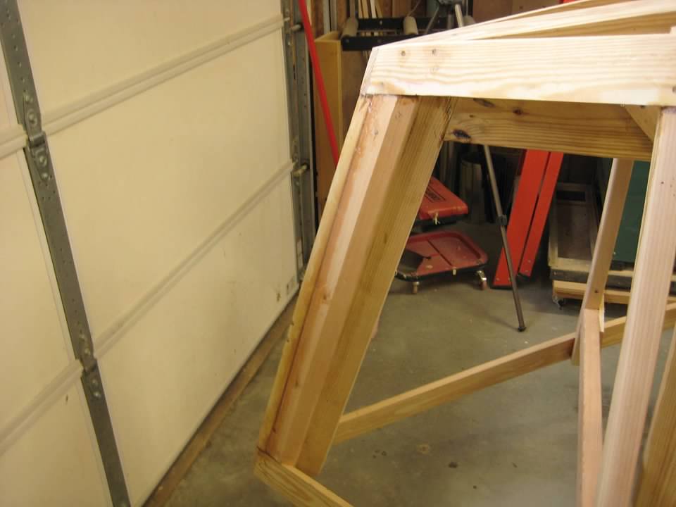

Then you have to build the transom and the frames. To do this you use a piece of plywood, a full sheet, and layout the frame dimensions. on the plywood.
Then you lay the lumber onto the layout on the plywood, mark your cuts, then assemble the frames on the layout.

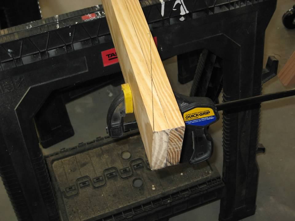

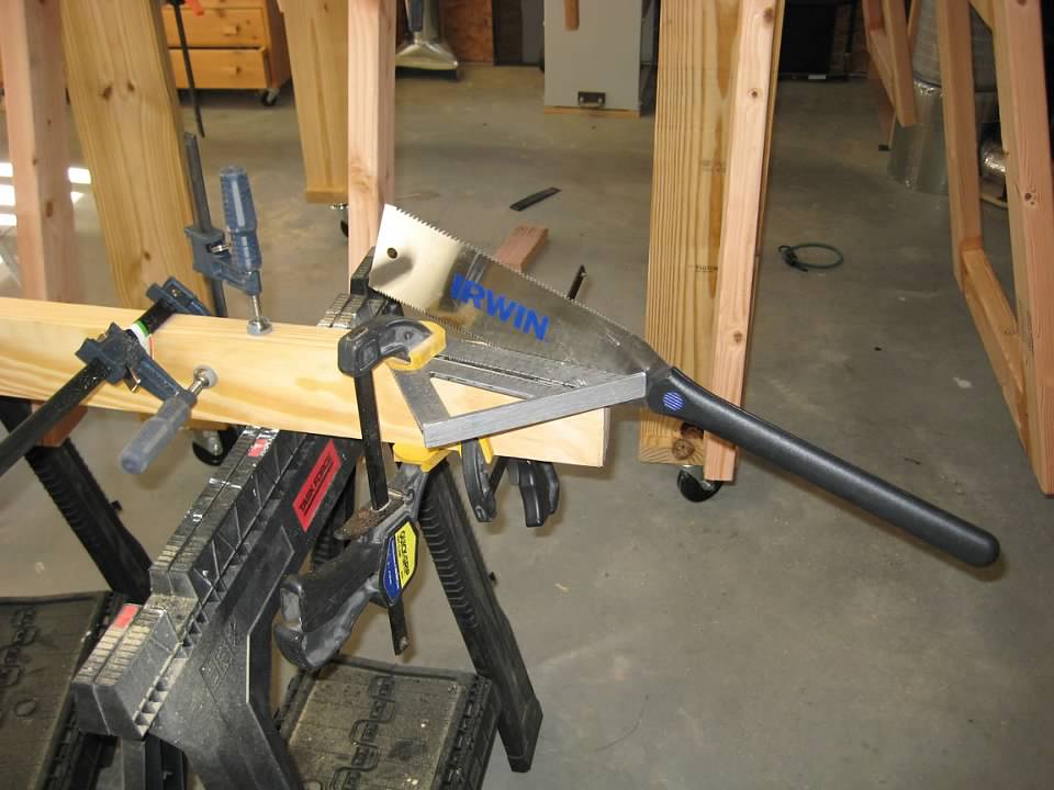

You also need to layout and cut the opening for the "keelson" while the frame is on the layout.

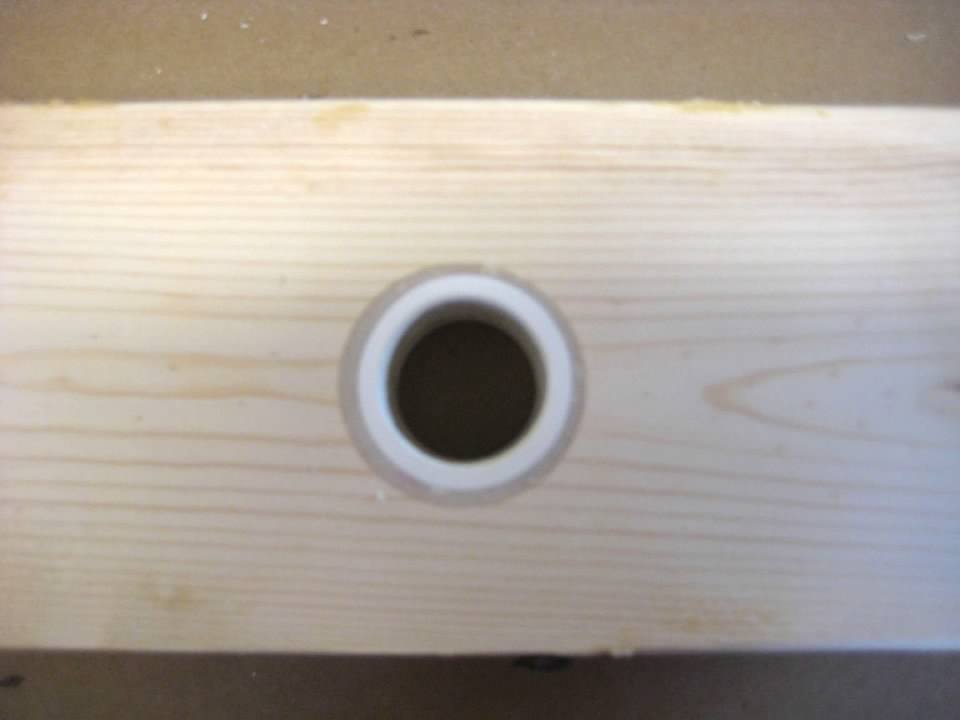

Then you need to drill out the corners, drilling reduces the chances of the lumber splitting as well has supplying Limber holes for the bilge water to pass from frame to frame.

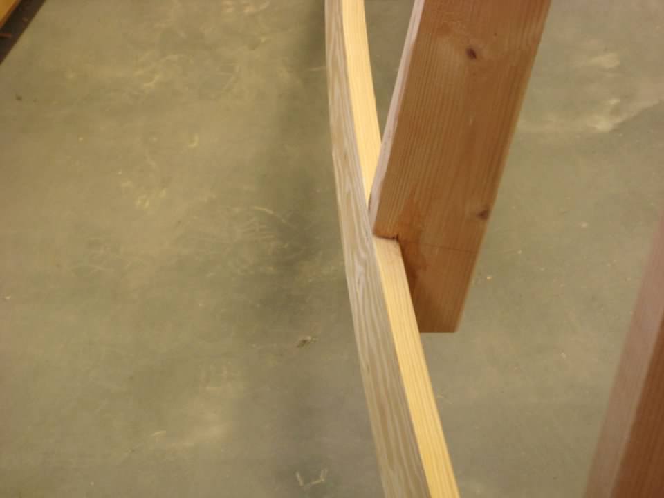

Once the limber holes are cut you need to cut out the notch.

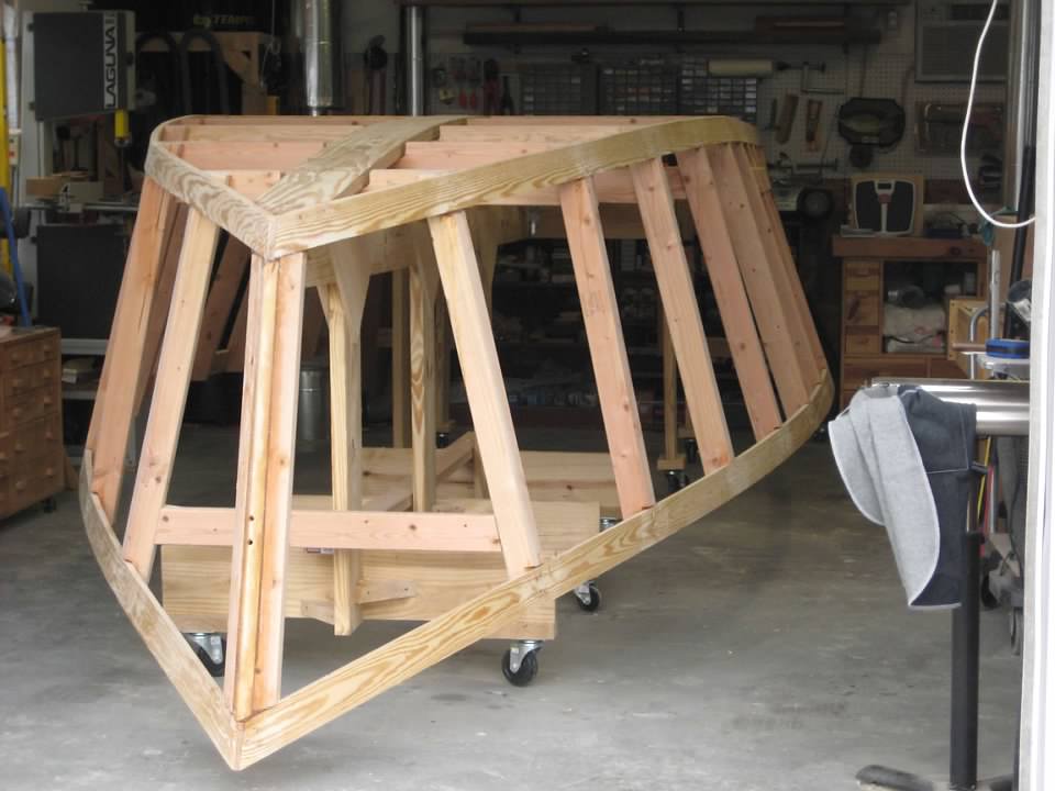

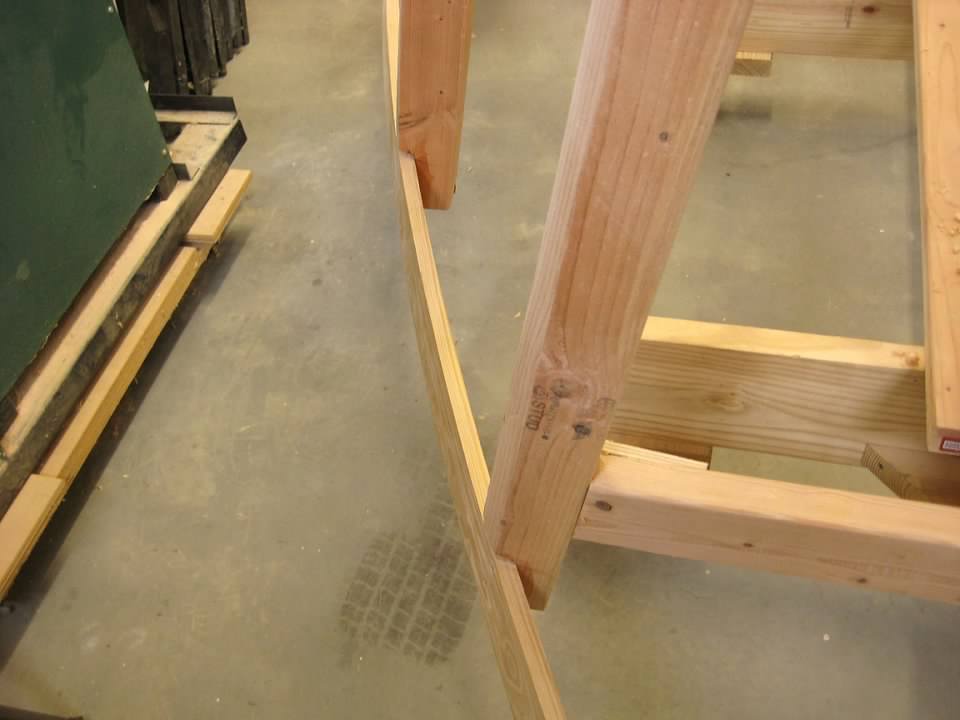

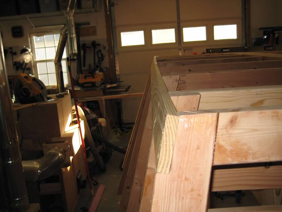

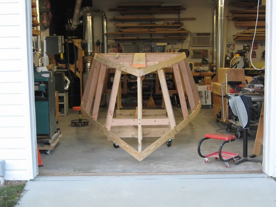

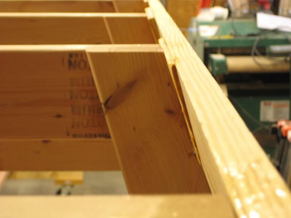

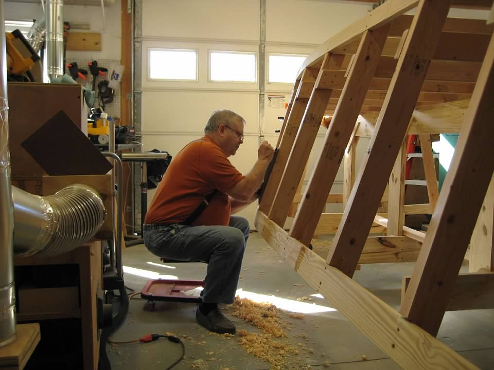

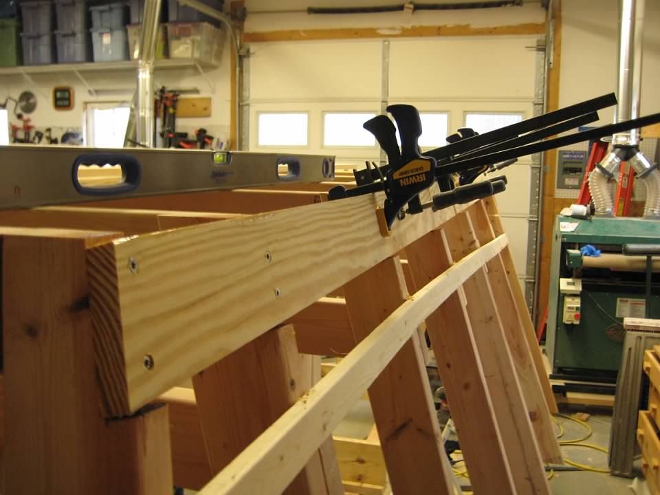

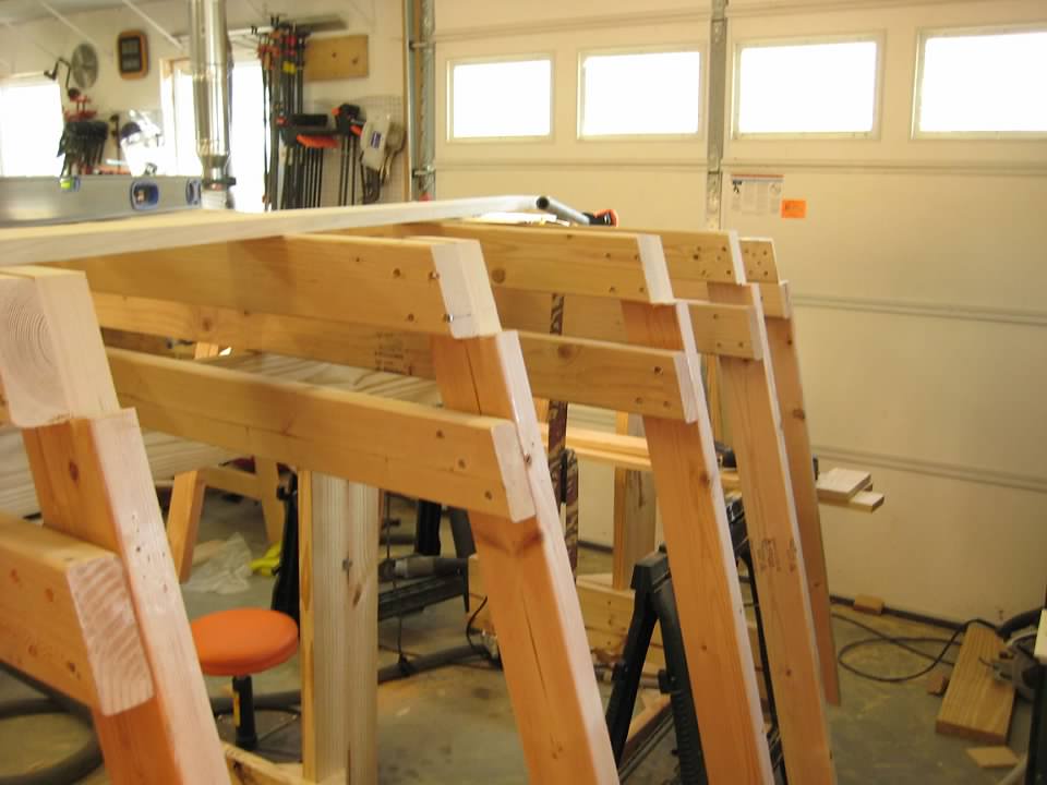

Then as you build the frames you lay them out on the strong back.
Until all of the frames are built and all of the joints are screwed with Stainless Steel #10Ă—3 " deck screws and glued with epoxy glue.

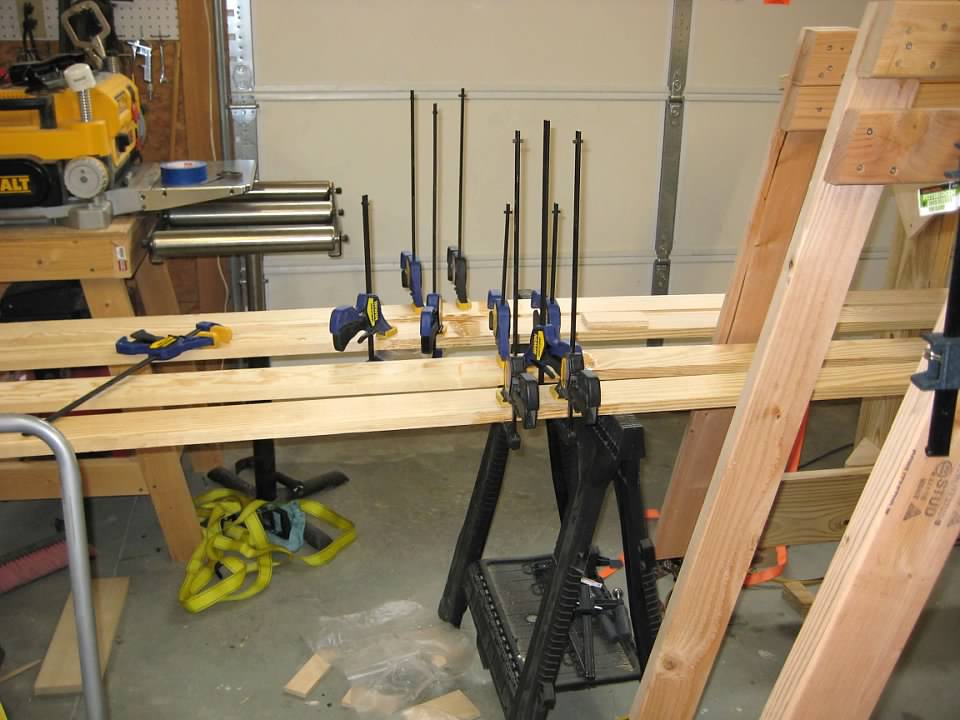

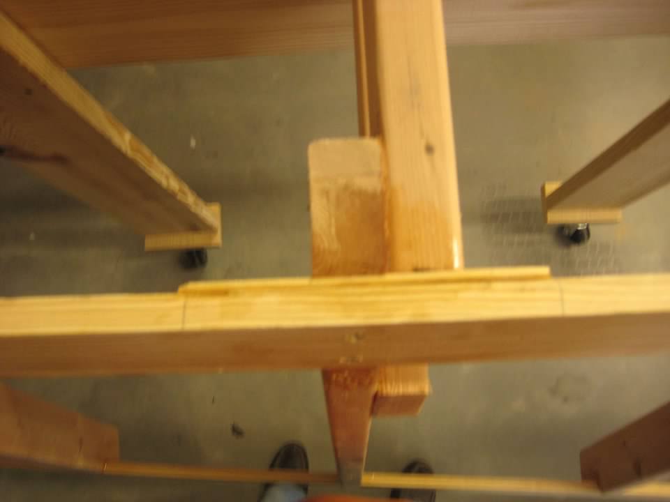

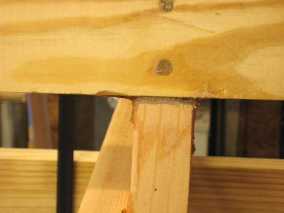

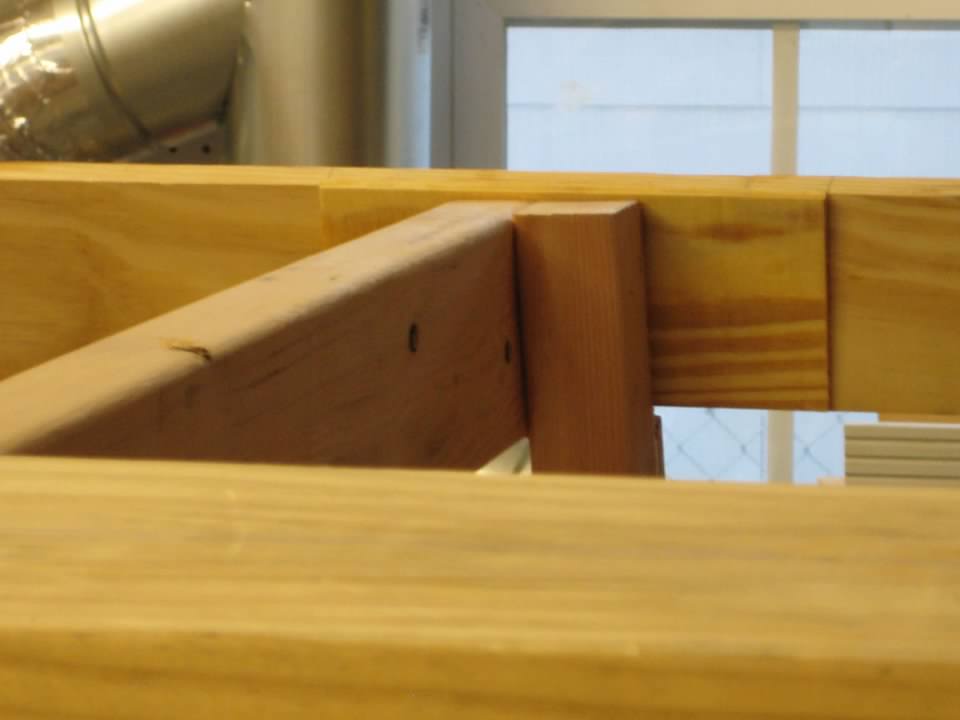

Next you need to install the keelson, this is the structural piece that holds all of the frames together.

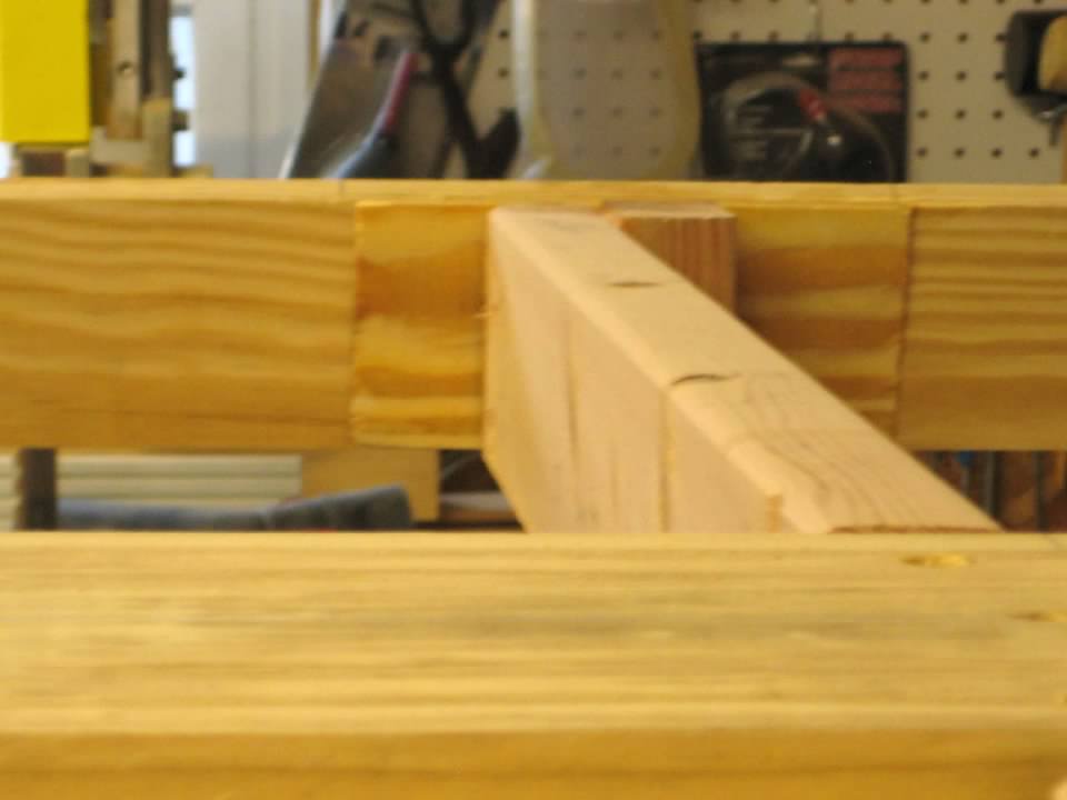

Here is the slots that the keelson will be installed.

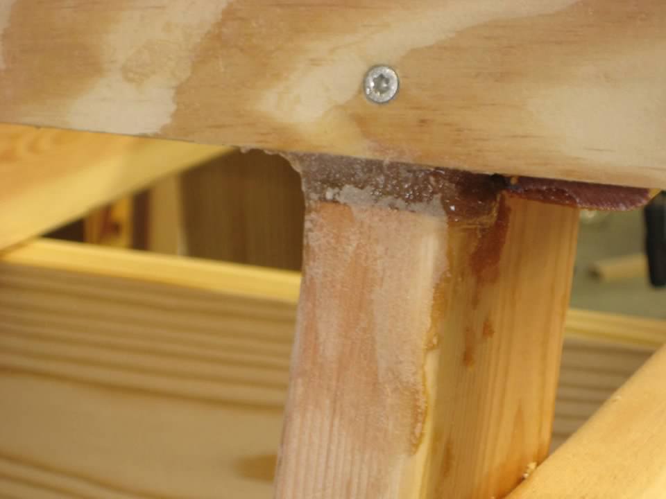

For the keelson I had to use a piece of southern yellow pine, I could not find any Douglas Fir that size, needed 2Ă—8 x 20 ft.

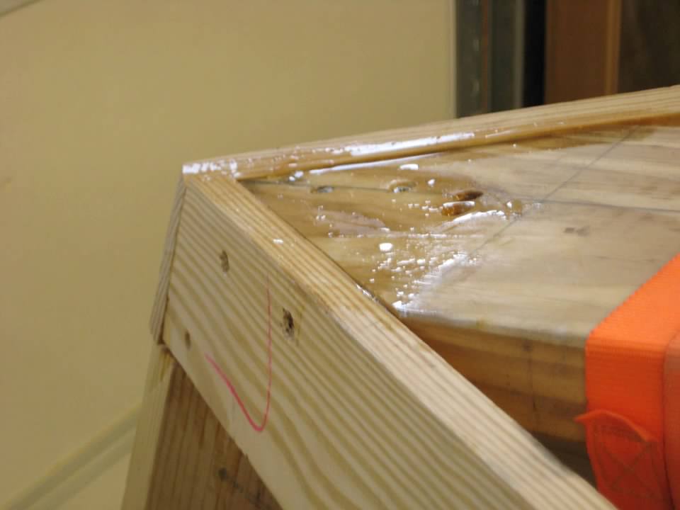

The keelson is now installed and glued with epoxy and screwed with Stainless Steel #10Ă—3 " deck screws.
As I progress I will add new blog entries with lots of pictures. I have about 40 hours so far in the build. And I have enjoyed all of it.
Thanks for looking!!

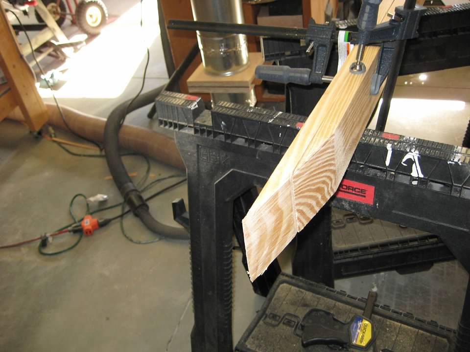

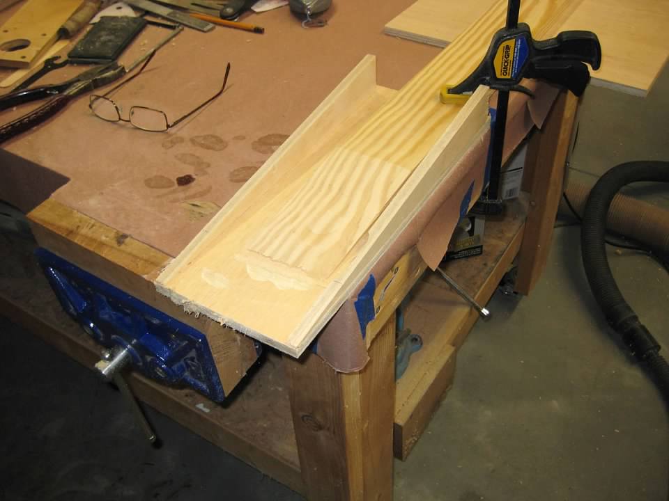

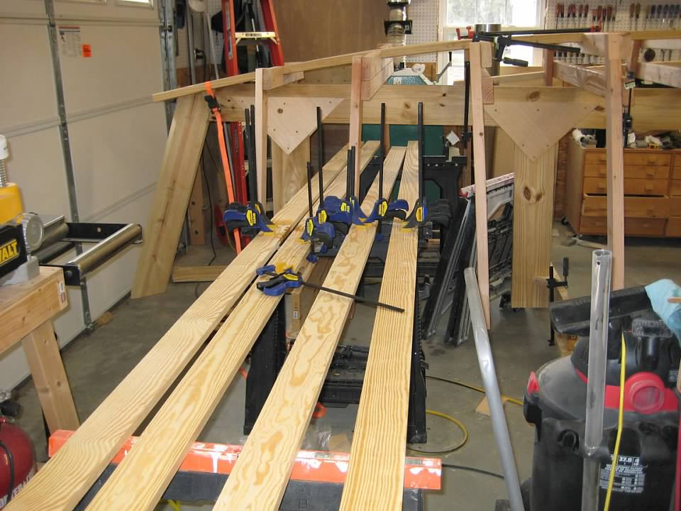

Next step is to install the chine logs and the sheer clamps. These boards need to be over 20 feet long to wrap around the edges of the boat. I had to scarf two 12' yellow pine 1Ă—4' s together to get that length. This was my first attempt at a scarf joint. I drew the angle on the two boards.

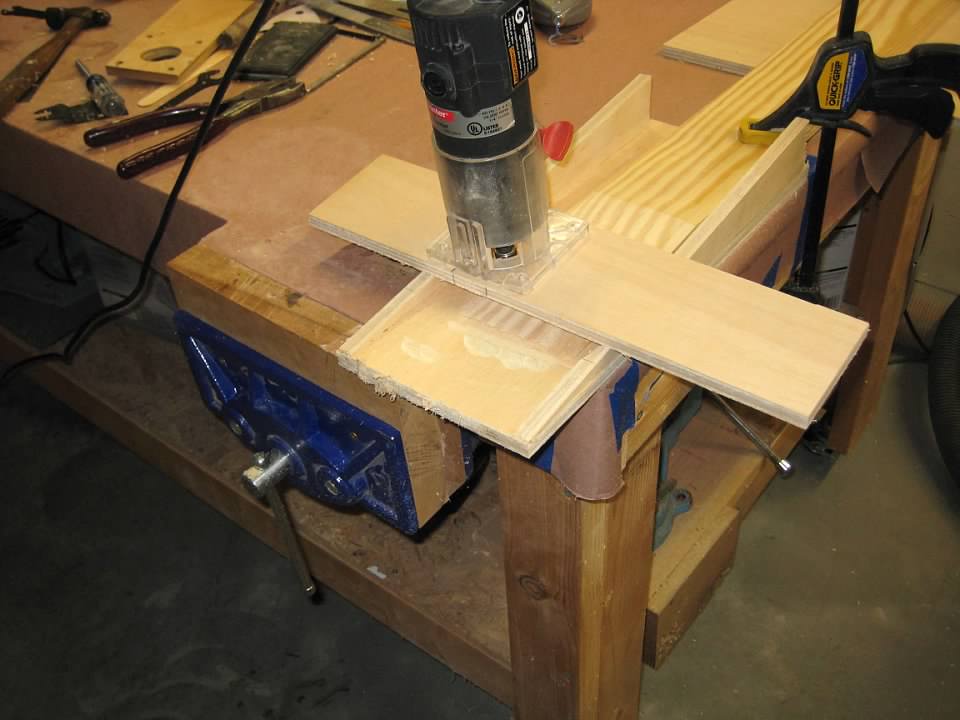

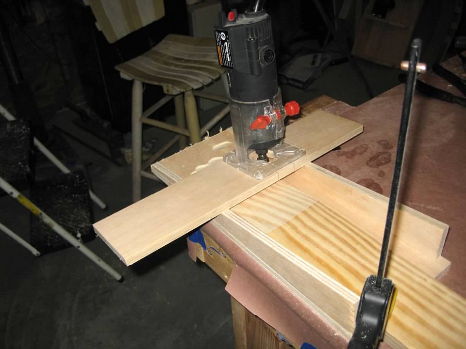

Then I cut both boards at the same time with a Japanese pull saw.
When I was finished I realized that the taper was only 4 times the width of the board instead of the required 8 times.
So I built a jig with a 8 times taper.
I added a board to the bottom of my trim router and used a pattern bit to rout out the taper.
I cut all 8 board for my 4 scarf joints.
Then I put the boards on saw horses and epoxied the scarf joints.
They looked good but I learned another lesson. These are end joints. They wicked up all of the epoxy I put on the joints and the joints failed miserably. I sanded the joints smooth and reapplied the epoxy, letting it soak up all it wanted. Then I re-clamped very lightly and they held this time.

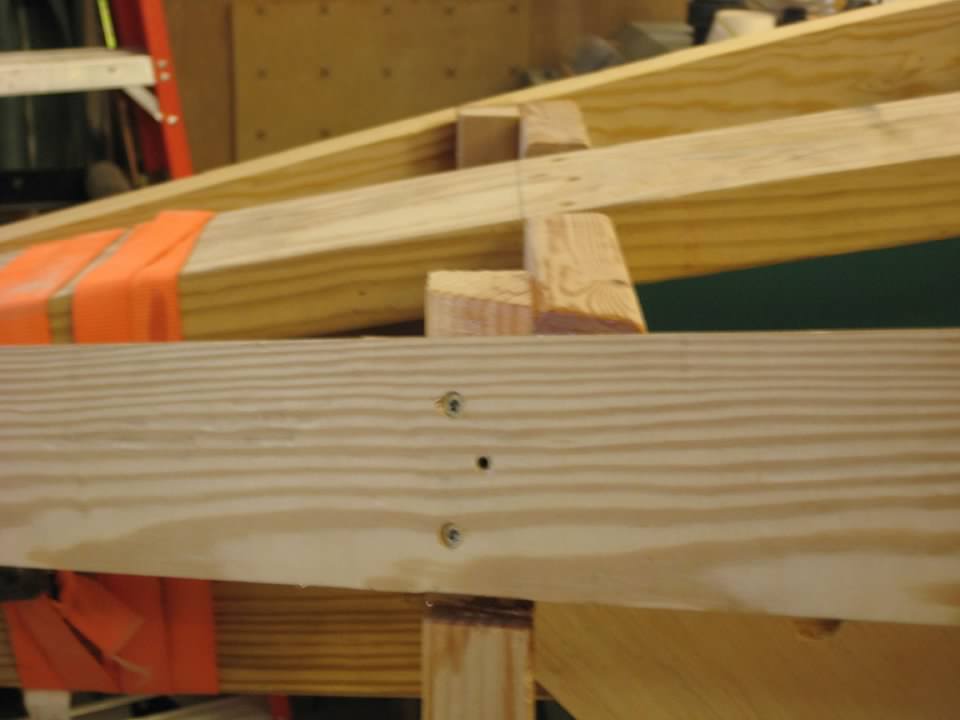

Next I had to cut the slots in the transom and the frames for the chine log. These cuts were done by hand with the pull saw, then I sanded and fitted each so the cut angle matched the lines of the boat.
Here a picture of one of the chine logs fitted and ready for epoxy.
Another picture of the fitted chine log not epoxied.

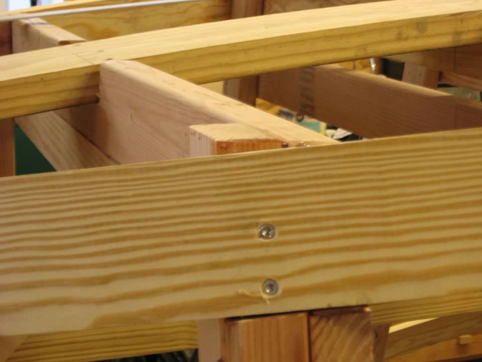

Next I installed the chine log, with epoxy and held in place by 2 #10Ă—3" SS deck screws at each frame, transom and stem.
chine log install continued
Both chine logs installed and epoxied.

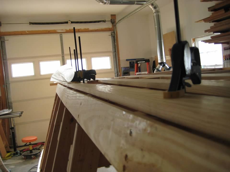

Next fit the sheer clamps. I prepared the slots for the sheer clamps the same as with the chine logs, only difference is the angle are greater due to the sweep of the beam of the boat.
The first sheer clamp board I started bending around the boat broke. The grain in the wood was not straight enough to handle the bend so the board you see on top of the boat is a new sheer clamp scarfed and curing.
I seem to take two steps forward then one or two back. but I am making progress. If I every build another boat I will know a lot more about how to do it.

Fairing the Frame

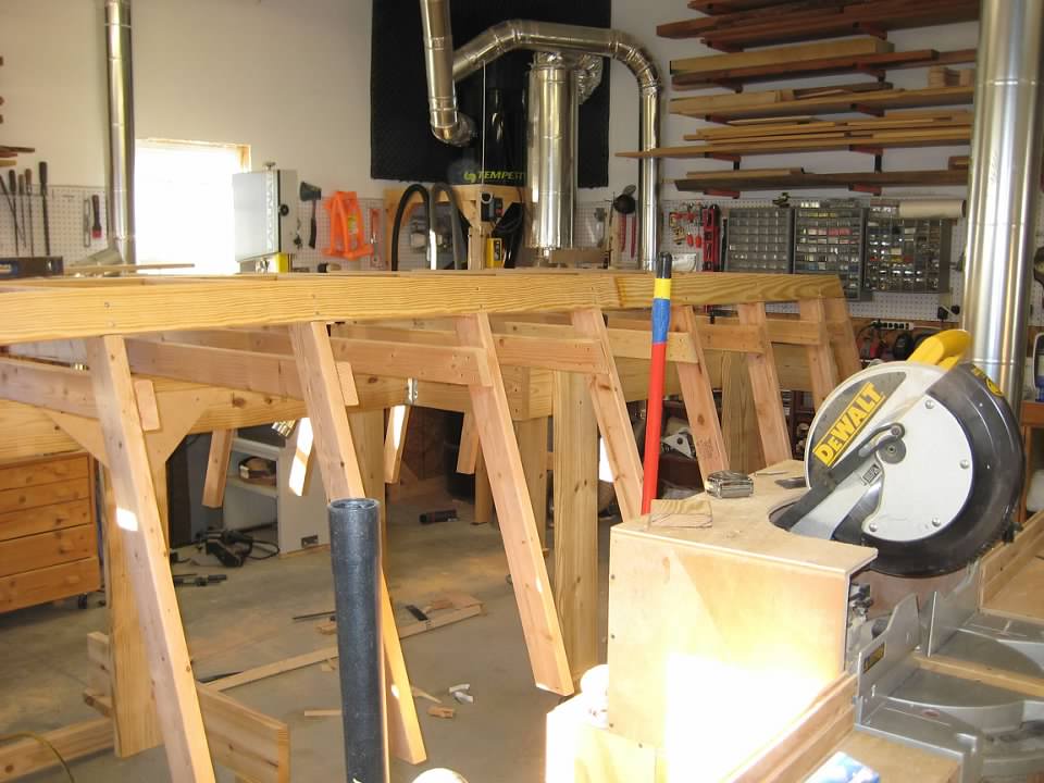

Now I have both Sheer Clamps installed and epoxied into the frame. That's the last frame member.
Frame is now complete!! All Frame pieces installed!! Frame Eleven is still a little off, I will have to fair it out.

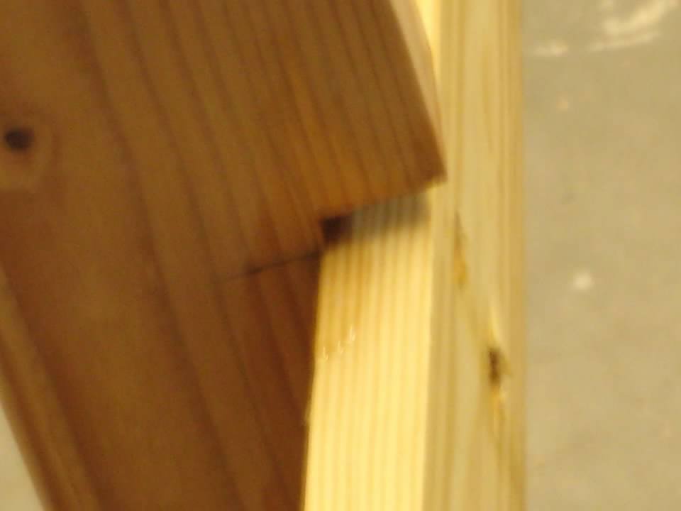

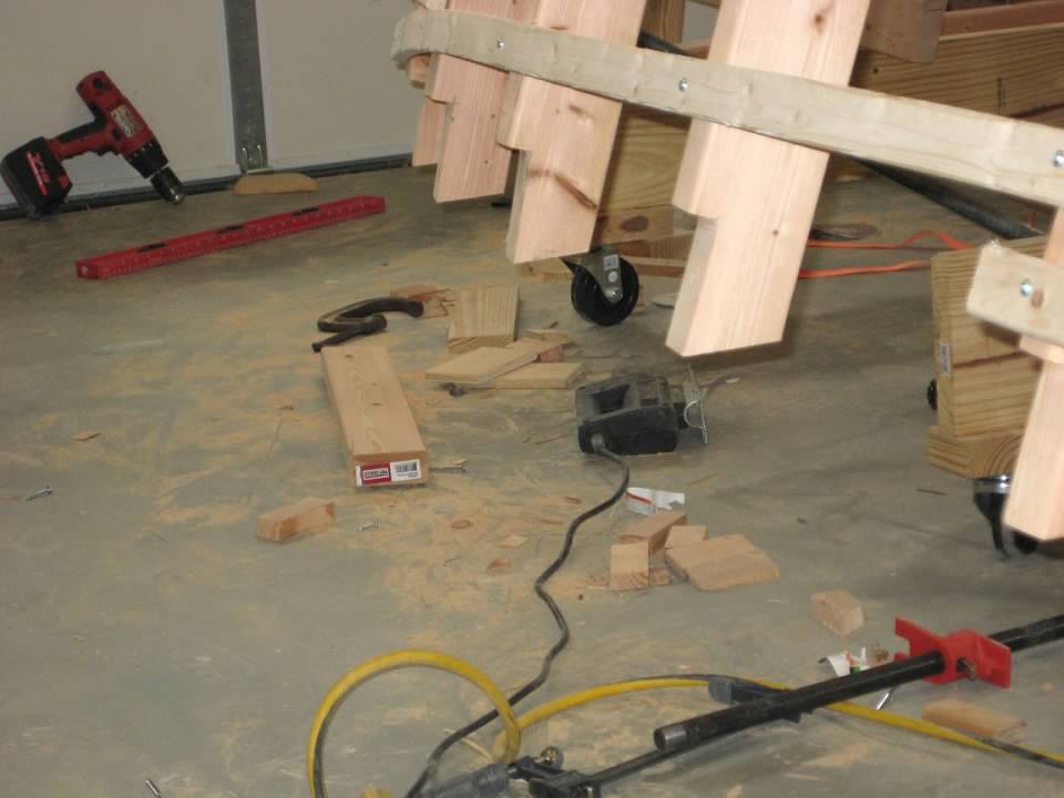

Along the way I made a few bad cuts. Here I cut too deep and at the wrong angle, So I made a shim 8" long and epoxied it in to correct the problem I made the shim 8" long and epoxied it to both the chine log and the frame. At 8" it won't split when the mounting screws goes through.
Shim from another angle..
Still another angle on the shim..

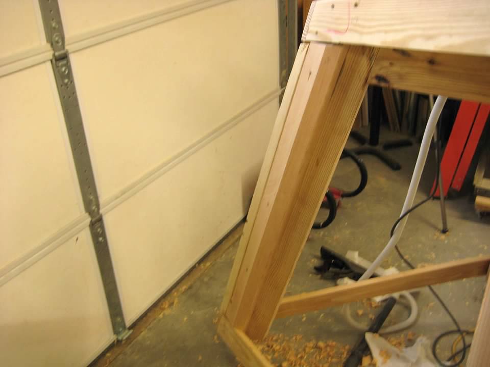

After I installed the first Sheer Clamp I opened the garage door stepped outside and noticed that the stem had been pulled to the starboard side by 2". So I used a pipe clamp and pulled it back. Then as I was installing the other Sheer Clamp I noticed that the first frame from the stem was collapsing under the pressure of the two Sheer Clamps. So I added a temporary brace to hold it out. I will have to put something permanent here when the boat is turned over to hold it out. the new brace will be part of the cabin framing.

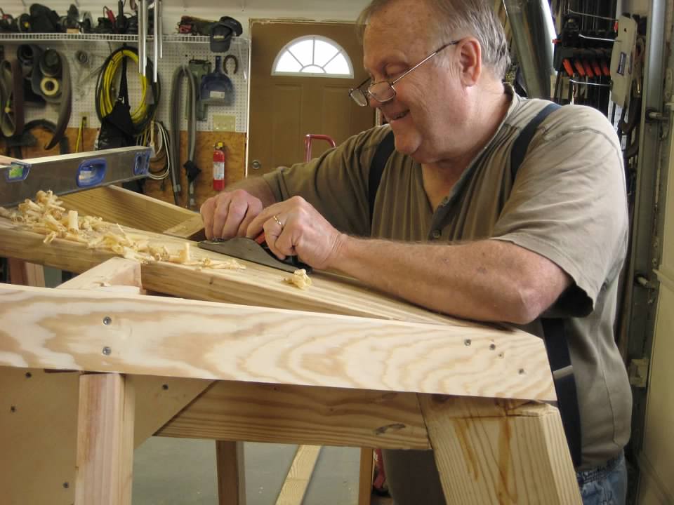

Now on to the fairing process.

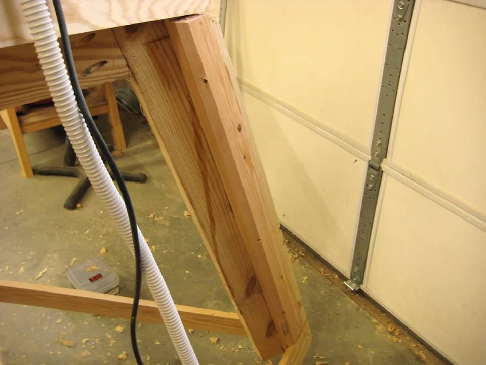

This will have to be faired off level with the keelson.
This also..
All of the side frames will be faired to match the angle the chine and sheer have as they pass the frame.
Fairing the side frames.
Fairing the keelson This board had a slight twist. I bought this board in one piece 24' and cut it to the 17' needed.
I added a 2" x 4" board to the side of the stem to give me more area to attach the plywood to at the stem. Most of this board was faired away.
A look at the stem with the new thickening boards from the front.

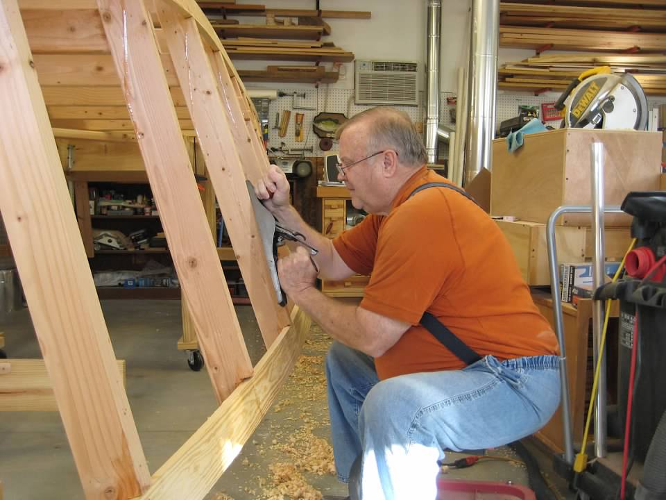

Fairing the side frames, I used several planes and sanders for this job.
Picture of a well faired side frame. The face of the frame matches the angle of the sheer clamp.
Another picture showing the side frame fairing.
Fairing is complete. I plan to go back now and add some thickened epoxy to fill in some of the bad cuts below the water line…
I mixed some thickened epoxy and went back and filled the bad cuts below the water line. This seals this end grain so if water gets in it will not soak it up so fast.
Thickened epoxy fills bad cuts. I used the saw dust in my shop vac separator from the fairing sanding to make the thickened epoxy.
I also filled the gaps on the new stem thickening boards with the thickened epoxy.
Frame Fairing is complete.. Next is plywood installation…
Here is a Video of the completed frame.

First sheet installed on the port side of the boat. The wet looking spot on the plywood is epoxy. I had a problem on this side too with splintering and cracking of the face veneer. I checked the fairing on this side before I started it was good. There appears to be a little more bend at frame 10 on this side. Looks like the chine log was weak at this frame and bent different than the one on the starboard side. The wet epoxy stopped the splintering immediately and once it cures it will strengthen the fiber of the wood so there will not be a problem.

A close up picture of the face veneer damage.

Plywood is sized about 1 " bigger than the transom. I put epoxy on both the plywood and the transom frame. Then clamped it in place and screwed it with #8Ă—1 1/2" Stainless Steel deck screws.
Transom Plywood is 5/8" Douglas Fir installed with epoxy and SS deck screws and trimmed to fit with a Router using a flush trim bit. The top in the picture was planed with a block plan to the angle needed to match the bottom of the boat.
This is the router and bit used to trim the transom.
Next I clamped a sheet of 1/2" Douglass Fir Marine Plywood to the frame Starting at the bow.
same sheet from another angle..
While the sheet was on the frame I got inside the frame and marked all of the frame members touching the sheet of plywood. I used a compass and marked the edge 1/2" larger than the frame and I cut the sheet by the outer lines.
When I installed the cut sheet of plywood to the frame and started clamping down tight. The face veneer started splintering, cracking and popping. I almost panicked. I PM'ed Paul (Shipwright) We discussed several solutions. When I went back to the shop, I did some investigating, After investigating I found that a 8" section of one of the frames exactly where the splintering was occurring was not faired correctly. This picture shows the issue. The ruler is the plane the plywood will be in.
Here the first sheet is put back on the frame to test fit after the fairing is corrected.
This is the same panel, the two 2" x 4" x 8' board are used to flatten the sheet of plywood, it was bowed due to the compound bends.
The starboard side of the boat with all three sheets of plywood test fitted and ready for epoxy and screws.
The first side with the plywood epoxied and screwed in place.

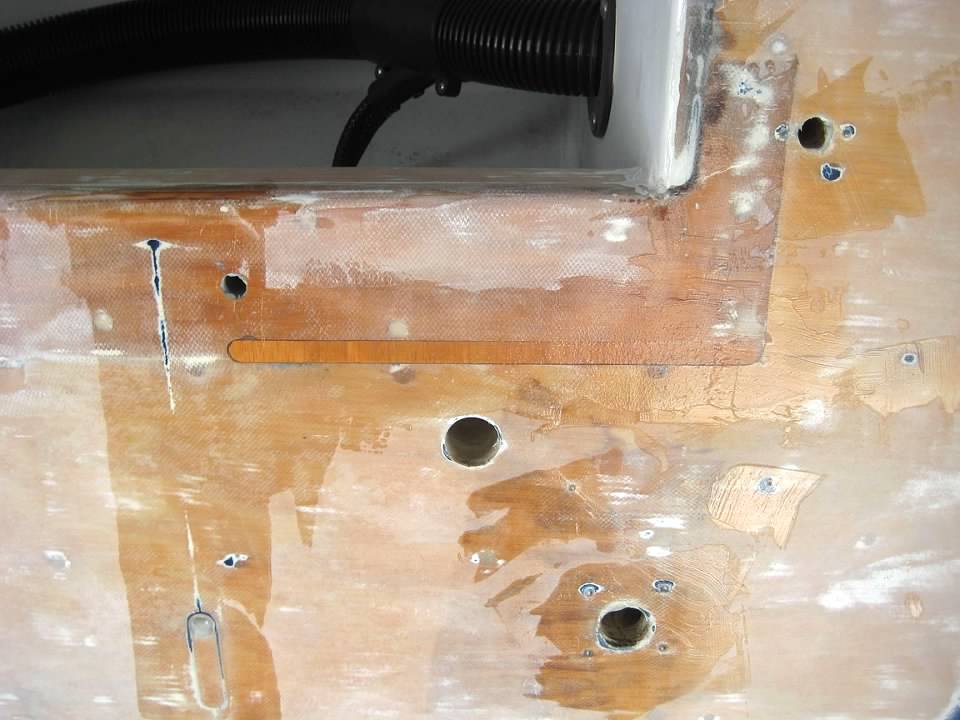

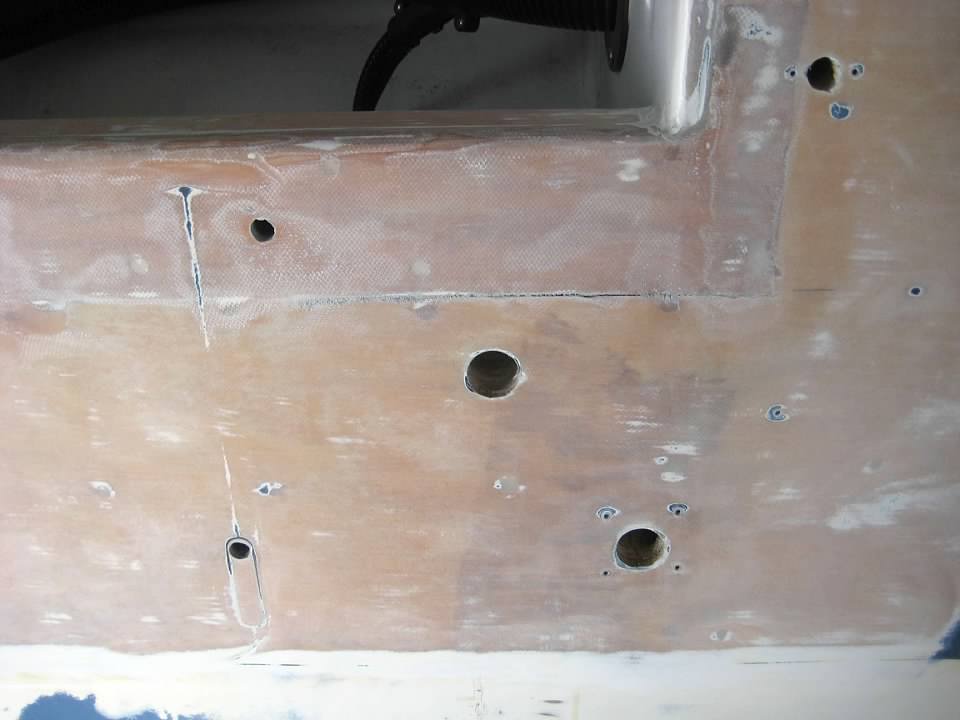

I want to thank Paul (shipwright) for all his support on this project. It is so great that this community provides access to so much support for it's member by the members. Thanks again Paul.
Here is a look at the beginning of a butt joint for splicing two sheets of plywood together. The backer plywood is the same thickness and 6" wide. It is epoxied and screwed in place.
I noticed after I had finished installing the plywood on the starboard side of the boat that I had inadvertently pulled the frame out of level while installing the plywood. The front of the boat from frame 9 forward twisted and was about 1" out of level. When I installed the first sheet of plywood on the port side I used three pipe clamps and pulled the frame back to level and the first sheet of plywood is holding it there.
Second and third sheet of plywood installed on the port side.
A look from the front with all side plywood installed. Now I have to trim these sheets and get ready to put the bottom on the boat. You may have noticed that the sides of this boat are very tall. They average 40". This boat is designed to handle surf launches and recoveries. The high sides will keep the surf out. The boat will also have a self bailing deck.
On the next segment I will be fairing the side plywood even with the top of the chine logs to get ready for bottom planking and installing the bottom plywood planking.
Thanks for looking.

Next we have to trim the side panel down and fair them even with the top of the chine logs. I used a router with a flush trim bit to get the sides down to the small lip you see in this picture.
Here I am using a side grinder with 36 grit paper to make quick work of the fairing. I ran my dust collector with 3 - 6" ports open to the room and my overhead air cleaner and the dust didn't get too bad. I will have a job cleaning the shop after this project.
This side has been faired and is ready for the bottom plywood.

Here the tops of the sides have been routed even with the shear clamp.
The next task is to get the foredeck and the gunwales installed. Here I have installed a support at frame Eleven to support the foredeck. I added a little bow to help water to run off.
I am adding supports for the Gunwales and the Inwales. I have installed these so that the Gunwale will be tilted out of the boat forward of the cabin and pilot house the flat in the open area back aft.
Every one of these supports has a compound angle, and everyone is different. There are 22 of them.
The Inwales are installed and a scarf joint is glued up on the boat.
The front wall of the cabin is installed slightly rounded
I was able to route off the excess plywood from the top but had to use a hand saw for the sides.
The top support is rounded both to the front plywood and for the roof plywood.
Next I built the wall between the cabin and pilot house.
Before the roof is installed I ruffed in the cabin Berth and Head. Most of the covers will have hinges installed and the area under the berth will be enclosed will Luan Plywood and used for storage. The berth is 6' 3" long.
We are going to use a Porta Potty for our Head.
Cabin top side supports have been dadoed into the cabin walls, the center supports will hold a cabin hatch and still need to be dadoed into the cabin walls.

Since my last update. I have added a coat of epoxy to the inside of the boat and two coats of Rustoleum Marine paint. This wore me out. The epoxy can't be sprayed so you have to use brushes and rollers. Working on the inside is much harder on the old body, I don't work well on these old knee replacements.

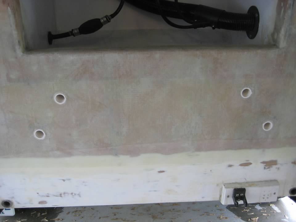

When I got ready to drill my transom for the Yamaha Motor I have purchased I found that the 20" motor was actually 21.1" measured straight down from the transom notch to the floor. I had set the notch height based on 20" at the 14 degree angle of the transom. So I need to raise the notch. Here I have milled out 3 1/2" of the 2Ă—4 structure to make room for a new 2Ă—4 support for the transom.
I added the 2Ă—4 all the way across the transom, using thickened epoxy to fill in the area under the 2 x 4 to the transom, then I routed out the plywood 1 1/2" wider than the new notch opening and 1 1/2" down on the 2Ă—8 on the transom. This allowed me to install a new plywood panel that over lapped the new and the old structure.

Its time to install the Bow Eye. Here in this picture you can see where I bored through the plywood and glass from inside, The holes in the stem were drilled on the drill press before I installed the stem to the frame.
I have a had a time locating a bow eye that was long enough the reach through my stem. The stem is a 2Ă—8 with two layers of 3/4" plywood lapped over the stem. This makes for an almost 9" thick stem. Standard bow eyes are 4" to 6 ". After searching the internet for months I finally ran across a bow eye from a company in Fort Wayne, but they only sold wholesale. I put in a PM to our fellow Lumberjock Bob Current. Bob was able to aquire the Bow eye and shipped it to me. Thanks Bob!!!
As you can see this is a long Bow Eye
The bow eye front plate was wider than the rounded front of the boat.
I marked the area that needed to be changed.
Here is the area after it was flattened and then Fiber-glassed with two layers of fiberglass.

For the rub rail I purchased Quartersawn White Oak. The boards were 10 feet long, My jointer is only a 4' bed machine. So to straight line these long boards I used a long straight edge and sawed it with my skill saw to get 2 long board half's with straight edges.
I then routed scarf joints on three lengths of white oak then I glued up the scarf joints with PL Premium Adhesive. I used long construction levels and clamps to hold the boards straight as the scarf joints are clamped.

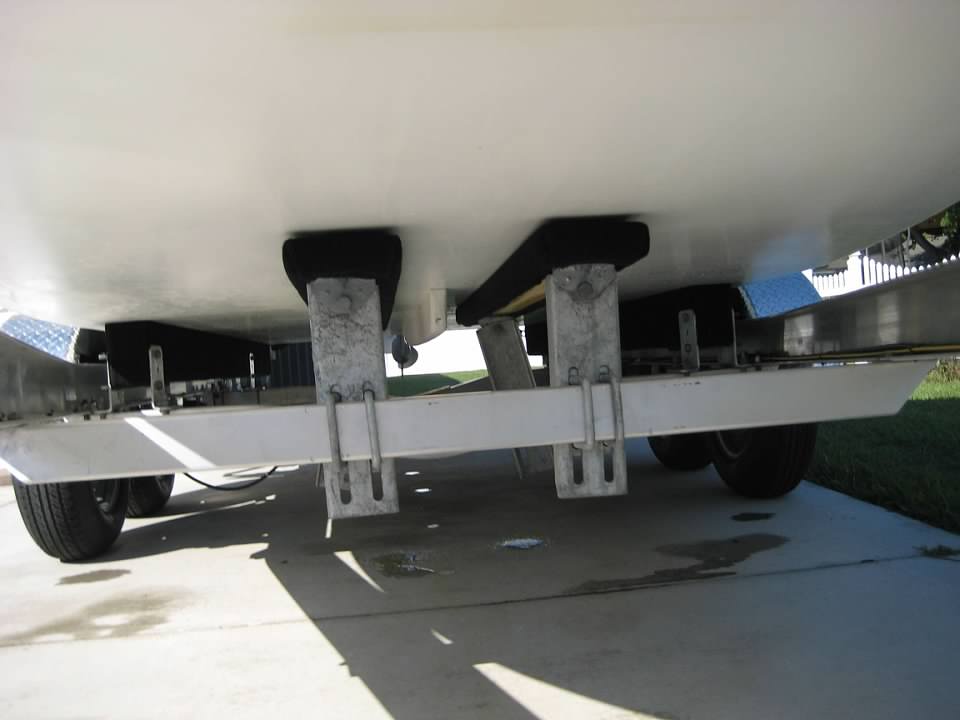

After finishing the boat I then had to get it on the trailer, After consulting with Bob Current about the rigging for the move of the boat I built a cradle to support the front of the boat. Then with the help of several of my neighbors we move the boat outside with ease.
We only moved the boat out until the pilot house cleared the shop roof overhang. Then I started jacking the boat. I used 4Ă—4 lumber for cribbing and raised the boat 25".
After the boat was up to 25" I moved the trailer into position, hooked the trailer winch to the boat. Installed two jacks to support the back of the trailer and winched the boat onto the trailer.
I then took the boat to the dealer and had the Yamaha 70 hp motor installed. The dealer and I took the boat to the water and tested the engine. It reached 29 MPH at 6200 RPMs and fuel usage was 5.5 MPG. at 4000 RPM we moved 12 MPH with 7.2 MPG.

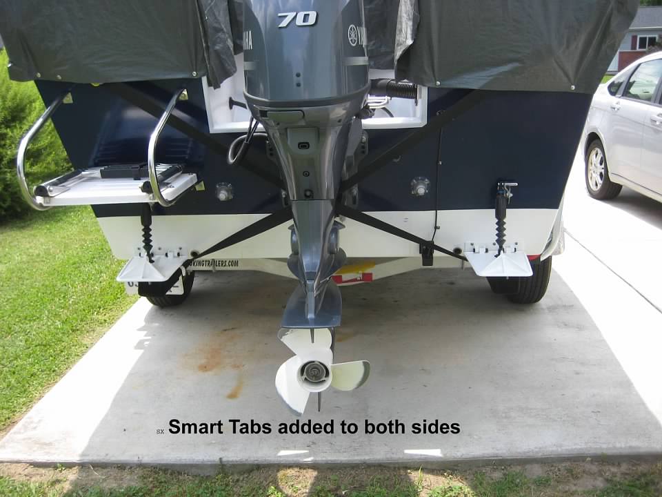

#129 · (Edited)
Perfomance Update.

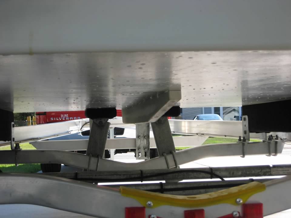

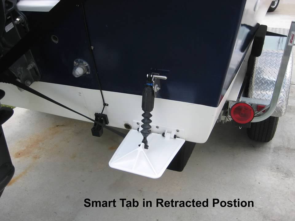

I wanted to update my blog to let folks know that I had performance issues with my flat bottom designed boat. I believe I caused the issue by adding so much weight forward in the cabin and pilot house. The boat had a real control issue. It would not steer well at low speeds. The boat would just seem to slide sideways instead of turning. In reverse there was no control at all. The front of the boat would fish tail back and forth banging the dock on the way out of the ramp.
I contacted the hull designer, Jeff Spira of Spira International Inc., and discussed the issue with him. He recommended that I add a strake down the center on the hull bottom. He suggested a 1Ă—4 - 6 feet long mounted on it's edge, starting at the transom running forward 6 feet. After discussions with him on how to mount the strake (I call it a Keel) we decided on a 2Ă—4 - 6 feet long on it's edge, and due to possible cavitation with the motor it was moved forward starting 3 feet from the transom.
I discussed how to mount the piece with Jeff and with several other folks. I was first looking at a piece of white oak for the job, planning on epoxying it to the bottom and fiber-glassing it for durability. Jeff told me he would not epoxy or Fiberglass the piece. He said that I would be changing it from time to time due to wear.
It was recommended by the Dealer at my local Yamaha store that I use a structural plastic 2Ă—4 for this job. I found one available locally, I purchased it and made my "keel". The front is rounded and the aft end is tapered back to 1".
I then installed it to the bottom of the boat using Stainless steel #14Ă—5" structural screws that I ordered online. I put a screw every 8" down the length of the Keel, sealed it to the bottom with 3M 5200 adhesive sealant.
I took the boat out today and it performed great. Backing out of the ramp was perfectly straight. Turning at slow speed works great now and turning at higher speed is much improved. The difference is like night and day. I actually felt like I was in control of the boat today.
Here is a video of the performance testing. The boat is riding a little high and I plan to work on that. If I get it fixed I will update the blog.
I did go back and look into the reason for the high bow on plane, and decided that I needed trim tabs to bring the bow down, I decided to give the Nauticus Smart tabs a try. If they work I would not need any more controls.
They worked better than I had expected. They not only brought the bow down but they shortened hole shot and let you handle wakes much better.

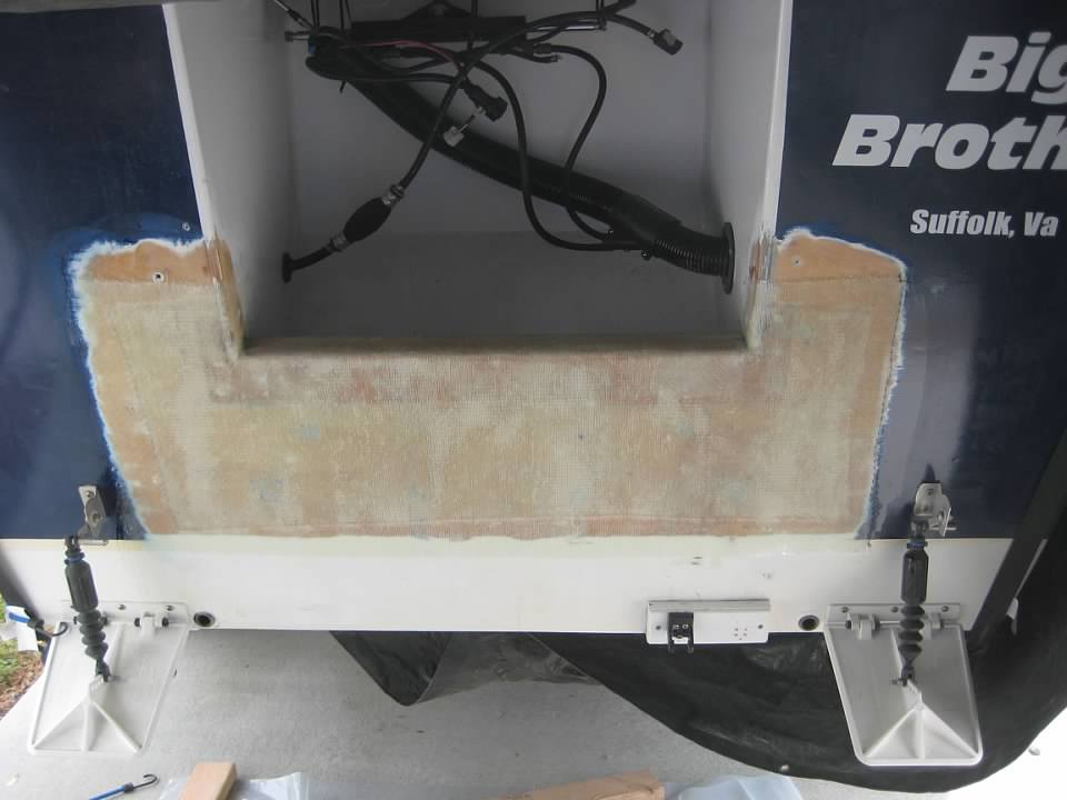

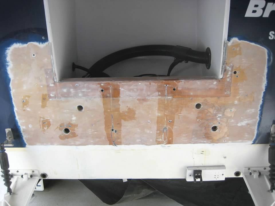

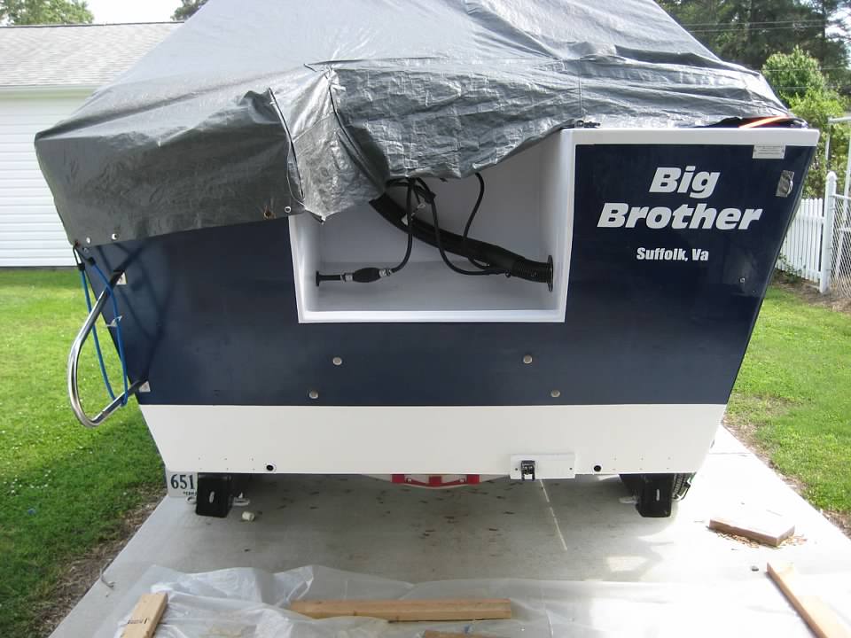

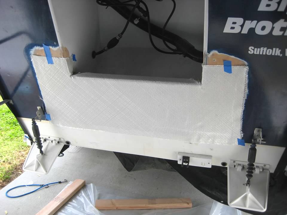

Crack in Fiberglass on Transom
Over the summer last year I noticed a crack developing beside my outboard on the transom.
The crack is where a butt splice was on the transom when I originally built the boat. I had built the transom for a 20" motor and when I received the motor it needed 21 3/4" to get the cavitation plate even with the bottom of the hull.
I considered several options for the repair. I considered removing the plywood off the entire transom, removing the 2×4 and the 2×8 and replacing them with a 2×12, installing new plywood, glass and repainting. I considered just adding a ½" marine plywood layer over the transom, glass, and repainting. I considered milling out the original patch and replacing it with a new patch that covers 3 more inches of the 2×8, re-glass, repaint. Not wanting to do this repair but once. I contacted fellow Lumberjock Shipwright. Paul thought the options I was considering, though effective, were a bit extreme. He recommended a very simple repair, to sand off the area around the problem and re-glass with a couple of layers of bi-axial or if I could find it tri-axial cloth. Make the patch a good six inches or more past the motor contact areas in all directions and make sure it more than covers the crack. Run a router down the crack at 5/8" depth to get to clean, dry wood and epoxy a spline in first just to seal the crack. So this was the method I chose to follow.
Here I have removed the motor, and sanded down to the epoxy.
There are 4 drain tubes in the area to be covered with Tri-axial fiberglass, so they will have to be replaced.
The crack can be seen here in the fiberglass.
I routed out the crack with a 1/2" router bit 5/8" deep which is the thickness of the marine plywood on the transom.
I installed 2 layers of 23 oz. Tri-axial fiberglass, this is the first layer.
After the first layer was wet out with epoxy, I put on the second layer overlapping the first into the wet epoxy.
Then after 5 or 6 coats of epoxy to fill the weave I finally got the repair area smooth.
Next I have to replace the drain tubes. The original ones were brass with flared ends. I never had a good feeling about the flared ends on the brass tubes, so this time I went back with PVC. Paul had recommended Using ABS pipe and sanding the outside with 80 grit. ABS is not available down here in the south smaller than 2" So after finding information on a West Systems web page on how to install PVC with epoxy I went with 1" sch 40 PVC, I first filled the old holes after the brass was removed with thickened epoxy. Then I drilled a 1 3/8" hole for the tube, but before the hole saw came out the far side I changed over to a 1 1/2" hole saw and drilled in 1/4" from each side. The 1 3/8" hole keeps the pipe in the center of the 1 1/2" opening to allow epoxy to get in all the way around the pipe to insure a positive seal. Here is my test hole in a 2Ă—4 .
All of the tubes were installed using this method.
Then the boat was taped off and the three different paints were used to repaint the transom and the splash well.
At this point I just need to reinstall my motor, swim platform, depth transducer, and Smart Tabs. Then the boat will be ready for the water. I plan to let the paint cure for a few days before I re-install the motor.
I plan to install vibration isolation pads between the motor and the transom when I re-install the motor.
A big thanks to Paul (shipwright), thanks for saving me a lot of work and for teaching me new methods.
That's what is so great about Lumberjocks, So much talent and so many people who want to share the knowledge.
Thanks for Looking!!
You're welcome John. I hope it works out well for you. It should be a very strong repair.
