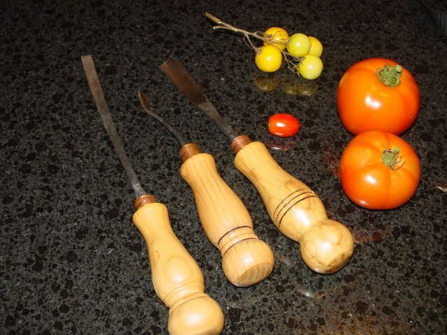

One item that over the years I keep making over and over are various carving chisels. They are a quick project, the material cost is very modest and they look good and it is satisfying to use chisels you made yourself. Because they are made iexpensively its easy to treat yourself to a variety of fishtail styles and widths that if your budget is tight you might be reluctant to buy store bought (but once you start using them are really handy).
Easiest to find scrap metal that gives good heat treat that I have found are various coil springs . Over years I have accumulated lots of old coil springs from various applications in various sizes 1/8" (ordinary wind up coil spring from garage door) up to 5/8" diameter (some sprt of truck spring…the older are easier the newer ones have plastic coating that is a pain to get off).
One spring that is especially convenient for gouge style carving chisels is approx 3/8" diameter and the coil is maybe 6" x 48" long ( ...it came out of an industrial overhead door) . You can forge these with a actelylene torch but its easier cheaper and more convenient if you put together a simple propane forge. Handes are typically turned from something grabbed from wood pile (burning logs) and the ferrule is usually short section of copper pipe.
