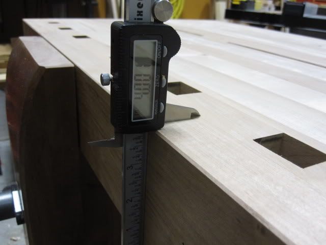

Chris, I am right there with you. Last night I took the wife and the family out to dinner for her birthday. About 10 PM i thought that I would play around with a raking light and a straight edge just to see if a could mark the high spots on the bench top.
Of course, I had to tune up the winding sticks to check for twist.
Well, I completely got caught up the process. I finally looked at the clock and it was 1 AM. I had completely flattened the top, re chamfered the edges, re countersunk the dog holes, chamfered the squared dog holes and tool holder with a chisel and rasp.

Ha, I just saw the picture you posted. You cant get much more precise than that!
Mauricio, you have described one of my favorite reasons for my love of handtools. Flattening a benchtop by hand does not take that long, especially on repeat flattenings. No jigs to make/store; just shavings on the floor and work to be done.
Wait… wait… how do we know that Scotty didn't fudge that measurement. We don't see the bottom of that caliper…..
JUST KIDDING!!!!!!!!!!!!!!!!!!!!!!!!
As awesome as that bench is, you probably have that thing flattened to .00000000000000000001" across the whole length.
I also like the nice even chamfer on that edge too.
