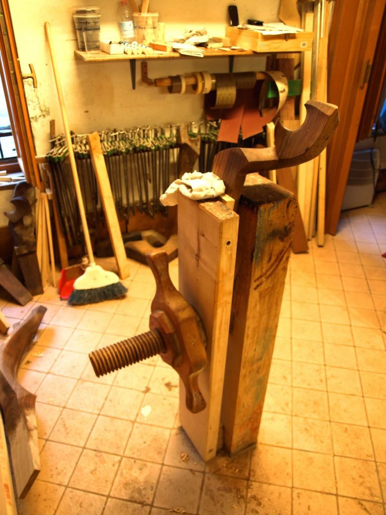

So I was reading the latest issue of WoodenBoat magazine and there was an article about gondolas. They are fascinating in their own right but one of the photos shows a man carving a "forcole" that is the arm that holds the oar and is the fulcrum that they push against. I have been intrigued by them for years but never thought about how the were made. Check out this vise.

Yea I thought of you Mauricio, the photo I wanted to show was neat in that the end of the screw was turned like a finial, the threads didn't just end. Actually if you google "forcola" and click on images you will find what I wanted to share. That is the great thing about these forums (this one in particular) so many like minded people with different backgrounds and resources accessing areas other people might not go. I've also got a lot of those old gems like on the Schwarts blog. Too bad the vise thread I tried to start lost steam. I'll pull a couple out later. One is from 1929 I believe and they are complaining about the pin in the leg vise and how to get around it. Some things never change.
Here is one of the photos. I guess when you put all the mass of a bench into the vise that is all you need. I wonder how far the main post goes into the floor?
Here is the one I was thinking about.

Freestanding wooden-screwed leg vise. Phenomenal!

I like that giant wing nut on the screw, I see what you mean about the little dome on the end of the screw, looks nice, I'll have to do that on my next one, I already removed the spur marks form my screw so I can't put it back on the lathe.
I googled Focola, amazing stuff, I love how it's a functional work of art. I've been to Venice, before I was a woodworker, wish I would have paid more attention.
Now I need one of those and I don't own a boat. I just love seeing woodbodies at work. I love that he chose those. Much respect.
