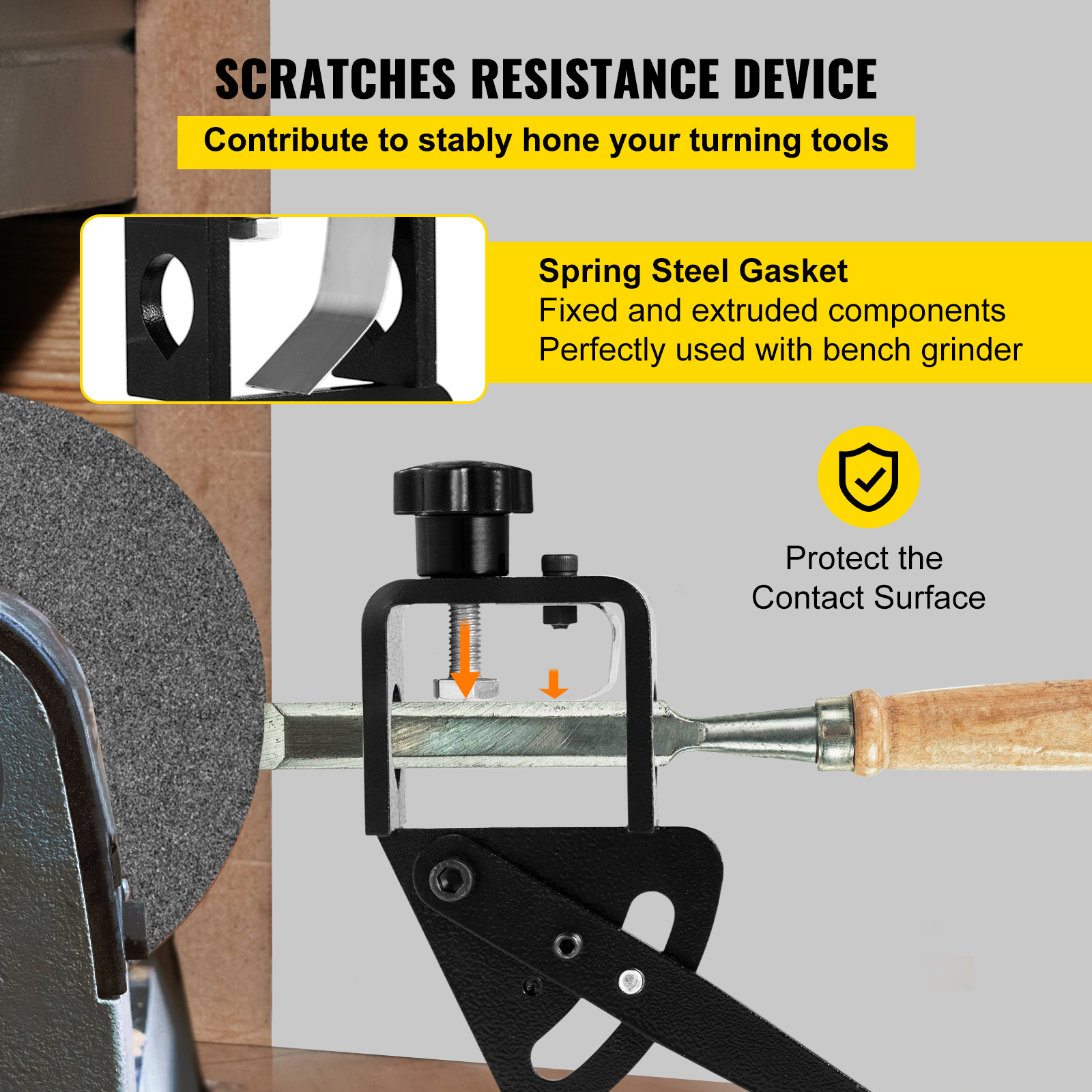

One thing that appears to be different is the bolt head that locks the gouge into the jig. The Wolverine has a rubber pad there and it may also have a socket that prevents the head from turning when you tighten it. A spinning head may make it slightly more difficult to prevent the gouge for moving as you lock it down and the pad keeps if from denting or marring the gouge. They appear to have added a piece of sheet metal so maybe that is not a big deal?
But when their pictures do not even show the correct way to use the jig, that makes me wonder if they ever tried it to see if it works. One of the pictures shows a bowl gouge mounted sideways and another bench chisel clamped in sideways and grinding blunt, curved tip. Really?
yea I kinda wondered what a chisel with that grind would be used for

The spring steel gasket as they call it was what the original Wolverine jig came with.
I have used one and I like it, but I understand they changed it because as you remove your freshly sharpened tool from the jig, It is very easy to damage the edge. When I bought mine 6 or 7 years ago already, the new style was already the only option.
