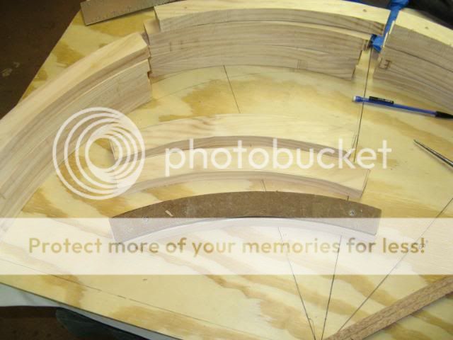

I built up the curved sections from multiple curved pieces of 3/4" lumber. Each curved piece is cut from a stock pine board, and layered up "brick syle" with non-overlapping seams to form one third of the skirt. The finished skirt height is (5×3/4") 3 3/4 inches high, a bit shorter than the original.
We start with a layout of the whole table, the semicircle, the two front legs at 60 degree spacing, and the skirt position. I made an MDF template for a section of skirt.
Three sections fit tightly on standard 6 inch lumber

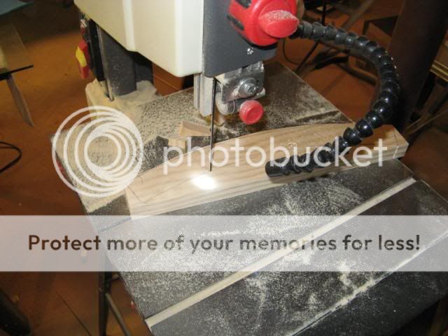

Rough cut them on the bandsaw

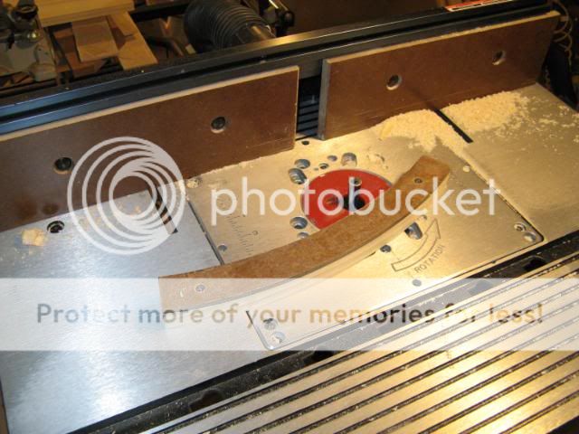

Screw the template on to a section.
Clean them up on the router table with a straight bearing guided bit.
