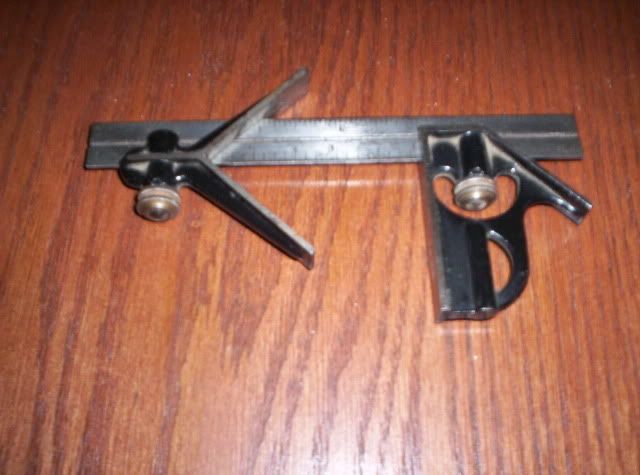

When I was growing up, my dad was a pattern maker at a steel foundry. A few years ago, he decided to have a yard sale and gave me first crack at his tool box. I don't know why I didn't take more, but one of the things I did get was this 6" Starrett.
The center finder works great for both square and dowels. I just wish I would have snagged this one's 12" brother with the protractor, but I didn't want to be greedy.
