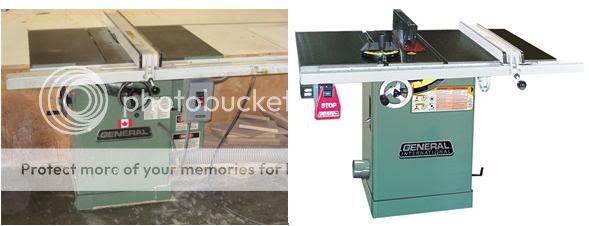

I was thinking the other day about the side of the table saw that the switch is on, my table saw at home has the switch located on the left side, out of the four we have at school (three Generals and one SawStop) two have the switch on the left and two have it on the right hand side. I prefer mine on the left as I am right handed and usually stand to the left of the blade. It seems like most of the saws today are putting the switch on the left. So now I am curious, what do you prefer, left or right?

If your right handed, then left is probably better, especially if you need to stop the saw in the middle of a cut. My Unisaw switch is on the right, and can be a little tricky to get to at times.

Proper table saw technique is stand on the LEFT OF THE SAW FACING THE FENCE at about 45 degree angle with your body. This puts your forces in a direction to keep the work against the fence. Standing on the right, causes you to pull the piece, and possibly reaching over the blade. Most people that are nervous stand on the right, then don't have the proper pressure and kickback happens. Standing on the right actually increases the risk of kickback. Either side proper hand placement, form, and flat straight lumber are the keys to reducing kickback.
by the way, my switches are on the left, at home and school, we moved the switches at school to make it a point to stand on the left for the students

Good point tooldad, never thought about that before. It makes you wonder why manufactures put the switch on the right side in the first place if it encourages improper use of the tool. I would like to see if we could get the switches moved in my school, shouldn't be hard because we have about 25 electricians in a class just upstairs, I bet they would just love to do that for a few cabinetmakers lol.
