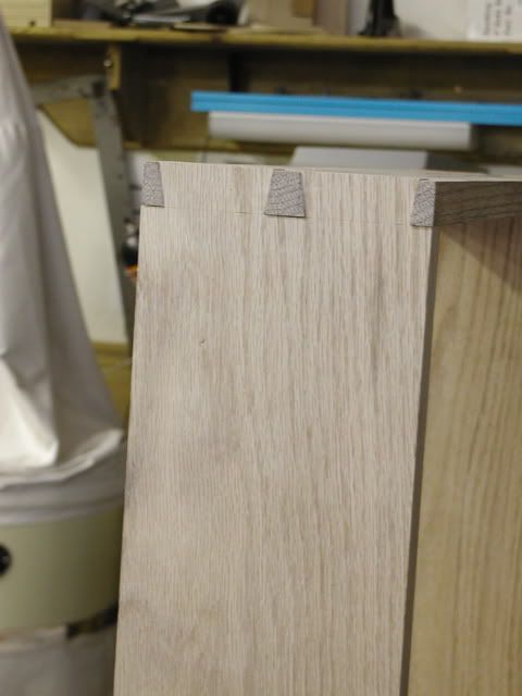

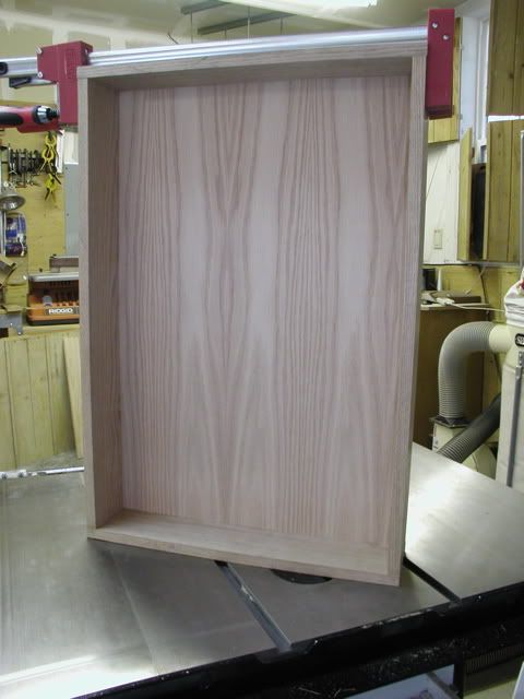

The beginning...
A friend at work collects shot glasses from all over the world and wanted a wall-hanging display cabinet to show them off. She asked me to build it for her out of oak to match her kitchen cabinets. Then she told me she has LOTS of glasses-probably 150 or more. We wrestled with some design issues, but decided on adjustable glass shelves rather than a lattice work type of grid for each glass. The case would have to be big and hold a lot of weight, so I decided that the case should be put together with dovetails for strength and mounted to the wall with a french cleat type of system. I didn't think even a splined miter joint would be a good idea, but may have gotten away with a locking rabbet joint (Opinions welcome…) Anyway, I went about the usual jointing/planing and cutting to size and then set off cutting the joints by hand-my first real attempt on a project after practicing on poplar scraps lying around the shop. After some nervous sawing and chiseling for what seemed like an eternity, they slipped together pretty well.
I dadoed in the back (1/4" ply) and so far so good. It is dry fit together so I've got my measurements for the overlay door.
More to folow.

Those dovetails look great

All material 4/4 milled to 3/4. Back: 1/4 ply
Interior dimensions: 30"H x 20"W x 4"D
Exterior dimensions: 33"H x 23.375"W x 6.75"D (includes moulding)
Main carcass pieces: Top/Bottom: 21.5" x 5" Sides: 31.5×5"
Back is set in ~1" from the back (Ply thickness plus 3/4). This gives a 3/4" recess to bring the french cleat flush with the back edges. I thought about putting in a mirror as well. I decided on the wood back and interior lighting.
The main carcass is assembled as outlined in the blog. I went with dovetails for strength given the potential weight.
The door dimensions are: 29.75"H x 21.5"W
Once the main carcass with back was glued up, I glued a 3/4×3/4 strip to the front edge of the top and bottom to extend them. (that little exercise was due to a change in design on the fly…never a good idea). I installed the cleat in the back with glue and screws from the top. Then, I attached the top and bottom caps (hiding the screws) and applied the moulding (hiding the joinery details). The door is made with a raised panel router set, but could just as easily be done with grooves and stub tenons on the table saw.
Finish is General Finishes Arm-R-Seal wipe on poly (6 coats), then rubbed out with 0000 steel wool and wax.
I installed a battery operated LED lighting system in the top that is hidden by the door's upper rail. While the LED light is somewhat cold/blue, it is balanced out nicely by the warmth of the wood.
Hope that helps.
