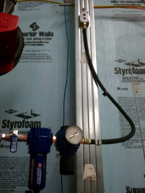

Mounting the manifold and getting it hooked up to the compressor was step #1.
I added a quick release to the end of the filter line before the lead-in hose but I didn't get a picture of it. The RapidAir instructions show the air line coming in to the end or the back and the out lines going out of the two holes on the front, but of course it's a manifold so you can use any hole for anything you want I chose this setup because it minimized the number to connections (elbows) I needed to use.

Next, it was time to install the air outlet in the shop. The fitting that screws into the back of the aluminum block extends about and inch. The wood on the side of the steps is 1 1/2" thick. I could have just drilled a 1" wide hole and everything would have fit fine, but I wouldn't have been able to get to the release ring if I needed to, so I drilled a 1 1/2" wide recess and then drilled the 1" all the way through. Then I just stuck the outlet into the hole and screwed it to the side of the stairs, cut the tuning to length (using the included cutter) and inserted in into the fitting. Done.
