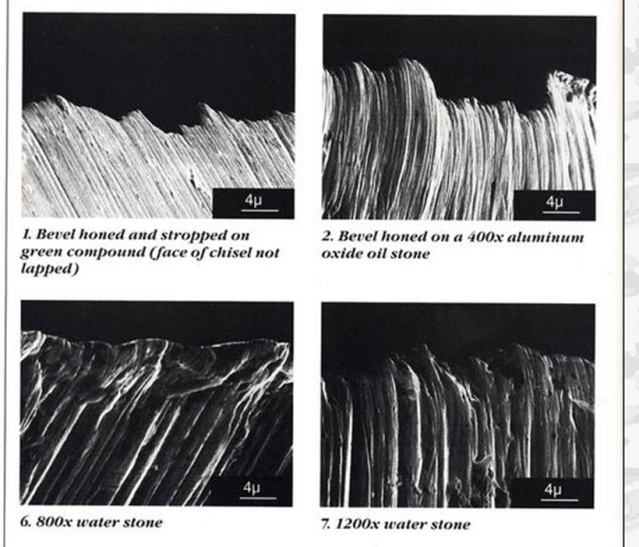

Dennis, Veritas claims that the average grit size is .5 micron which is around 10K grit. However since thats the average it means there are larger particles which help the compound cut faster. There is no telling what the largest grit sizes are.
But like Mads says this is a great way to touch up your blades in between honings.

On this strop I left the other side with only the leather strop, this because some say you get the best result if you give the iron a tour on this after, personally I see no difference and use therefore only the compound side now.
(And read that in a microscope you could see absolutely no difference also if there were no compound).
And this was my first test, it worked really well, even the steel are quite hard on these Barco's.

I strop after i finish sharpening, but use just leather, no compound. At the point the process is meant to remove any final burr. I've tried with and without compound and not seen any difference. I leave the right on the jig if sharpening a plane iron.
When stropping in between the sharpenings like you describe the compound makes an improvement.

Mads - You know I love you, but I can't help thinking you're getting off too lightly here. I know you hesitated for while before you made your first strop because you were confused as to whether it should be smooth side or rough side up. I remember you telling me you went with the smooth side after seeing what barbers use. But…
You say "You want a quality [leather] that is relatively thick and hard, but not too stiff."
Joel over at Tools for Working Wood is selling stropping leather which is 'Genuine Horse Butt' which he says is the hardest leather he's seen.
Clifton sell soft chamois leather for use as a strop.
Some people just use compound on a piece of MDF.
Others say that if you finish honing on a Norton 8000 waterstone and ease up on the pressure at the end when removing the burr, stropping afterwards does not really add any benefit.
Some people say to condition the leather with a few drops of oil before applying the compound and others say the oil is not necessary.
So, I'm wondering whether the hardness of the leather AND whether you use it rough or smooth side up really makes much of a difference. If you are just dragging steel over leather a few times, I suspect it doesn't really.
What we really need is for someone to do side by side rough and smooth tests for each leather hardness with the same compound. Then put each of the chisels along with a chisel honed on a Norton 8000 waterstone into the hands of someone else to try and see which one they think is best.
Now who could we ask to do this test I wonder? :)

I agree but I say we need a Lumber Jock with a microscope! Any lab rats in the group that can do some testing for us?

Actually thats already been done by Leonord Lee in his book on sharpening:
However I dont think he coveres best surfaces for using as a strop.
