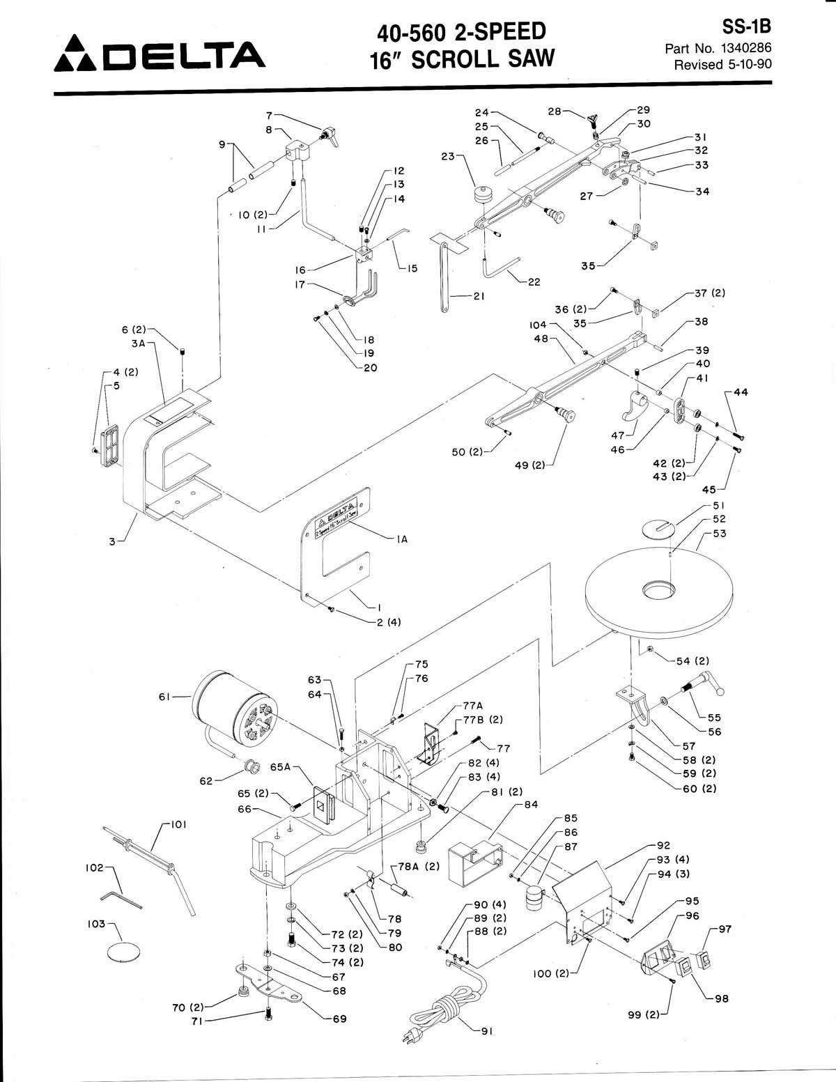

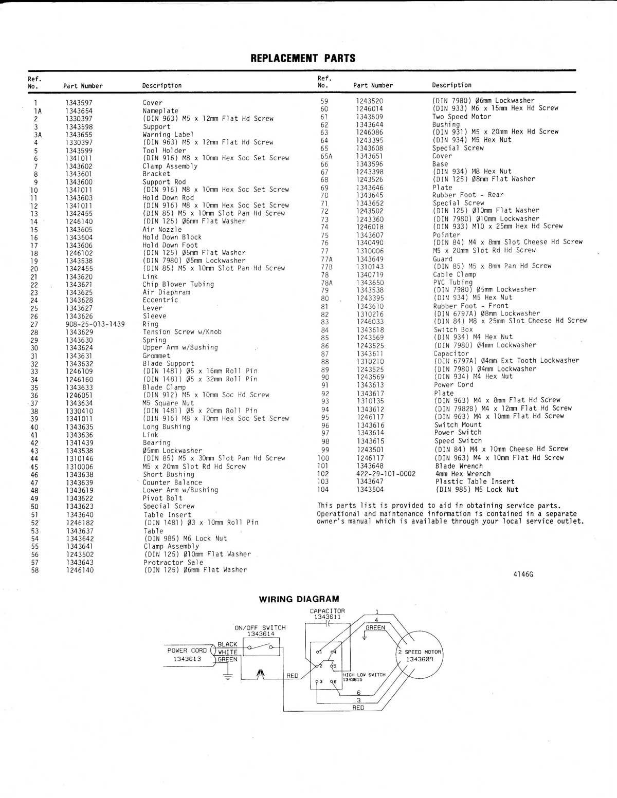

There is probably more danger to NOT having the blade tightened than leaving it tightened. Anyway, dug up all the old paperwork on mine and made a copy of the safety chart for you. I even found my receipt stapled to the Warranty envelope, dated 03/07/93. FYI, in 1993 it cost me $179.00 USD.

http://www.horizontalheavens.com/DeltaPartsListScrollSaw.jpg
http://www.horizontalheavens.com/DeltaGrenadeViewScrollSaw.jpg
