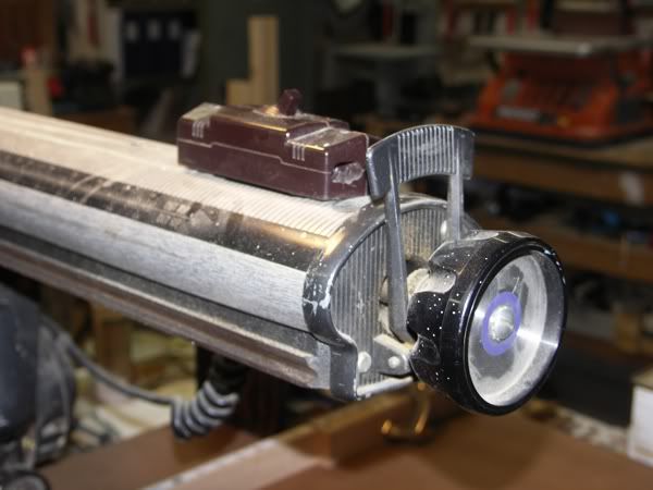

Do you want close ups of how I attached the left side switch on my BT? My switch has been moved to the far left side of the rails by the sliding miter table. I LOVE where that is, VERY easy for me to get to..
I know the exact idea won't work for non T slotted rails, but at least you can see what I used for brackets and boxes…

David,
More info the better. Have made the attachment to the Vega rails, but still have to do the switch tomorrow. Send it on…..................did you notice the double we had on drfixit…....I referred him to your website re the separator as you were saying the same thing….......HALLOWEEN…...for sure…..........
Yes, I want close ups….......

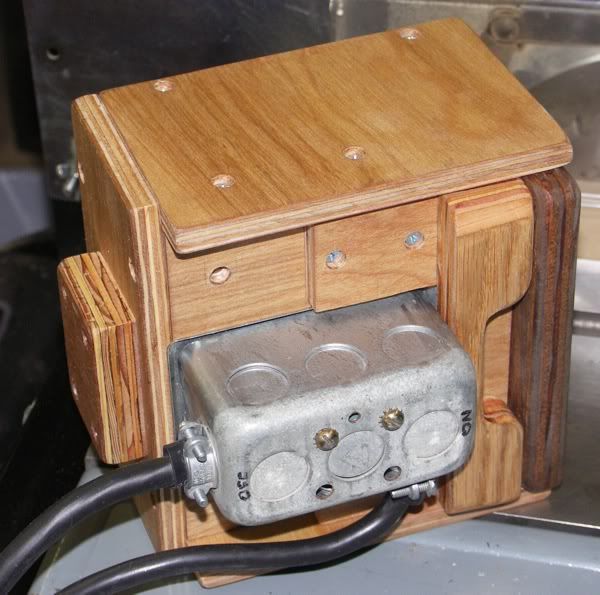

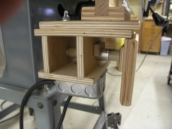

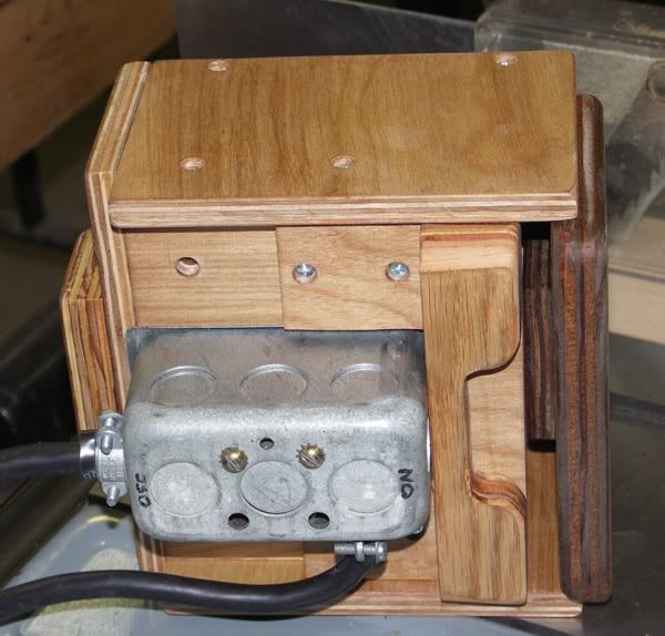

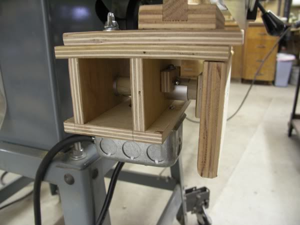

Nearly done with the table saw switch..........
I am nearly done with building my table saw switch mechanism using the original toggle switch. CHEAP, fun, and interesting. My rules are…. no new purchases allowed. Scrap box and odds-and-ends. Not done enough for pictures, lost a lot of time today for a variety of reasons, but did get some of the Sketchup stuff done, and got the mechanism to the point that a couple of hours will have it on the saw. The concept has been established in wood and a tiny bit of metal and works well. Mind you, this is just mechanics, not electricity. I am using the original toggle switch for the electrical part.
I will be posting Sketchup plans, photos etc.
So why do I do this silly stuff? Got it from my Dad. Great excuse. Bet a bunch of you out there have used that one….............
For instance:
My dad bought a new wringer washing machine, so he retrieved the motor from the old wringer washer. That was a long time ago, while I was in grade school. He used the motor to power a grinder, belt driven, for knives, axes, etc. Then he made it into an electric lawn mower with a wooden chassis that he built with hand tools, painted that chassis green. I used that to mow the lawn for about 5 years while growing up. Finally he bought a gas mower, so he made the lawn mower into a scrubbing machine for the floors at the department store he worked in. He found a better method for floor scrubbing, namely he and I using a sprayed on strong soap solution and mops, very effiecient, and I made some money. So the motor became a grinder again, that my brother used for about 20 or more years. That motor should be gold plated and immortalized…............... I think it had a 40 to 50 year life time of usefulness.
Nothing like old motors…......
So my toggle switch is soon to be encapsulated in wood, some aluminum tubing bearings for the dowel that moves the toggle (with a washer as a bearing surface), attached to my saw with some angle iron, oak, and plywood…...all, and I mean all, is from left overs and scrap…....CHEAP…...................................as long as you don't count my time, most of it spent in design…......
.......well, just one picture…...... Aren't pictures wonderful? Yeh, I like them too….......you can understand most anything you want to from pictures…....and a lot of things you don't want to understand too…......
This is the original toggle switch handle, now controlled by a dowel with a washer bearing. It is screwed with tiny screws to the dowel. There is a shallow hole in the dowel. The washer is inset into the dowel with a shallow depression created by a Forstner bit. Note the aluminum bearings. Still have some work to do with them. Actually, that is most of the work left. The mount to the saw is finished.
........tomorrow…..............and more pics!

4,279 Posts
Discussion Starter · #13 ·
A little progress on the table saw switch
Work has been interfering with my life again….rats. Got enuf time in the shop today to finish the bearings on the switch. They provide the sliding surface for the dowel that flips the switch.
The bearings, and stops now eliminate unwanted rotation, over depression, or over extension of the switch. Meaning, it you can't push it in too far, pull it out too far or somehow turn it…....all to avoid stressing the toggle switch. So just a little bit of plywood, the actual face that you actuate ( a 6" by 4" face ) which has to be actuated by hand or thigh, and then I am done. Really close.
Tomorrow is a lost day, work will consume it…....so to Friday…........
Darn, isn't work to blame for all the opportunities missed, people not met, projects not finished, life not fulfilled…......
But it supports the hobby…...........
Looking forward to seeing the finished product.

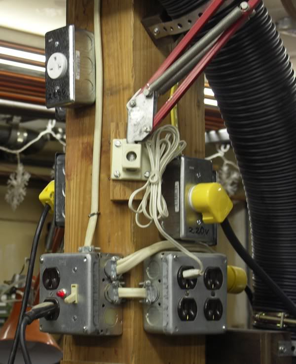

Mike:
I used to use a foot switch for my push-to-talk on ham radio, but I haven't seen them around in years. Sounds like an internet search to me.
4,871 Posts
Pretty easy.
ANY "momentary contact" switch (of high enough amperage capacity) will work. Think … car horn button (aftermarket, from auto parts stores), then screw it into a ramped wedge of a box.
