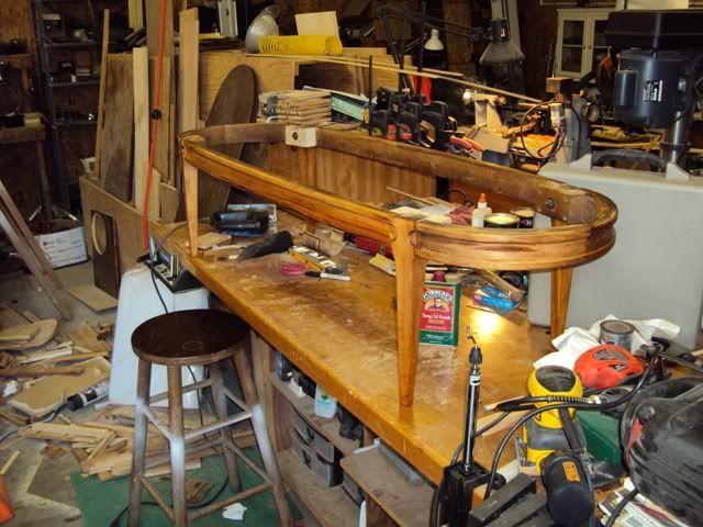

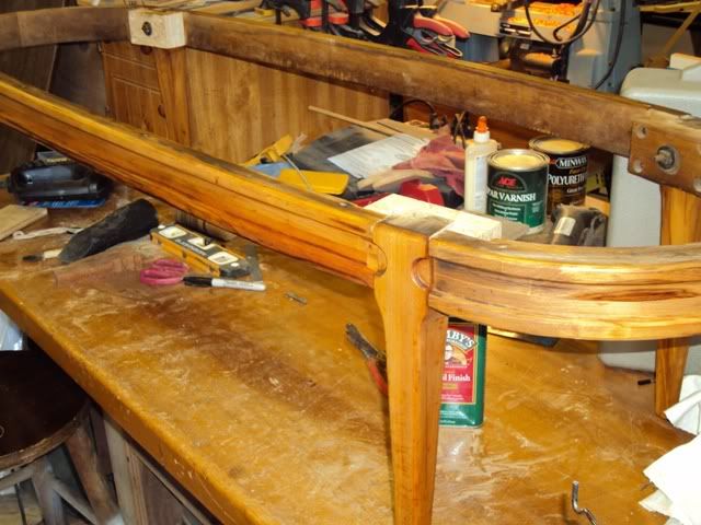

I am refinishing an old coffee table that I got where the top was all beat up as well as the apron and legs. Thought it might be something that could be salvaged. Here's the problem. I don't know what kind of wood was used in making it to start with. I've pretty much resigned myself to actually making a new top. I sanded down to bare wood the apron and legs. I put a coat of tung oil on it. I want it a little darker to match the other household furniture. The tung oil darkened it a little but not enough. Anybody have any ideas? Can I stain over the tung oil? What can I do. Her are a couple of pics as it is right now.

No idea on what kind of wood, kinda has the feel and weight of ash. The mess on the bench was cleaned up yesterday. I'm not a good house keeper. LOL. Can I stain over the tung oil?
326 Posts
Hi Telt,
I had luck once mixing a little bottom of the stain can pigment with tung oil over a repaired area (Water stain). Area already had tung oil finish on it, It just took and extra hour or so to dry. No promises but it worked once for me. Good luck, looks like a great project.
