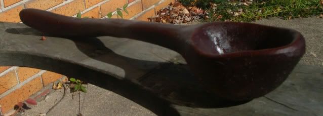

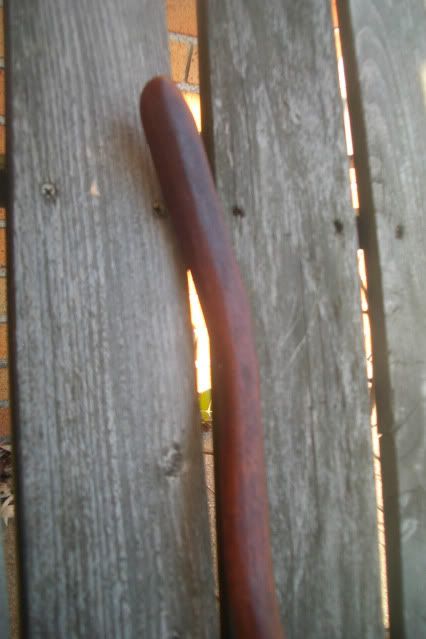

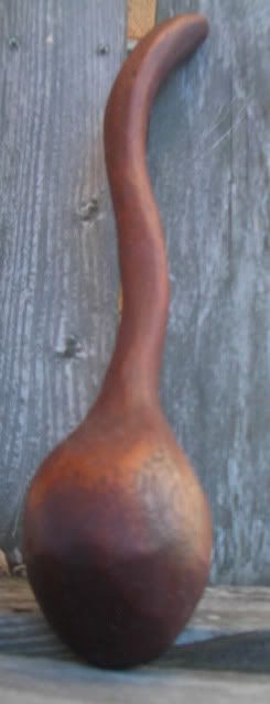

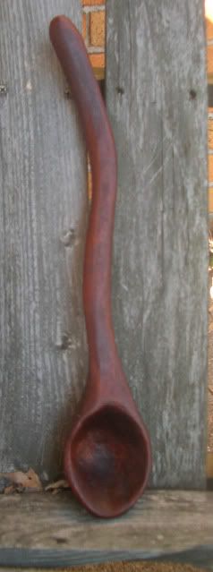

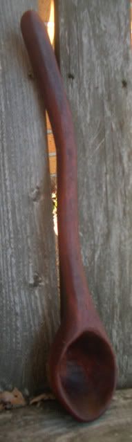

about 3 or 4 years ago I made a run of mahogany spoons for relatives as Christmas gifts.
Gave one to my wife and it is getting dried out. Today I put a generous coat of mineral oil. This is the result …
