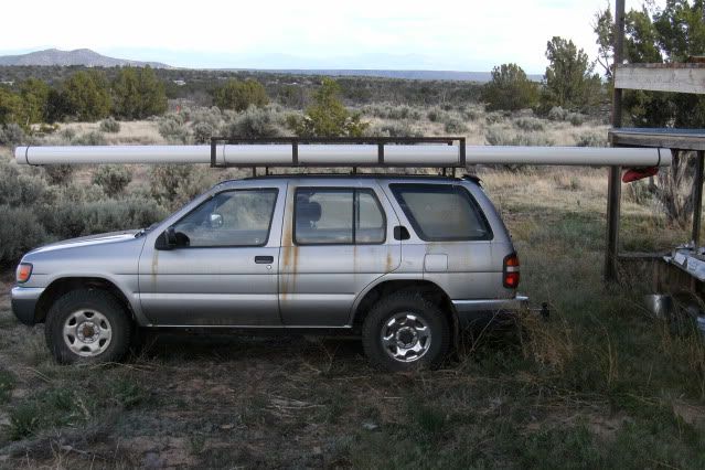

pipe on truck rack ,
backed to below porch
tied o rope to one end and lifted it and grabbed it and pulled it on to porch ,
these things are BIG and HEAVY ! slippery as sin too .

here how i did it jim ,by myself .

and here we have it !

i used 6" x 20' schedule 40 pvc pipe , and made this jig to cut 1/4 of the pipes out to do the curl and attached it to the roof with arms from the rafter ends .
not finished , just beginning , i need 8 pipes altogether , i have 3 right now ,
the jig must last at least a year i figure , until i can buy more pipe .
now i could shower , wash clothes and dishes , and cook .

all the gutters i have ever used are garbage , they clog with leaves , (i don't have any deciduous ones) ,or the snow rides right over them and falls in back breaking clumps , not much good , just cute in mild rain .
