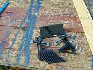

Be careful when cutting Dados!!
I have done it hundreds of times-making repetitive cuts on table saw-and I am sure you have too. But NEVER get complacent using a table saw!
There I was cutting a doado in a length of soft cedar, guiding it on past the blades, when it bound up and shot back! When it did, it not only broke my newer fetherboard, propeled the board back into my truck tailgate, but it also drew the push block-with my hand-back over the spinning dado blade.
Here is the board.
I was using a featherboard to keep board against fence and using a pushblock to apply pressure as it went over the dado blades. I was at the end iof the board and I hesitated just a moment, trying to figure a way to keep the board from falling down to the dirt when all hell broke loose. The board flung back and I thought I felt it hitting my little finger on my left hand. I was noy until I was picking up the pieces of my broken featherboard that I noticed blood on the ground. I looked at my finger and it did not look good!
Here's what my finger looked like at the site:
Here are the new featherboard and the push board. (Note groove in push board. This is what gave me the first inkling that the blade, not the board had hit my finger.)

I still will cut al the daoes in the wood to fill a project I contrated for, but I will make me a "safer" push block, sorta like the medievel sword shields, and keep my hands in front of the blades whenever I cut dadoes!

As far as outfeed tables go, I am using a "portable" table saw in my dirt driveway. I need to make a portable outfeed table or just learn to drop it in the dirt.
Upon further reflection I think I made three major mistakes in my cutting.
1) I had a beveled edge at the end of my cut (see picture). That allowed the board to 'rotate' off the fence and bind on the blade. It should have been on the leading edge, then I would not have to worry about rotating the board with my push stick.
2) I had the featherboard in FRONT of the blade, like I would rip cut. This position is crucial when ripping to prevent board from getting pinched and binding on blade, but with dadoes, I am thinking it should have been directly opposite the blade, preventing any rotation of the board.
3) Keep my hands BEHIND the blade. This injury happened because I had my hand behind the blade feeding board through. I should have used my push stick that extends in front of the hand.
Another potential problem I had was that I had gotten too complacent with cutting dadoes and I was doing a smal-scale mass production of domino holders. When you have a 1/2" stacked dado, there is a LOT of mass spinning on that arbor! A lot of orportunity for disaster.
NEVER GET COMPLACENT WITH POWER TOOLS!

Thanks, Partridge. I was using a good push stick, just not the best one to use with dadoes. I stood off to the side, too, but I did not have an outfeed table. (It is on the top priority on my next shop project, though!)
