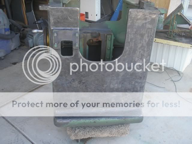

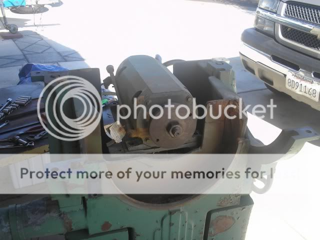

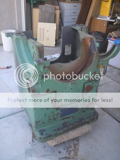

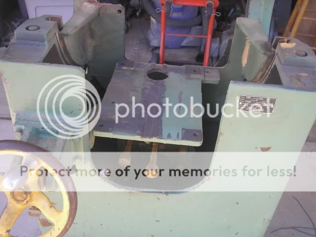

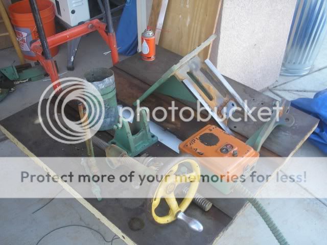

As some of you know I recently acquired an Oliver 232 table saw. The saw was built sometime between Feb and Sept 1953. It is 3hp 3ph and weighs in around 1200#. It was purchased through a local auction for the sum of $125.
Today I began with the disassembly and cleaning. I removed the table, 200# gone right there. Luckily my weight lifting neighbor was home and gave me a hand removing it. After the top was off I began removing the motor, motor raising mechanism. The motor sits on a plate that is raised with a pinon gear and shaft, it is aligned with dovetailed ways. Its a nice assembly. Here she is with her top off.
The motor came out next, about 100# gone there. It was set on the bench for later cleaning and bearing replacement.
The table with most of the internal parts.
Next came a light wire brushing with a knotted brush on a 4" grinder. It made fairly quick work of removing the paint and rust. I did one side and called it a day.
Tomorrow, hopefully, I will get a cherry picker lift to remove the trunnion asembly. My guess is it is somewhere around 250-300#.

Sanding, filler and motor tear down
I have been working feverishly on this saw. I have spent quite a few hours wire brushing the castings getting ready for paint. After the majority of the paint and old filler was removed I had to borrow a lift to get the trunnion casting removed. It weighs about 100# and not wanting to injury an already sore back I felt it was safer.
I have applied 2 coats of filler and am ready to do the final sanding. Here she is as of today.
The motor came apart fairly easily. I am replacing all the bearings in the machine. Even though it appears the motor bearings were replaced at some point I do not know the history of the saw and being that the motor is out and the saw apart to me its cheap insurance.
Removing the arbor half did make me pucker a little. Last thing I wanted to do was bend or crack it. But it came off without having to place a wrench on the puller. I screwed it in by hand and off it came.
I removed the key and went after the front cover.
Then came time to remove the front cover and rotor. Slid out without an issue
More puckering
All done. New bearings have been ordered and should be here in a few days. Will update soon as I start painting!!
