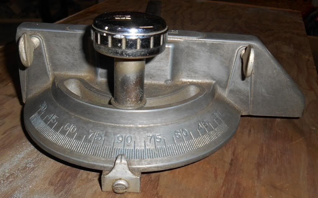

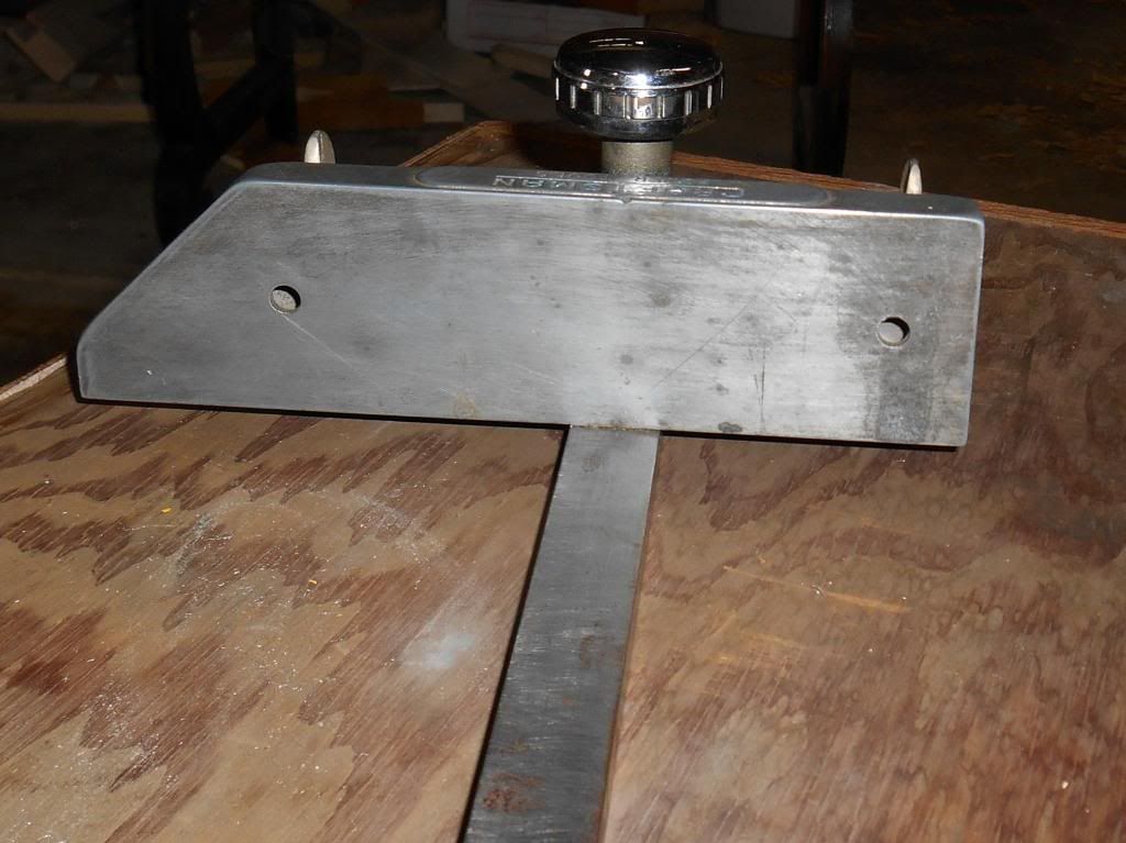

Anyways, I'm having trouble attaching wood to the miter gauge. There are two holes for doing this but they don't go all the way through. There's the hole and then about 1/3" gap, and that's it. How am I supposed to get a bolt and nut on it? I wanted to avoid drilling the holes all the way through and, even if I did, the other side of the miter gauge is curved. Has anyone ever modified these old miter gauges or have any ideas of how to work with this?

And here's the close ups of the miter gauge:

There's two ways to go about it.
1. Carefully measure and drill holes in your board. Countersink the heads to be flush with the board. Then measure what length bolts you need to extend just into the holes. Use a box end wrench to hold the nuts from underneath while you thread the bolts in.
Or…....
2. (What I done) carefully drill the hole the rest of the way through so you can use long bolts that go all the way through.

Yeah, option 2 sounds best. I love my old tools and do my best not to change/ruin them. I thought if I ever get an after market fence system, all the new holes to fit it are going on the rails and not the old saw.
I attach my sacrificial fence to my miter gauge using T bolts in a milled T Slot in the sacrificial board. I wouldn't hesitate to drill a couple of 1/4" holes through your miter gauge.
Andy's idea would work too if you have a ratchet wrench to tighten the nut. I'm not sure there's enough room in there to work a regular wrench.

I drilled the holes.

To attach a wooden extension to the miter gauge, I'd drill the holes through, then tap them. No need for nuts on the other end. If they are 1/4" holes, you might want to bore them out just a tad bigger, then tap with a 5/16-18 tap. The miter gauge looks like aluminum or pot metal. Should tap okay.
Actually, with a hardwood extension, you could do it the opposite way: drill 3/16" or slightly larger holes in the wood, tap the holes to 1/4-20, and use short machine screws.
