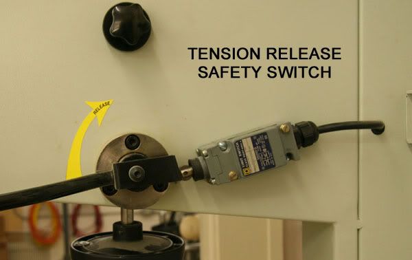

Tension Release: I like the quick release for the blade tension on this saw. I added a limit switch so the saw can't start until you tension the blade. I have a tension release on my Delta saw and half the time I start the saw and forget that the tension leaver is released. The limit switch installation on the Lagona was fairly simple.

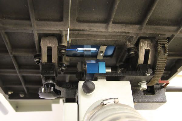

Blade Guides: This saw has Lagona Guides. Some people love these but the verdict is still out with me. The lower guides are mounted much closer to the underside of the table than other bandsaws I considered. I think this is a plus. The Lagona guides on my saw have a plastic head on the lock screws, one of which has slipped on the screw head so you couldn't loosen the guide. I used epoxy to secure it, but it may need to be replaceed.

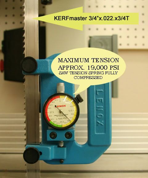

I first noticed that I had to wind the tension nearly all the way to get what I considered correct tension on the 5/8" blade using one or more of the methods mentioned above. Since the factory tension indicator on this saw is not calibrated, I decided to mark it for various blade sizes by use of a blade tension meter. There is an interesting video on YouTube about calibrating a bandsaw tension scale, Using the Bandsaw Blade Tension Gauge available online.
I installed the blade tension meter on several blades. The photo below shows it on a KERFMaster 3/4" x .022×3/4T blade from Spectrum Supply. With this blade the tension is maxed out (tension spring fully compressed) at approximately 19,000 PSI. I expected to get this tension closer to the middle of the tension scale.

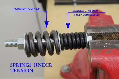

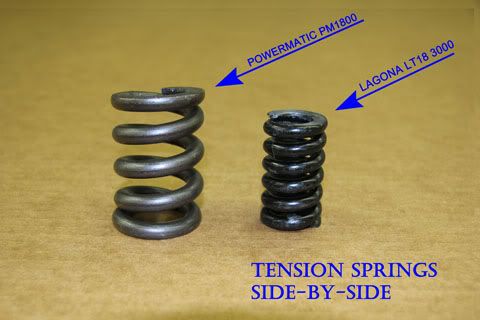

I also want to share with you my comparison of the tension spring from my saw with a spring from another manufacturer's 18" saw. The photo below shows the spring from the Lagona LT18 3000 side-by-side with the tension spring from a Powermatic PM1800 (both 18" saws).
The next photo shows the two springs, end-to-end under compression. The Lagona spring is fully compressed as it would be when the saw scale is at max.
