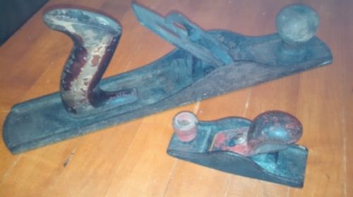

Hi everyone! Like the title says, I am interested in any and all info you have on these two hand planes. They are pretty beat up as you can see in the pictures but I am going to try my hand at restoration. I figure for the $15 I spent on them, I don't have much to lose. They both have some surface rust but they are not badly pitted.
I am pretty new to hand tools so please correct me if I incorrectly use any terminology. The bigger one (a jack plane?) is 2-5/16 wide by 13-7/8 long. And the small one (just a block plane?) is 4-1/2 long by 1-1/2 wide.
The tote on the bigger one is secure but it is cracked and the rear handle is pretty loose and has a little damage as well. Would you try to repair them or replace them? I could not find any markings on it other than "Made in USA" across the front of the plane so I do not know the manufacturer.
If anyone could identify a manufacturer or could point out anything of interest I would appreciate it. Also if you have any links to good tool restoration info or inexpensive replacement tote/handles that would also be great.

The Jack plane looks like it was a Stanley Defiance, based on the cast into the base frog. No lateral as these didn't have any.
The little guy looks like a cross between a #110 and a #101. "Thumb plane". Clean it up sharpen it, and keep it in the work apron.
The Jack? A Jack is a jack plane. Clean it up, sharpen the cutter with a 5-8" radius curve to the edge. Called a Camber. It is a way to take the rough out of rough sawn boards. Might stay on the lookout for a #3 or #4 sized smooth plane, next.
DonW has a few blogs on how to repair cracked handles.
nhplaneparts.com (EBay Store) sells replacement handles and other parts. That Defiance has a special lever cap, and only fits a Defiance plane. This would be the "Type 1" planes, the later ones were just copies of "normal" Bailey style planes.

Thank you very much for the information! It definitely gives me a good direction to head in to find further info/parts for the planes.

Can we see some pictures of the adjustment. Although I agree it looks like a defiance, they didn't have adjusters. I'd like go see more detail.

Once everything was apart, the only other marking I could see was a faint "Made in USA" on the top edge of the iron. I have attached some better pictures. Thank you for your time and input.

I had to look that up. Its a defiance #1244. I've never seen one. I doubt it will be a great smoother, but probably an OK jack.

Thank you Don. It looks like the block plane is also a Stanley defiance or at least it looks very similar to some I found on eBay.
