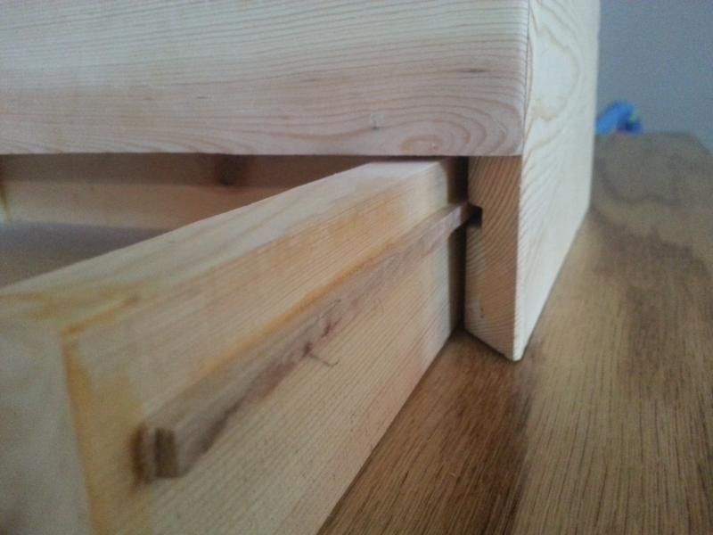

The real problem came with the drawer. I attached the mitered front with sliding dovetails and made hardwood runners for it to slide on. I'm not happy with either choice.
I don't think the dovetail bit I own will work with the thinner stock, which I plan to use and I don't have the skill to do it by hand.
The runners just don't work very well, even with careful measuring, lots of sanding, and wax. They stick and come out of the track when I try to replace the drawer.
I'm thinking I will skip the runners and include 1/4 inch plywood partitions for the drawers to run on. I also, think it might be better to build the drawer boxes as separate pieces and then attach the mitered drawer fronts.
Is there another better solution that I'm missing for the drawers? How would you tackle them?
If I do attach the fronts to separate drawer boxes, what is the best way? It won't be very heavy duty, so I assume I could just glue them. How do I align them correctly if I take this approach? Double sided tape and trial and error?
Would really appreciate any thoughts or ideas.

For such a light drawer, why would you need runners.
Wood Cabinetry Wood stain Floor Flooring
Brown Cabinetry Dresser Drawer Chest of drawers
The jewelry chest I made my wife has 3/8" web frames between the drawers. I cut the drawers so the sides were only slightly smaller than the opening height. Also, the width of the drawers were hand planed to fit a little less than snug. These drawers slide in and out easily with very little side to side movement, and when pulled almost all the way out the sides are tall enough that the drawer does not tip down. The drawer face was planed slightly on the bottom for a very small reveal when pushed all the way in.
As the drawer you are making will not carry much weight, you might give a thought to not having drawer runners.
Just a thought.
