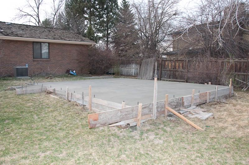

Then they poured the slab.

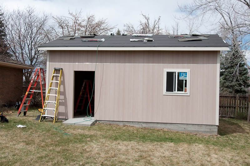

A week later Tuff Shed showed up at 7:30 in the morning and started putting up the workshop. First they erected the prebuilt walls.
Then they put up the roof trusses.
And the roof.
At 4:30 that afternoon they were done!

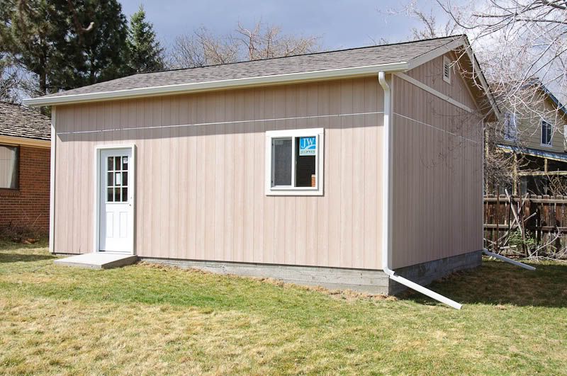

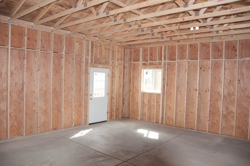

Here is the interior.
And painted to match the house.

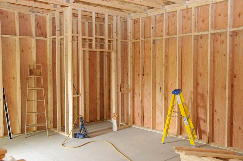

I decided that I needed a closet for the dust collector and air compressor. Both can be noisey and I wanted to mute that noise. So, I framed a closet and will put in an insulated, exterior door. I also will have sound absorbing insulation in the closet walls.

I decided on a standard 3' wide door.
Three reasons:
I measured all of my machines and they are all less than 3' wide. The widest is my Delta Unisaw.
Second, anything I make has to fit through the door into my house and that is also a standard 3'door.
Finally, my goal is to have a well insulated shop to minimize my heating and AC costs. An insulated exterior door does that.

Remember a couple of things about that closet.
1. With you dust collector in there you will need an exit hole for the air to get out. This is what I did: HERE
2. With the DC and compressor in the same room the compressor can get clogged up with dust from the DC. No matter how good the DC is there will still be dust.
Good luck
