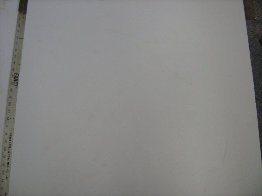

We start with a piece of melamine that's is approximately 32"x32"
next I take a straight edge and make lines corner to corner and then lines from the half way mark forming an X across the center of our melamine. Now I take a measurement half way between the other marks and draw a line between them.
Mistake… I was in a hurry and got my lines off so I did not have equal spacing.
When done with this step you should have 16 equal spaces.

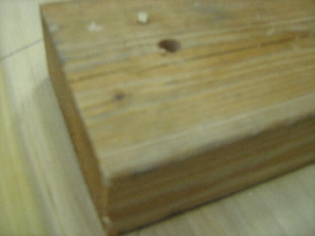

Now I carefully drill a hole in the dead center of all the lines running through all the lines. It is important to have this hole parallel . So I took a piece of 2×4 and drilled a hole in the center to use as a drill guide.
Just barely drill a starter hole and then use the guide to drill no further than 7/16" deep
