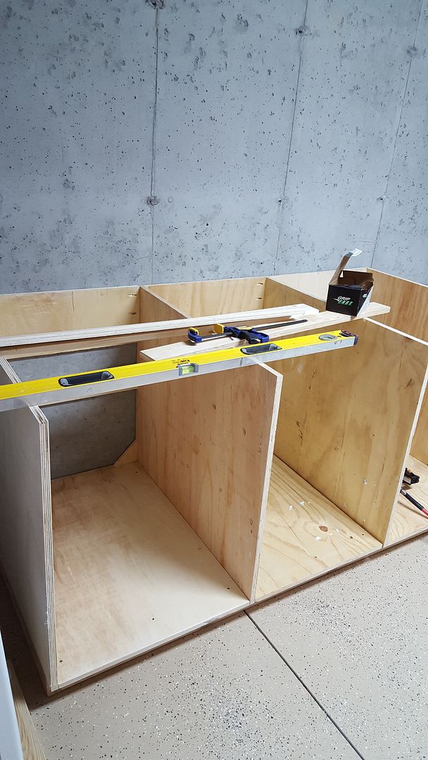

I worked some more on it.
Top support board is for the top
Bottom/middle board will support the full plywood shelf.
One shelf in each box/hole

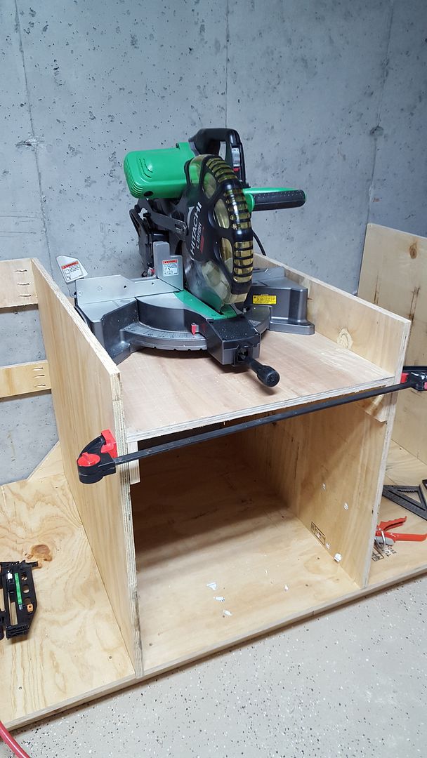

I did not screw of glue to saw portion yet.
But something I did not think about is the swing of the saw.
If I mount towards the center of the table, then I cannot swing it 45 degrees.
2
If I have it pulled forward it works fine, but the handle would stick out for storage.
So I think I will make a stop block and slide the saw up to the block when I want to use it.
Then slide back when I am done for the day.
Or I cut handle clearance in the sides? But that does not seem like a good idea.
just butt screw the sides into the bottom like standard cab construction.
It looks like you can just pull the saw forward and have clearance, but if you plan on upgrading to a slider with more depth of cut you may not be able to do that.
You can also have your saw shelf flush with the bench top and just make some supports to hold your lumber as you cut it.
I thought about the supports ontop of the cabinet, Not sure I want to do that.
I like the idea of sliding the saw forward to a fixed stop.
I have about 1" of clearance I need to shim to make it level with the future top.
I don't see myself ever getting a sliding saw, and if I did it would be that compact bosch.
The bench is 36" deep.
