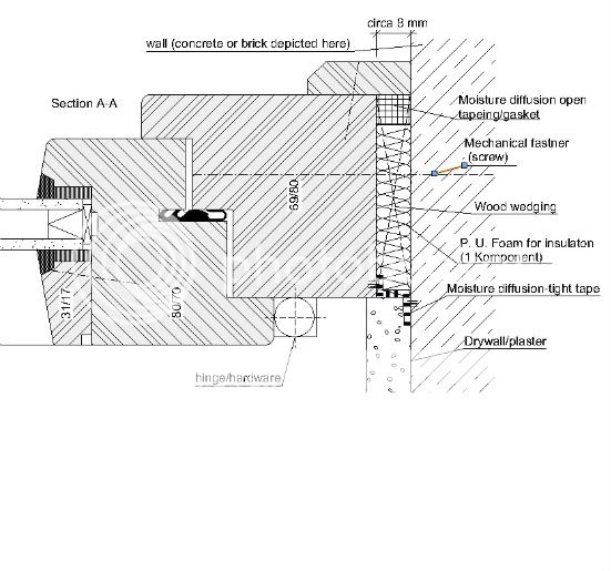

Hey guys this fits exactly in with this topic, We here in germany are still building our own windows, (eventhough in newer buildings this is getting less and less due to industry) and doors because of the very old houses and irregular sizes. We also have strict (but good) regulations to build the windows and doors by because of enviromenal and structural reasons… well anyway, here is a pretty good/standard insulation glas drawing that I made quick on the PC to illustrate how it should be done…
So I hope this is helpfull
If anyone is interested on how we make the frame to window opening fastening, I can also provide a drawing for that too, and its allowed to be used on the Green friendly or green passport houses. Its a pretty interesting topic…
Hi Nicholas, Thanks very much for the cross-section drawing. I would like to take you up on your offer to provide the frame drawing also. From what you have provided so far, it appears that, should the glass ever need replacing you would pry off the molding where is says 31/17. Once the molding is removed (all around) you push out the broken glazing from the outside towards the inside. Is that correct? How many holes do you drill for air circulation? I suppose 1 is enough. Is this mainly to allow air movement as the glass (or window frame) expands/contracts? And what is 'geriffelte lei"? This appears to be a cross section of the bottom of the window, the horizontal part. Are the verticals the same cross-section? Sorry for all the questions! Thanks again for positing.
Steve, thanks for your contribution also. The best comment you made is, start with the hardware and build around that. I totally agree. I am too busy right now but on the weekend I'll post some more hardware links and try to find some pictures of some nice window examples.

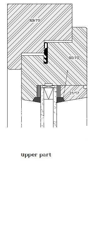

CatiaMan, not a problem for the drawing… I took the liberty to make some generalizations, every window is a bit different, in thickness and size and kind of glass, depending on the style, quality and R value that you trying to reach…. Just so you know.
I drew a standard (what is built in in most houses these days) outside window with frame. The lower part (thepart which must fight off the water and precipitation) has on the one I drew up for you, an aluminium profile to keep water out, but can be built with out, if you make sure that the upper ledge of the lower frame has a slight grade (about 10°) to keep water out, and running down. all corners on the outside MUST be rounded slightly with about a 3 mm radius. This insures that what ever you are using for surfacing (paint, lack/varnish, lasuer, whatever) maintains a constant thickness to protect the wood, (on a sharp corner or too small of a radius, cant manage the corner, and thins in this spot making it vulnrable (spelling?) and of outside you do not want that). Also keep in mind that UV rays are damaging over time as well so that over time too.
Here is the lower part
here is the upper part:
You will notice I did not put many measurements in (except for the general frame sizes), thats because it really all depends on the kind of hardware you are using.
The rubber gasket/weather seal is also a generalization, because even here there are a thousand different kinds depending on what you are doing and quality, the one i used in the drawing is very common.
But overall I can say definetly this is a good general example of how windows are done here, this of course is a simpler version, there are more variants, all depending on how thick your walls are and how much noise you want to keep out and warmth in.
Before I forget, on the drawing, what you were asking about, is Geriffelteleiste, and I mean by that the wood strip that is holding the windowpane in, is not solid, but riffled (like a potatoe chip) so moisture can circulate within the Rabbit that window sits.
Holes for drainage, well, 3 ought to do the trick. maybe two, depends on the size of the window. remember air circulation is what will keep your window in shape for perhaps longer than you live, if built properly, so make sure the moisture that does happen to get in, can get out too.
The whole air circulation thing is not for movement, its to allow the dew buildup which happens mainly in winter, when cold (dryer) air meets the warm moist air from the inside (of your house) and they will meet somewhere usually in the middle of your window frame. That you can do nothing about, just provide an escape route for the moiture so your window does not form mold or rot, which is bad. We have all seen what happens to a cold beer bottle on a hot day, dew water or condensation builds up where the warm air and cold air meet.
Ok if you have any more questions feel free to ask…. I hope I have not bored anybody with such a long post. Especially if you are looking for good tips on installing the window or something.
Let me know what you think!

More great stuff! Thanks, Nicholas!
Is the part of the "Geriffelteleiste" that's riffled the edge by the glass, or the edge that's on the bottom of that rabbet?
Catia Man, I've been aware of the holes drilled for air circulation, and I always saw them as holes drilled so that the water could flow out of that channel that the glass was sitting in (because it's pointed up) if the seal on the outside ever failed. So there should be a bunch of those, maybe not as close as 2" separation, but 4" or so apart, I think.
Nicholas, is that about right? Except you'd think of it as about 100mm?
Dan,
Yes, I think you got it… The glass sits on a strip of wood with cuts in it so air can circulate… I dont know if you are familiar with this example but the best I can think of in a larger scaled is sometimes at a lumber yard between the large pieces of wood stacked up, there are strips of wood (sometimes plastic or alu) but they almost usually have "grooves cut in them" so that there is even less surface area covered by the strips so the moisture can escape from the stacked wood…. the principal is same for window (eventually doors too). You can buy them in standard sizes for the industry insulation made glass pains filled with the "heavy metal gasses"
You can make these strips/muntons your self just run them through the table saw at 45 degrees in one direction and flip it over and do the same again cutting groves in the stip…. The important thing is that the glass and NOT the plastic gap filler (the metal or plastic piece between the glass panes on the edges) is sitting on the strip,
Again Dan, you know what I am talking about :) yea! right on the money… these holes are for the serios condensation water to drain out… if you have standing water in the channel, you have a construction error made with the silicon
although, I think every 100 mm although meant well, over kill, maybe 150 mm or so perhaps a bit more!
Thanks everyone, Nicholas, thanks for the two cross sections. I think we need a 3rd to understand the design better. The upper section (lower picture) has no interlock to keep the glass frame from pushing inward. The lower section (upper picture) has an interlock created by the aluminum extrusion and the wood overlap however as soon as the window is opened an inch or two the interlock is gone and the window can push inward. So this tells me the vertical cross sections includes details to prevent this from happening. Just to be clear, I presume you are providing a window designed to open (please confirm)? There appears to be no provision for a bug screen, please correct me if I am wrong.

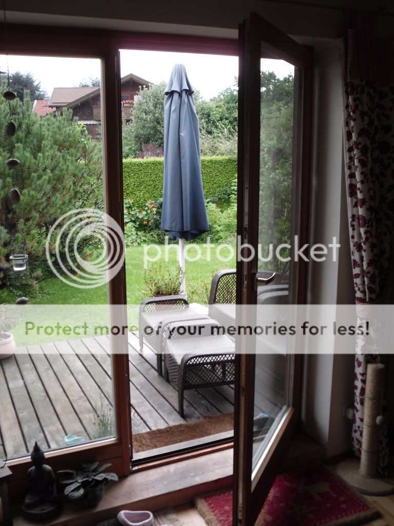

Last question first! :) Yes, The window is designed to be opened to the inside, like most windows here…. as I had mentioned earlier this is a very standard style window (average, mostly installed) in germany, perhaps all of central Europe, if I could go so far to say so.
Not only can you open the windows all the way, one can tilt just the top so it opens and lets fresh air in, by simply turning the handle in the up position one more 1/4 turn past the when the handle is in the open position
Bug screens are not really that common here… I guess we simply do not have enough mosquitos to keep out! ;-) But one can install a screen, or design a window to fit one, although, the easiest way to put in a bug screen is simply cut some screen to fit the window and on the inside of the outer rabbit, stick on a strip of velcro type tape (this actually comes in kits at every building market) and viola! Bug Screen installed. ( see posted pic)

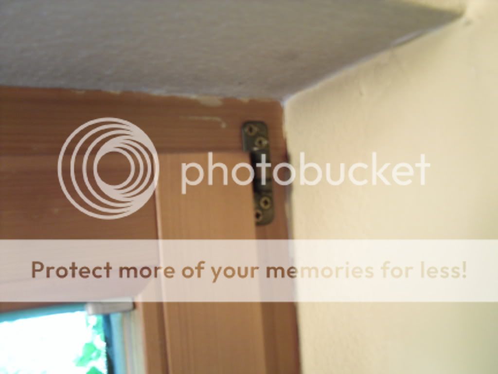

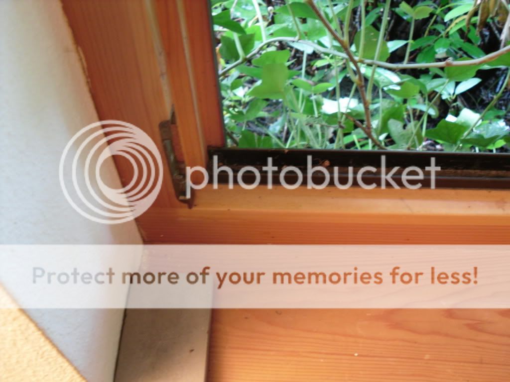

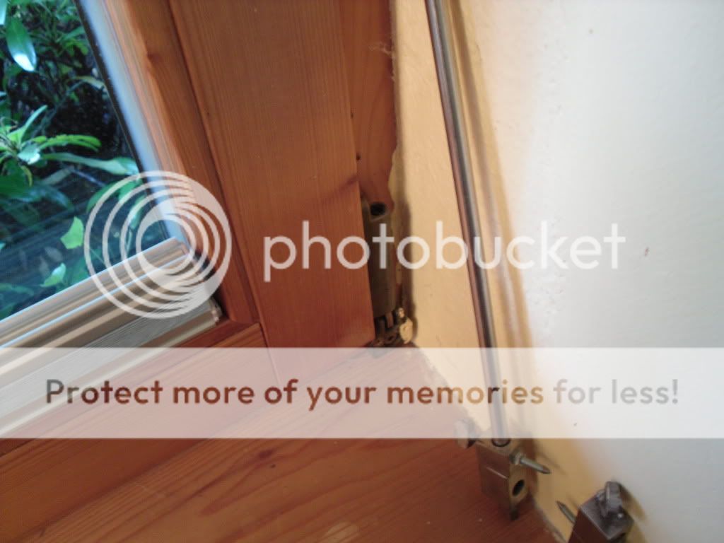

here are the hard ware pics:
Hardware from side and side profile
this specific hardwared comes in just about all possible sizes:
My patio door:
Ok I hope the questions were answered with what I posted, but the interlock part you mentioned is not so clear, could you try and please describe it again?
