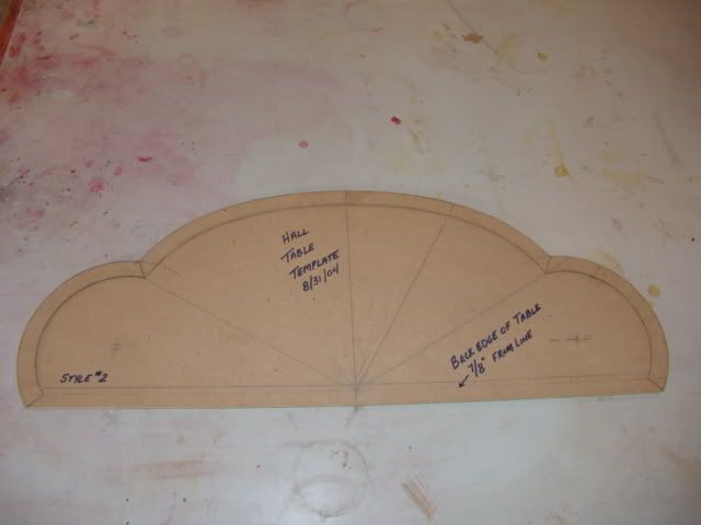

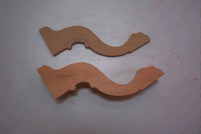

Whenever we do a project that has the potential to be built again, or if the design is somewhat difficult, we'll spend the time to build a jig. This is a process that pays back big dividends, and has been practiced for hundreds of years.
In the first instance, it makes sense to speed up the process of duplicating it. This prevents you from having to record all the dimensions and engineering that went into the piece. A very big time saver.
In the second instance, I would rather make a mistake on a piece of plexiglass or M.D.F., than on an expensive piece of wood. (wood doesn't grow on trees you know).
Mentally, it's easier to create a shape on a piece of plexiglass, or M.D.F., simply because it's "only a jig". Somehow, that seems to take the pressure off. Cutting the final piece can keep you from moving forward on a project, because you fear making a mistake. I know that sounds silly, but it's something I've witnessed, (and done), on many occasions. Jigs give you the confidence to move foward, knowing it's right.
It's much like seeing a person go from helper to mechanic over night. Same person, same knowledge and experience, just a new attitude. They just didn't realize, they had the talent and knowledge. It truly is amazing to watch a person's tranformation because they finally realized they knew how to do it. Now they're working with confidence, instead of fear. They stop second guessing themselves, which leads to less mistakes.
Once the jig is created, and it's perfect, making the final piece or duplicating it, is a breeze. The fear of mistake is eliminated in the jig making process. This is especially true when trying to duplicate something a couple years after the first one. The toughest part there, is remembering you have a jig for it, and where it is!
Jigs can be templates, or can be a method of holding the work piece to allow carving or machining.
Jigs designed to hold things can be altered to make the jig itself more useful. As the project progresses, new ideas come to mind, which brings about change to the jig. It's a case of building the project and the jig together, as you move forward.
If you're not already doing so, you should add jig and template making to your woodworking repertoire.

Hello Karson,
You bring up a good point which I failed to mention. On projects, such as the library stairs, all layout was done on a sheet of plywood, of M.D.F., which I used for determining the diamater of the post and overall unit.
I also made a pattern of the step, so I could use it for the steps, both in cutting it out, and in laying it out on the plywood.
I was able to determine the proper spacing, and angles on the steps. I actually screwed the post of that project to the plywood, so it was held verticaly. This enabled me to be certain I was laying it out right.
I often draw the full size patterns on 1/4" M.D.F. to take measurements from.
Another detail I didn't mention was the fact that the pattern can be attached with double stick tape..
Thanks for bringing up this important detail.
