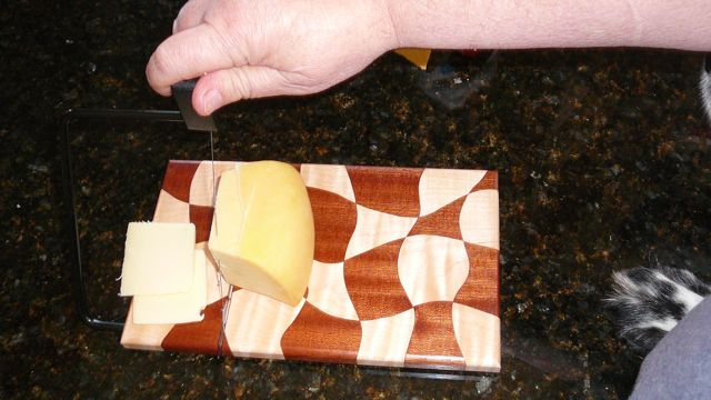

How to make a Wild 'n' Crazy two-tone board
Sometimes the finished project looks harder to make than it really is.
By request, here is a quick tutorial on making a two-tone pattern board.
All you need is a bandsaw… or maybe a scroll saw.
Start with two boards of contrasting woods squared and surfaced on all sides.
Use double-sided tape to align and stack them. (carpet tape works great)
Cut random curvy lines through both pieces on the bandsaw. This was my first test of the Carter Stabilizer - works great by the way - but I'm sure it could be done with any thin blade. The key is to be sure your saw table is flat and the blade is set to a perfect 90º. I'm looking forward to seeing if anyone (Sheila) attempts this with a scroll saw.
Your stack should look something like this.
Separate the pieces and put them back together again, alternating the woods. You may need to do a light sanding on the joints to get a perfect fit for your glue up. Glue and clamp them together.
Missing photo here, but once the glue is dry, stack and tape them together again, and do another round of curvy cuts. This time from the short side. Take them apart and alternate the pieces again and you'll end up with two cool boards that look like this.
Clean them up, put on a finish and turn it into your next fun and useful project to share with your friends… freckle-footed and otherwise. :)
There is no reason to stop with two woods. Try it with 3 or 4 or more layers and make several different multi-colored Wild 'n' Crazy boards at a time.
My blog for creating the cheese slicer is here .
SPalm's original cheese slicer project posting and instructions are here .
Check it out!
And have fun!!

Thanks, everyone! It really isn't a very difficult technique.
And thanks, MrsN, you reminded me that I meant write that you could use several layers of different woods to mix and match into different designs. I've added it to the tutorial.
Check it out!
And have fun!!

scrollgirl,
How thick of a board can you cut on your scroll saw? I can see no reason why you couldn't do this with wood slightly thicker than veneer and glue it up on a solid piece.
I use TiteBond III on all of my boards for its resistance to moisture.
As far as cleaning, wash with soap and water. No soaking and no dishwasher; the glue might hold up, but the wood won't.

Thanks, Mary Anne! I think you could go about an inch or so total depending on the wood or blade and they you would really be struggling and it won't be any fun. You would burn the heck out of blades no matter what on some wood.
I could probably make them half inch thick and they would be fine - especially if I put little feet on them.
Now you have me thinking . . . !
