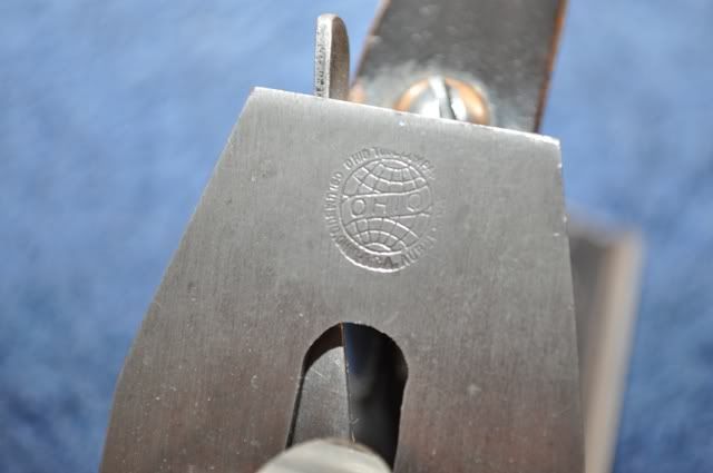

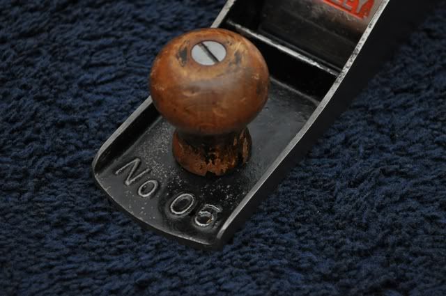

I recently got a "Stanley No 5 corrugated", after a close inspection I came up to the conclusion that its not an Stanley, due to several factors, (I hope to be wrong)
I took several photos for you to please help me identify this plane correctly, is it a good quality plane?, the blade says "Ohio" and the main body "No 05" and that's about it.
So if anyone knows anything about this plane I will appreciate your help a lot.
So what do you think, is it worth to keep it ?
Thanks
Alonso

I don't think I can really use that information since there's no Stanley marks other than the Lever Cap, and that its easy to switch it from another plane but hey, there's a lot of good information. What I see on this plane is this.
1) No brass screws for the knob of tote.
2) No screw adjuster behind the frog (last picture)
3) Cap iron is not the same width as the blade (picture no 8)
4) Lateral adjustment lever is not typical for stanley (at least not on the ones that I already own) (picture 9)
Today or tomorrow I should receive another Stanley No 5 corrugated I will compare them both and see what I can find

The 5 on a Stanley would be on the other end of the plane and it would be "No 5", not "No 05"
Bailey would be in the front. More then likely not a Stanley, sorry I can't tell who did make it.
If you bought it to use and it works, why not use it?
14,500 Posts
The main concern I would have from a user perspective is if the Frog is not able to mate with body of the plane correctly. The parts look to be of reasonable quality. Though it definately is a Frakenplane. Any chance the tote mod is to accomidate someone with large hands?
I agree with caseman, sharpen it up and try it out. Make your decision from there.
