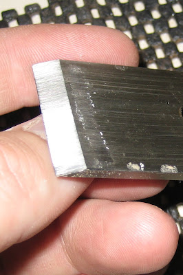

After dressing up the plane bodies it was time to move onto the blades. Here is an idea of what you will receive from Woodcraft sharpening…
Ewww gross. To their credit they do actually cut fair in this condition, but imo they are really not too sharp in this state.
The #4 received a Hock blade and cap iron. The Hock iron took a bit more work than I would have liked to get sharpened up initially. But the cap iron was beautiful right from the start. Actually just for s&g I placed both right into the plane and ran a couple of test cuts. They gave a similar cut to the sharpened factory setup. After a good sharpening of the Hock cut very nicely and remedied the chatter I was seeing in the cuts done with the factory blade. The combination of the nice Hock parts ($55 shipped at Craftsman Studio) and the tuned up plane body this smoother now lives up to its name and really can smooth hardwood. It still has some tearout on difficult grained walnut, but I have my doubts that any plane other than a scraper could deal with this board.
The low angle block got a full service sharpening. A few times over in fact. I got impatient the first couple of times and rushed to higher grit paper/stones before those deep factory marks were really gone. The state that this blade came from the factory is really a bit of work to get cleaned up. I ended up using a backer board, so I could apply more pressure at the courser grits. I went from 120g on granite to 220 on granite, 400g on cast iron, 4000g waterstone, and 6000 waterstone to flatten and polisth the back. The bevel was prepped on water stones (800,4000,6000), leaving the Woodcraft hollow grind.

My newest sweety
Once I started using scrapers I was caught with the bug. They are just so handy, but the drawback to card scrapers is that they can and do catch the second your focus wanders. So I started looking around for the typical scraper, the no.80. I had been watching e-bay for a few days when this 80M shows up.
Hmmm, what's that? Off to Blood & Gore for a quick ID. Apparently it is the ductile iron version of the scraper. Well, that could come in handy. The japaning looked good, but the sole was rusty and no picture of the blade. Seller claimed it to be a sweetheart, so I figured it was worth a gamble. Even at close it was less expensive than a new no.80 and much cheaper than the Veritas.
So it came in yesterday and I hit the net to find some information on sharpening and settings. I gave it a quick hone and was able to pull shavings (smaller shavings in first picture). But it was obvious that a bit more tuning and homework was necessary.
Today I got home and tackled it again, but armed with a bit more knowledge and familiarity with the intended settings. I flattened the sole, lapped the blade holder, flattened the casting where the blade rests, and took a bit more care and time to properly hone the blade. I was rewarded with fluffy shavings and a much more predictable scraper.
I haven't tried it with a burr. There is some debate as to the need for a burr. For now I figure that I will try it out w/o one. If I need to get more aggressive I will burr it.
A few more glamour shots of this Ol'gal. She did cleanup nice for being close to 90 years old.

My newest sweety
Cool… I love a good find. It cleaned up nicely- you'll get years of good use from it I'm sure…

My newest sweety
Great job of cleaning her up. You'll find lots of uses for that baby.
