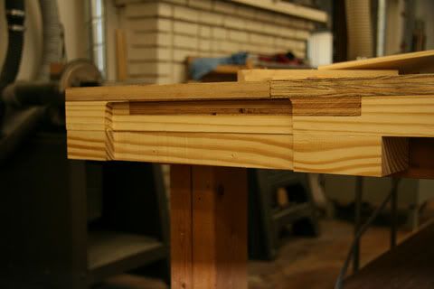

This is a heavy vice and my table was constructed out of simple plywood and construction framing so the first thing I had to do was reinforce the table and thicken up the top in the area of the vice. I then mortised out a portion of the edge of the table so the fixed jaw of the vice would be flush.
