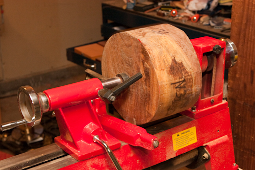

I don't have a bandsaw, so turning the square blanks yesterday was a real pain. Fortunately, these blanks were roughed into a circle, which really made a huge difference. I see a bandsaw acquisition in my near future.

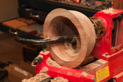

This lathe was very clearly not built for turning bowls of any size. This 8 7/8" blank barely fit over the bed (10" swing? Right…) More to the point, its still somewhat green, which made my poor little 1/2hp benchtop very unhappy. However, it did the job, amazingly. I managed to get it roughed out in fairly short order. Its amazing how much easier it is to turn green wood than it is fully dried.

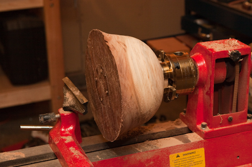

Outside roughed out, and onto my scroll chuck. I have some problems remounting the blank onto the chuck it seems. For some reason, I can't get it to turn on the previous center quite correctly. I've tested the chuck, no runout. I'm guessing either I'm not squaring the tenon shoulders quite right, or I'm leaving an uneven flat section on the tenon that's causing it to be a little skewed. Either way, this one wasn't quite as out of balance when it got remounted as the subsequent on I did (and didn't blog about, sorry).
And, rough turned to ~1" walls. I can see why people enjoy larger green blanks, working with the small 2" thick commercial blanks on my previous couple bowls was incredibly limiting. With decent blanks available on eBay and other places for not much more than the "exotic" and tiny blanks sold by Rockler and places like that, I can't see myself turning anything other than domestic hardwoods again.

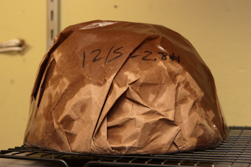

Wrapped up, dated, and labelled with its weight.

Jim: The bowls are completely covered in the alcohol bath for 4-12 hours, depending on thickness (I did about 6 for these). I have them in a home depot bucket with a gasketed lid to keep the alcohol from evaporating.
The outside and rim get wrapped in absorbant brown paper to keep them from drying too quickly, but the inside is left exposed. They get left upside down on a drying rack for airflow until the weight stops changing, or until they stop smelling like alcohol. (The weight method makes more sense to me).
No cracks so far, and they are definitely getting lighter, each dropped a few oz overnight.
