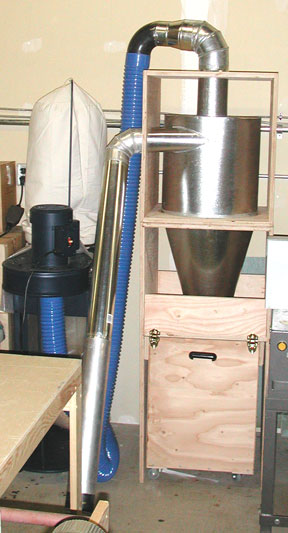

I'm curious why you didn't consider a stand alone cyclone separator?
It's possible that space is limited but in all honesty, they really work slick.
I made this one in a morning and elimnated the bag cleaning fiasco as nothing much gets by the cyclone.
